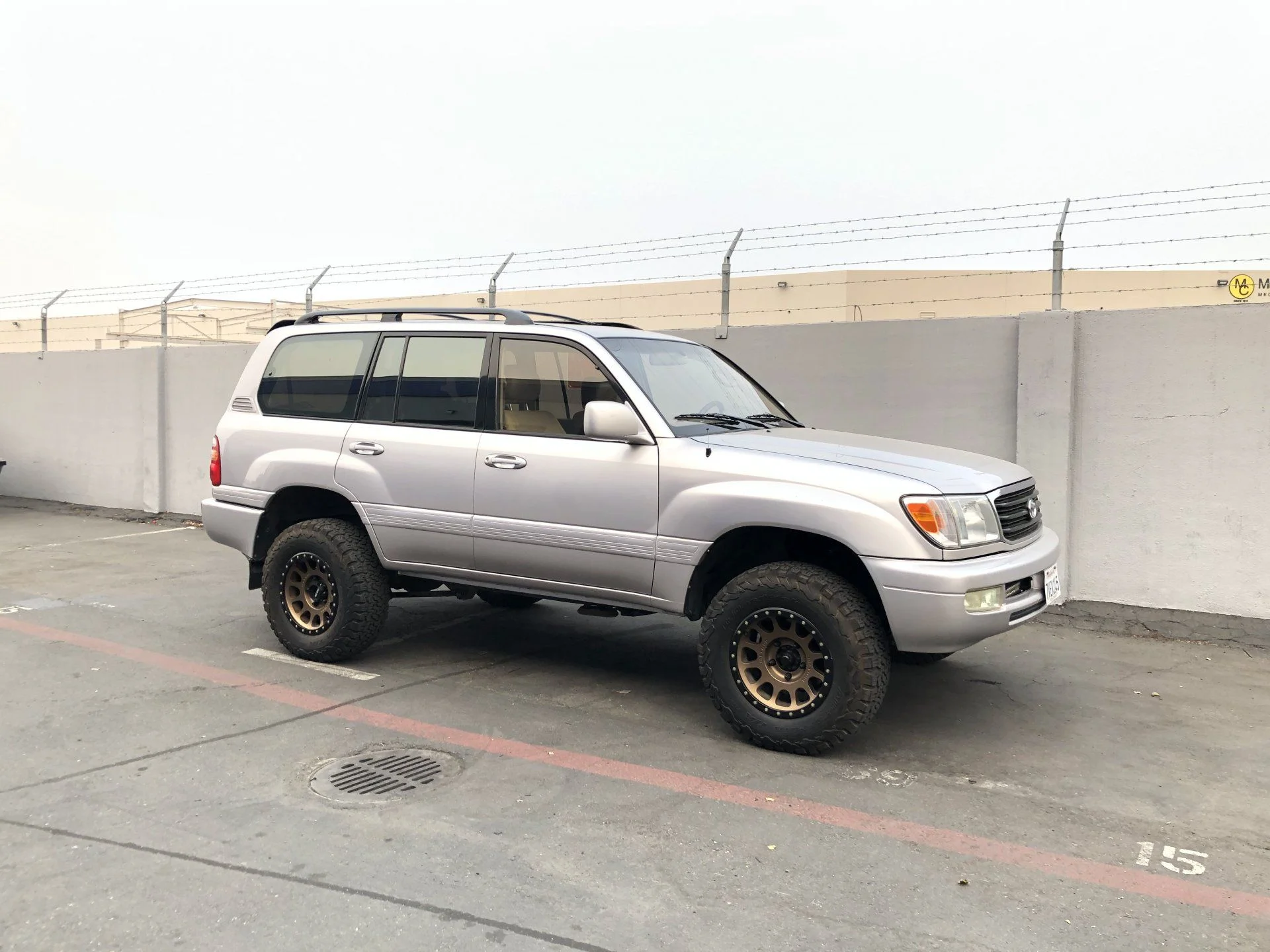

These are 1mm offset, installed prior to my ownership.
They look great just sitting there, but they rub on every part of the fender when stuffed. I suspect someday I'll get different wheels to make it stop.

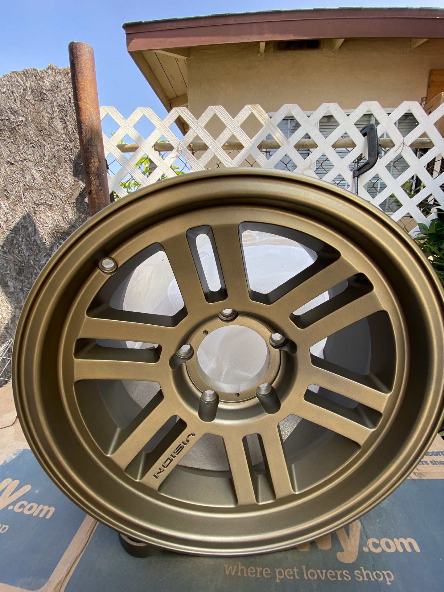

well ain’t she a beaut, thank you sir. i guess this shall do since they were only $400, they’ll be replaced down the road as well. nice to hear she was safe 🤣
I'd buy those at $400 for sure. Just verify that the hub diameter is large enough (>110.2mm I think?) so they fit. That's the thing that usually trips us up on wheel options.
Yes everything checked out until i seen the zero 0 offset and thats when i started searching online. Thanks !

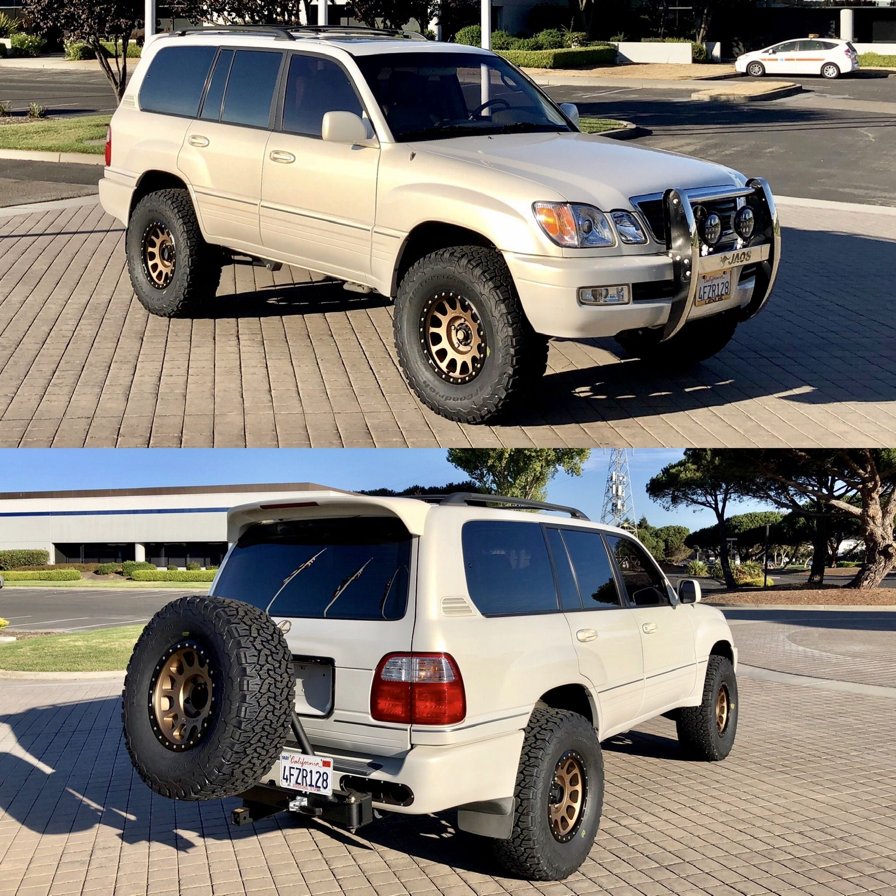

17x8.5 +0 offset Method 305 with 275/70/17.
Hey man, car looks great! How did you get the front end to not look like its pointing downwards? Rear looks normal height and front looks slightly lifted maybe? Also, any scrub with that tire wheel combo and if so, how hard is it to fix? I think this is what i'd like to do with my 100 series. Cheers!

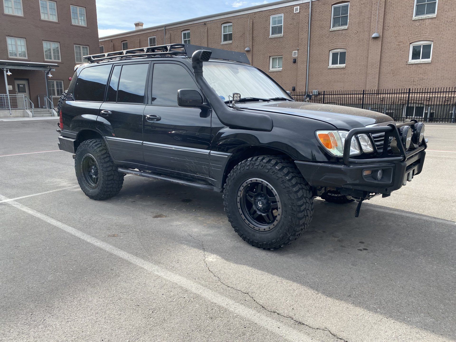

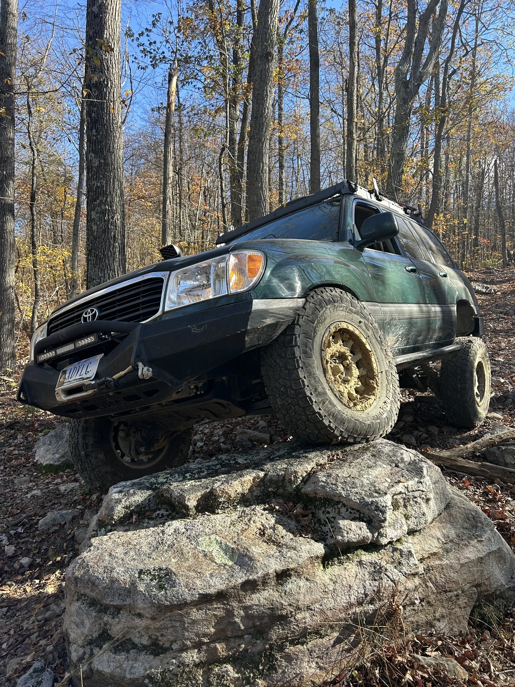

0 offset 17x8.5 methods. Had to do some trimming of the fender liner and pinch weld to fit 285/70/17 K02s fully articulated. Now on 35x11.5 and had to do a lot more pinch weld clearing and some fender mods and have crunched my fender once bc bumps stops weren't long enough. If you're staying under 35 0 offset won't cause too many issues with some pinch weld mods. That's a really good price though and could easily sell again for that.
