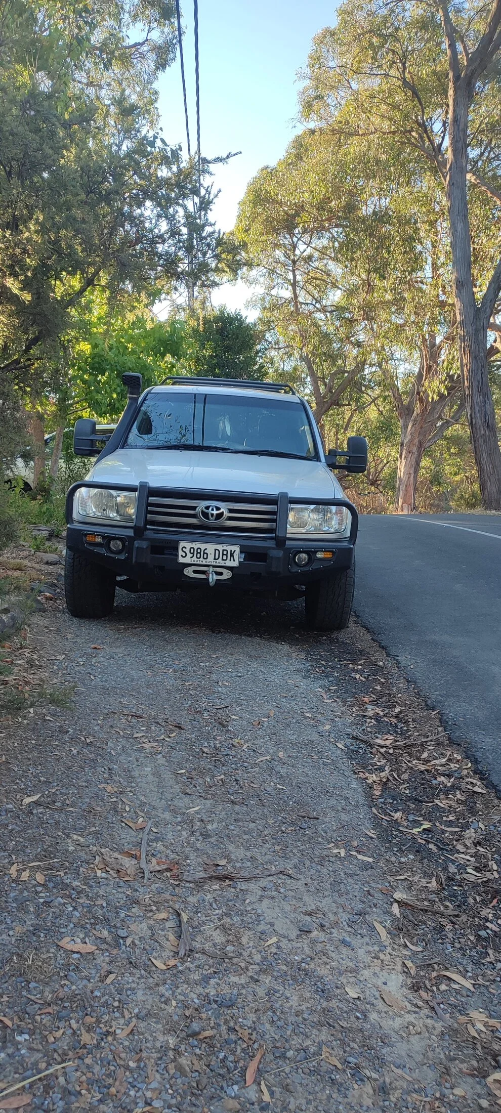

Anyone have a 100 Series with 0 offset wheels? if so pics please

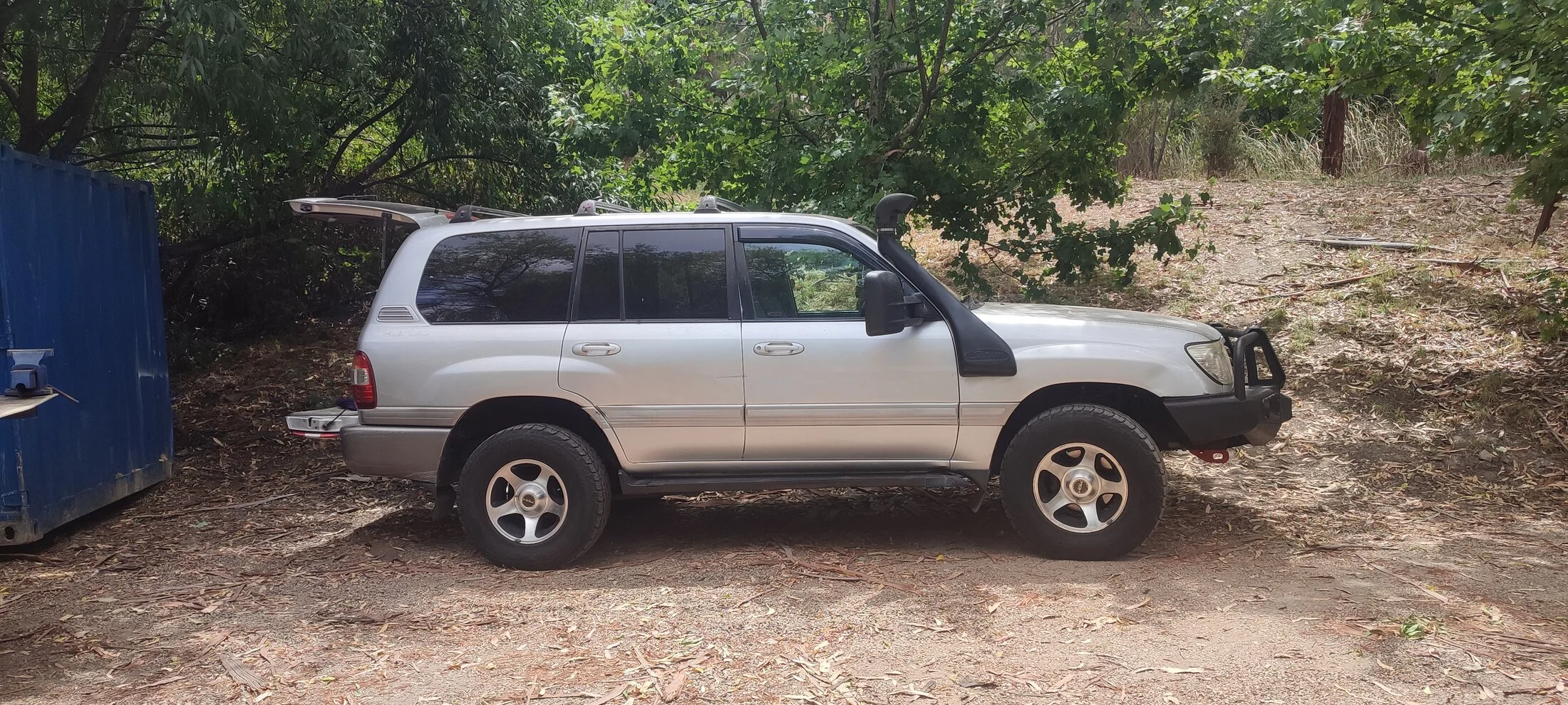

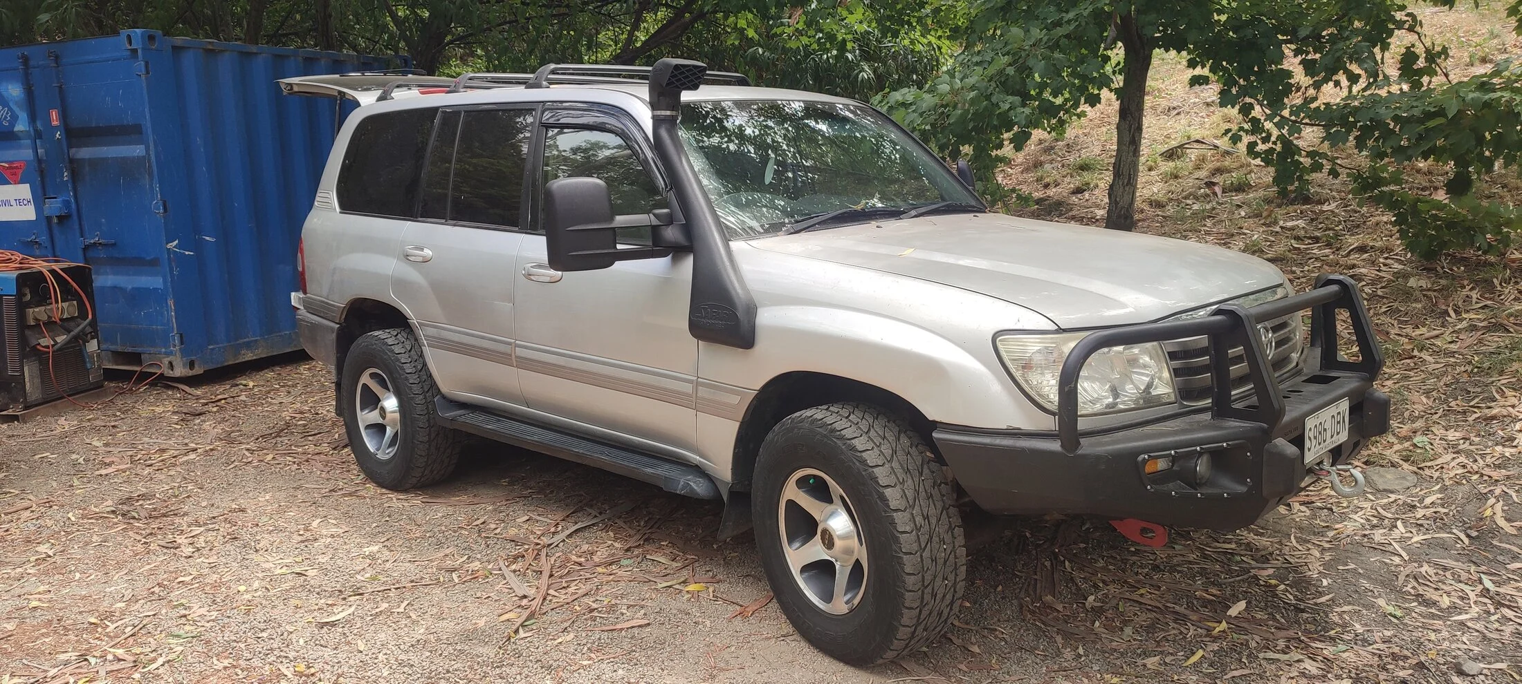

100 series with 105 series zero offset GXL Mags. 275/70/R16 tyres. Standard height. Aftermarket suspension (AHC removed). No rubbing yet except for a tiny bit when reversing and turning (say into a carpark). Happy with it so far.
0 offset 17x8.5 methods. Had to do some trimming of the fender liner and pinch weld to fit 285/70/17 K02s fully articulated. Now on 35x11.5 and had to do a lot more pinch weld clearing and some fender mods and have crunched my fender once bc bumps stops weren't long enough. If you're staying under 35 0 offset won't cause too many issues with some pinch weld mods. That's a really good price though and could easily sell again for that.

Running ome heavies in the back and icon 2.0 rear shocks (great affordable shocks with longer travel) dobinson extended shocks up front with dobinson ucas
