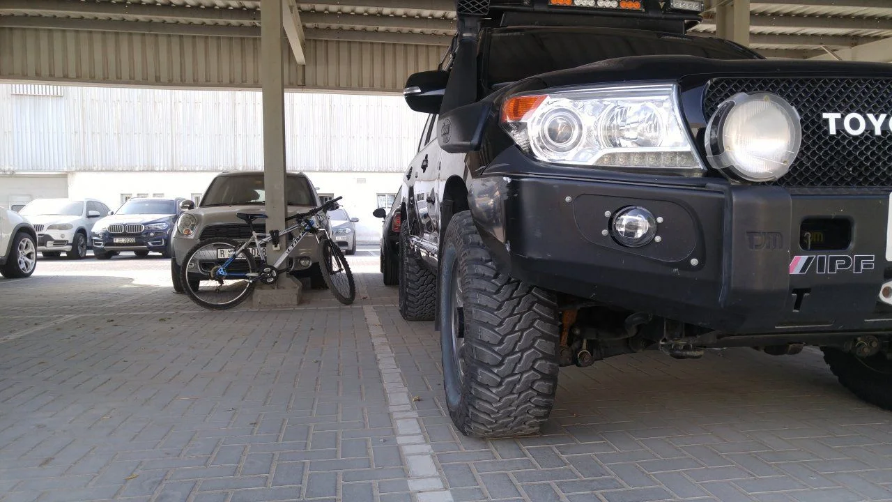

Curious whether the Toyo 305/70/17 AT2 is/was mounted on any of your rigs and if so, if there were any issues with fitment.
It's only a small bit wider than 285/75/17...which I know will fit...and basically the same height...
Anyone?

so many variables, my guess would be on stock wheels it would be all up on that UCA! depending on side tread, actual tire width, UCA's your running, actual tire height etc... Like Arich said, it's going to come down to wheel offset! I think the rock warriors have 10mm more offset than factory right? So take the 20mm, split it in half ya get 10mm on each side, in theory if you are running rock warriors it should be a wash?!?! But you've already done all of this math I'm sure, you're wanting to know if someone actually mounted these babies up to a rig or not!
All true... and ya...I've been crunching numbers.
The biggest problem is that the tire specs are almost always WILDLY off compared to actual size on the vehicle. I'm looking to go bigger, but close to an actual 34"... By manufacturer specs, there are lots available. The frustration is...their 33.9 ends up more like 32.5 in reality.
My one complaint about RW wheels is the offset. Really wish they were more like a 20mm rather than 50. Stock is 60, so it does help some, but not a lot. Would love to get a wider stance...and not thrilled about other wheels. Might go ahead and buy a second wheel set and try it...then either keep two different tire types available, or sell one or the other.

I've got 33x12.5 r17 which converted are a 318/64 r17 with 35mm spacers
Width is good for me but I still want more sidewall.. I guess only a 35 looks proportionate on a 200
I'm curious about your spacers.
Have you suffered any effects of spacers on your bearings, etc?
I'm tempted to try a set from Slee.
Anyone have a strong argument against spacer use? ;)

I haven't noticed any issues by running them, I went with the h&r as I knew I could trust their quality so far it's been on for 2.5yrs and 100,000kms
They need to be re-torqued after initial installation, I think it was something like 250-500kms.
