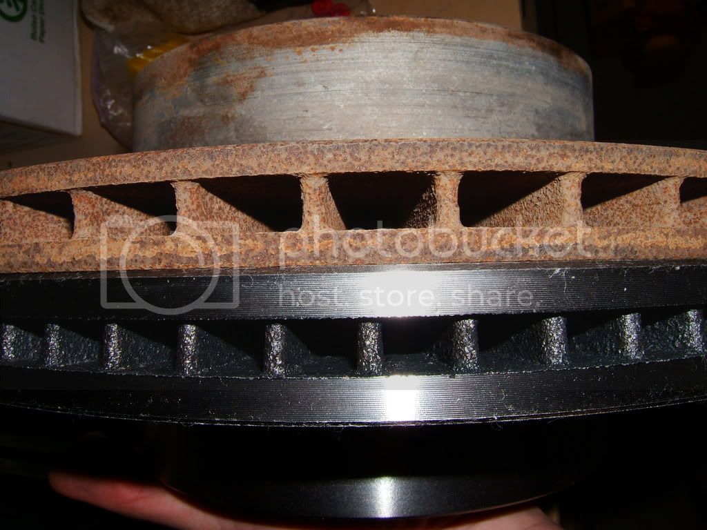

The tundra rotors are the same diameter as the IFS rotors for most 4runners. Tacomas and some 2wd or 4cyl 4runners had smaller brake rotors. The only difference between the tundra and regular IFS rotors is how thick they are. The calipers are identical except for the spacing. They bolt on the same mounts etc.
If you're buying all new parts, go tundra. No reason not to. I've done a swap from ifs to tundra myself on my 4runner and don't think it's worth the money if you already have the larger 4runner stuff. Here's a comparison.
The tundra/ifs rotors are a lot bigger than the tacomas and 15" wheeled 4runners:
You cannot put regular 15" wheels on either the regular IFS or tundra rotors. The 16" factory 4runner wheels fit over both.
