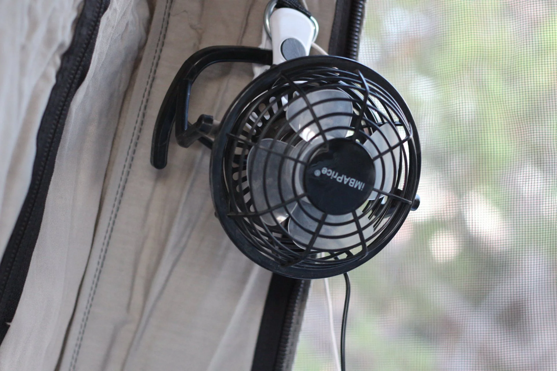

USB powered, very efficient, low cost, 100% plastic, and whisper quiet.

Ive got a kickass Caframo fan for regular fan duty, the problem is that without venting the tent, it just blows hot air on you.
I have this one below with the optional very strong clamp mount. The fan is well designed with no grill work to block airflow. The blade is made of soft plastic so it doesn't hurt if it hits a finger. And the clamp grabs the RTT pole with serious force and rubber pads.
Two speeds - Draw: 0.28 / 0.41 Amps, Airflow: 150 - 200 CFM
