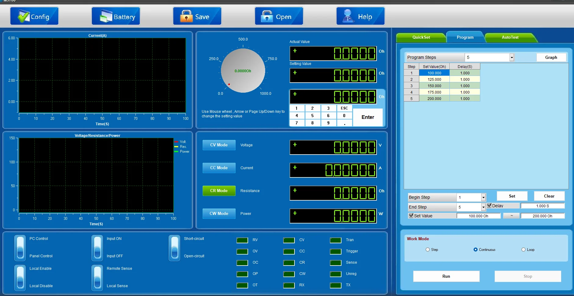

thanks George, will look at that brand. Not too worried about fast transients or LEDs, though. Do you know if some of those electronic loads can do semi-continuous scanning over ranges of current or apparent resistances well enough? I'm thinking about ways to generate IV curves for solar panels.
You can program steps in the various modes. Below shows Constant Resistance and changing the resistance values every second. It will log current, voltage, power etc so you can get curves. You can save the data and then pull it into excel for instance and do more with it.
I'm sure most electronic loads have similar features and new models like have fancier and more modern interfaces etc.
The Manyuo unit is surprisingly accurate, I see excellent correlation with my fluke 87III for voltage and current. The load also has sense connections allowing 4 wire operation - two that carry the load current and two that are the sense lines.

Every second is pretty good, that's nice (well assuming everything stabilizes within a second, that is). Good to know. Thanks. With solar panels, I'd indeed want to get the scan done fast enough that insolation changes with time are not much of a factor.
Yes, from what I've read, many of these electronic loads are very accurate with both current and voltage, the former being less obvious.
1 second was just an example. The fastest is 0.1 sec per change :)

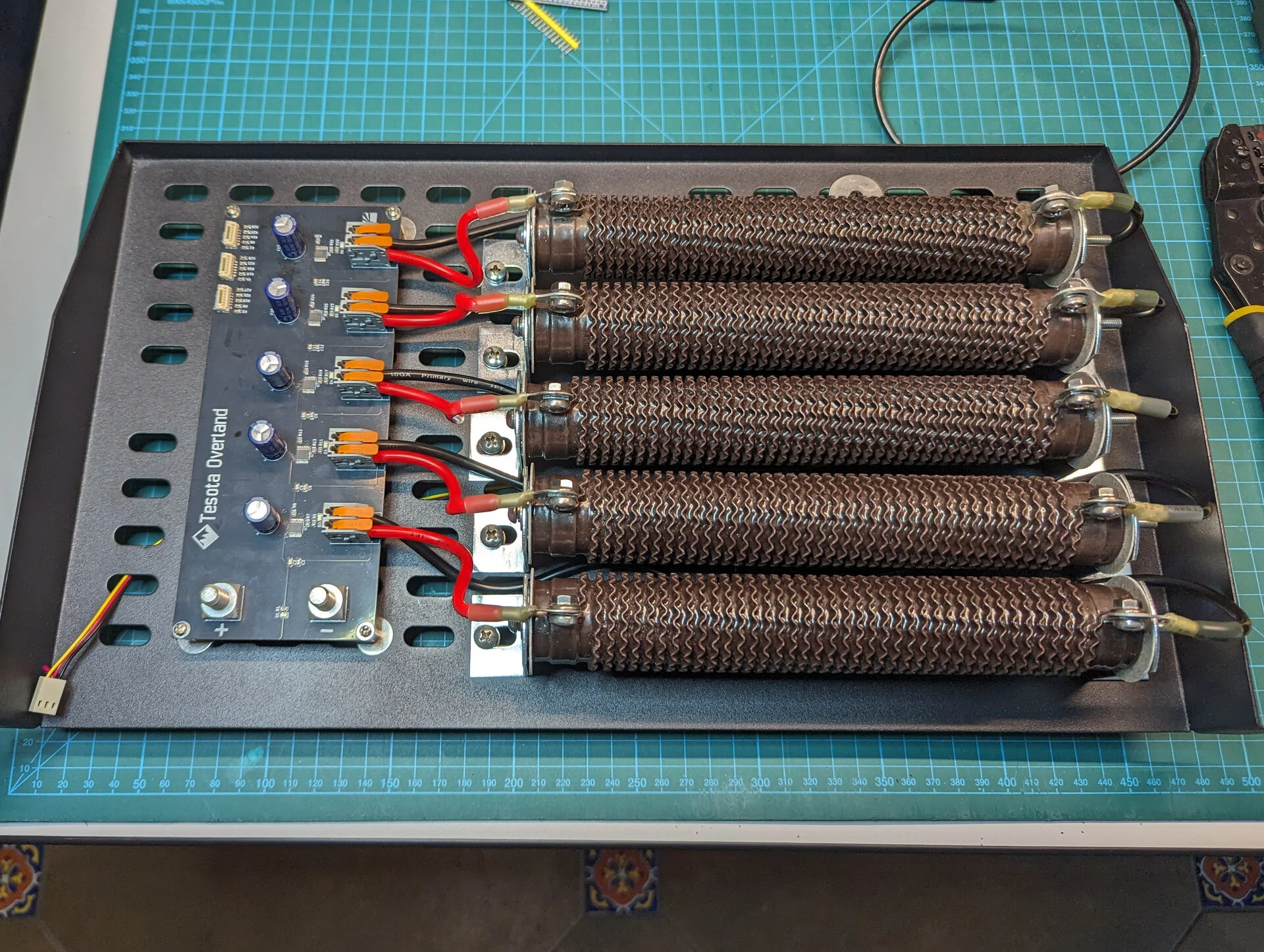

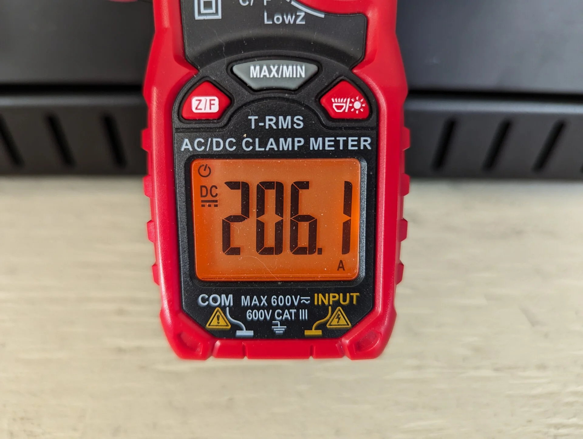

Most of the time I don't need all the fancy features of an electronic load, this was my quick and dirty solution since I only need to test a single voltage. The mosfets are controlled via an external uC and each of those resistors will draw about 20A @ 12V. Two of these will easily draw 200A and cost substantially less to build than an equivalent electronic load.
Nice! Doesn't that backing plate get awfully hot at full load?
