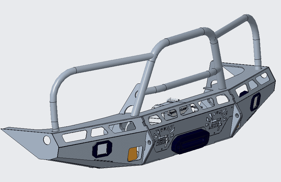

Anybody interested in a new front bumper design? Update 5/7, No more teasers!

Specs, hides a 12k winch, behind a removable TEQ inspection plate.
The plates are interlocking to reinforce the weld joints.
1/4' winch plate.
3/4" (2x3/8") shackle plates that are tied to the frame.
Without the tube work its right at 100#'s about 125 with tube work.
Protects the 96-97 AC drier.
At this time, you would be responsible for picking up the DIY kit or getting it shipped from Columbia SC (I can get it on a pallet)
You would need to source the tube work, I've got a local roll-cage guy lined up for mine.
Is there any interest?

A kit or a complete weldment?
Right now I'm going with kit. I'm not a fabricator, I'm a Machinist /ME.
If you want to drive out and spend the weekend, I could help you weld it.
If I get interest, I'll make sure to document the process.
The light cut outs are for Black oak lights.
These go in the wing as a surface mount:
Figure I'll go with Diffused as they are on an angle.
The lower light cut out near the winch is set up for this light:
I'm going to be installing amber fog lights, as its occasionally really foggy around here.
I haven't run the statics calculations on it. Its the right size for a small ditch light, though.
I may be interested, not sure I like all those cutouts though; is that to save weight? When will you finalize the design?
Can those light pod cutouts remain uncut? (The square ones in the front)
Yes it was for weight, but its not much. I just liked the look in the end.

I’m definitely curious. The cutouts turn me off because it seems like it might be a pain to clean and dig mud, roots, branches, or whatever out of those cutouts. Standing by for the quote. Thanks for doing this.

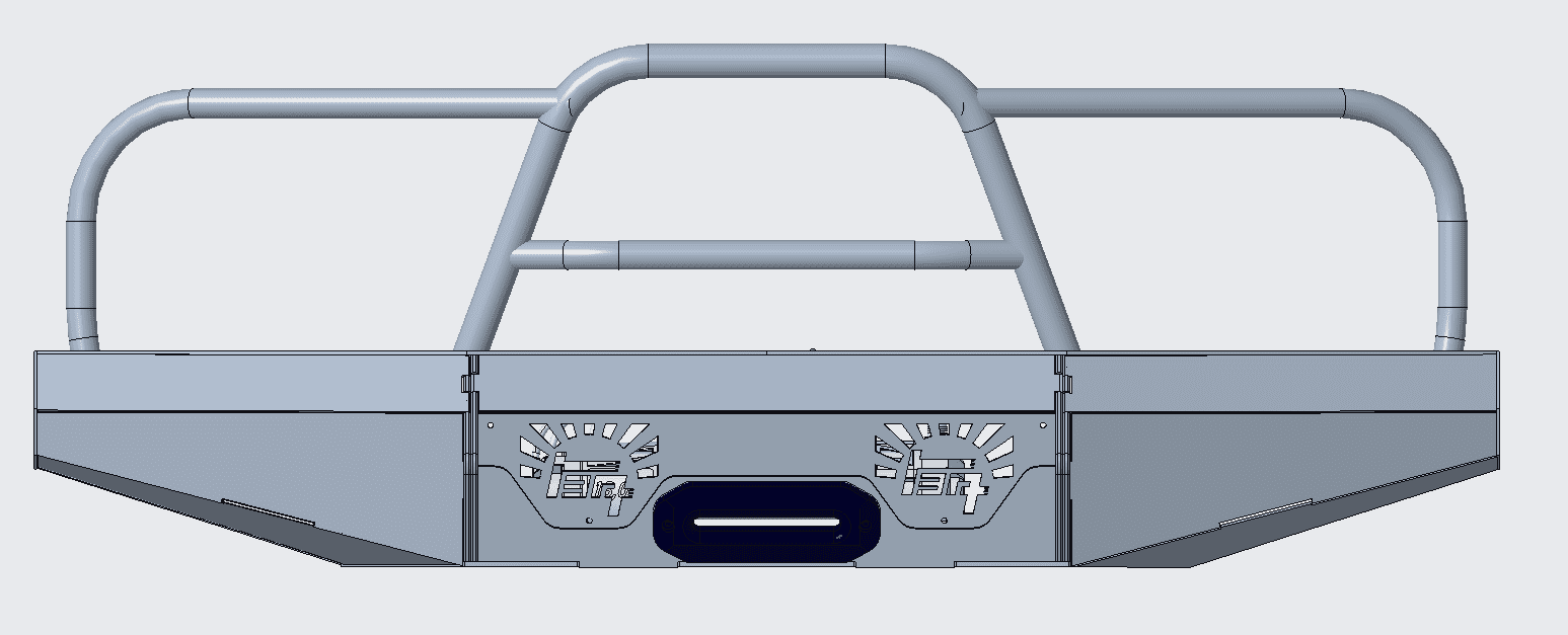

Here it is with no cut outs, and no lights. The cut outs lighten it up visually and physically.
Something I have worried about is if the cutouts will whistle annoyingly at highway speed.
That's nice, I like the TEQ touches. Good call on the potential for whistling too. Can you clarify what you mean by "source your own tube work"? If you mean the tubes are separate from the bumper, then all the better. Again, thanks for doing this.
It means what it says, you're on your own for tubing, because it isn't going to come with it.
Probably don’t have a dog in the fight but who knows until a kit price is posted.
That said if it were me I’d like the upper cut out for air flow. But would prefer to make my own cut outs for lights. Mixed emotion on the TEQ cut outs. Look cool but question what happens over time with corrosion and mud.
Finally I really like build your own hoops. But I own a bender so I bet I'm the minority there.
The ability to mount a 8274 winch would also be cool.
the 8274 is front mounted not foot mounted, it would require an adaptor welded in, or redesign of the front plate which is angled down, on purpose, to shed deer and pigs down under the rig. (We have both of those here and they are rough on the front end)

I talked to the vendor and they can add or delete cut outs as needed, just need to let them know what's wanted on each part.
I’m still down. When do you need the decision for design? Sent you the email with the design request. I removed all cutouts except for the two innermost fogs. I like the clean look despite it being a little heavier.
