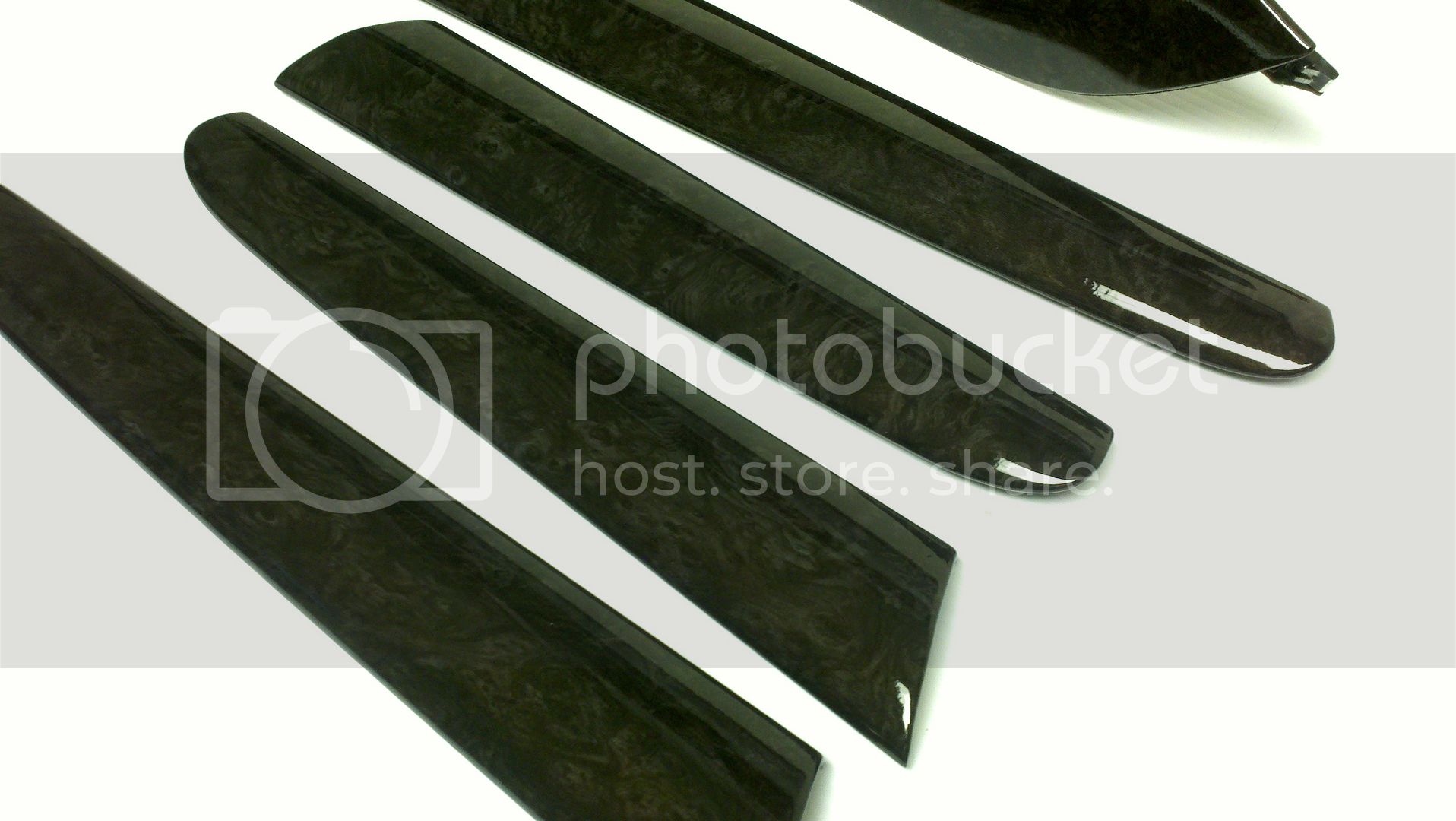

There's also hydrodipping. I want to get my interior wood trim pieces hydrodipped from the factory light wood to blackwood but I can't find any local places that have the blackwood material I want. Our wood pieces are VERY EXPENSIVE and don't come up at all on eBay so I'm hesitant to send them off to an out of state company.
There was one out of state hydrodipping company that did a few Lexus cars (blackwood) over on CL and I tried contacting them a few months back but I found out they went out of business. Here's the pieces that were hydrodipped into blackwood.

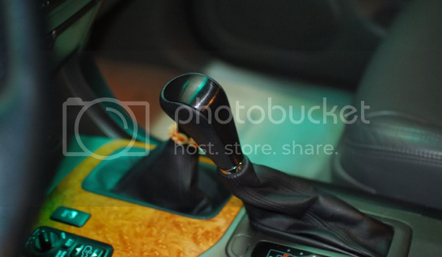

The sport package wood is called black bird's-eye maple. The blackwood is very similar, slightly different grain pattern though. I have gray interior and to me the golden bird's-eye maple wood doesn't belong. It's more at home in a tan interior. The Medium brown walnut started in '08, so if you find a '08 that you like you might not have to wrap any of the wood trim. :D

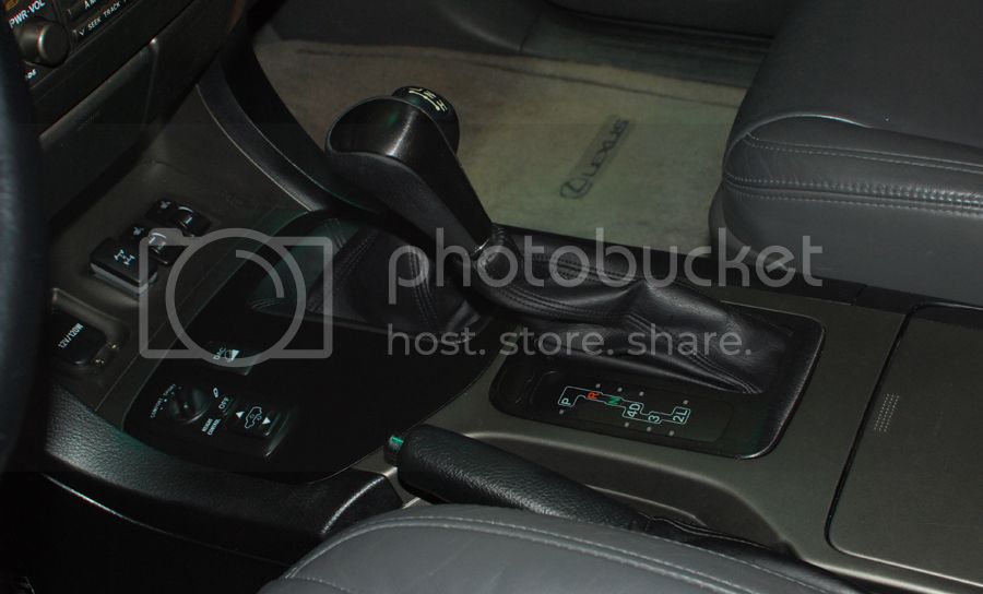

I did mine
I wrapped my trim in 3M vinyl. I used two colors. I used a matte silver grey for the door trim and a flat black around the radio. It was pretty easy and didn't take very long to do. I ordered the material off of ebay. just look at the 3M site to see what colors they have and do a search on ebay. there are people selling smaller pieces of the stuff. It looks like factory to most people who see it.
for the steering wheel i bought a high end leather cover. that took 30 min to put on and looks stock as well.
my build thread is the gx in seattle you can see the pics of the interior. much better than the boat like wood grain.

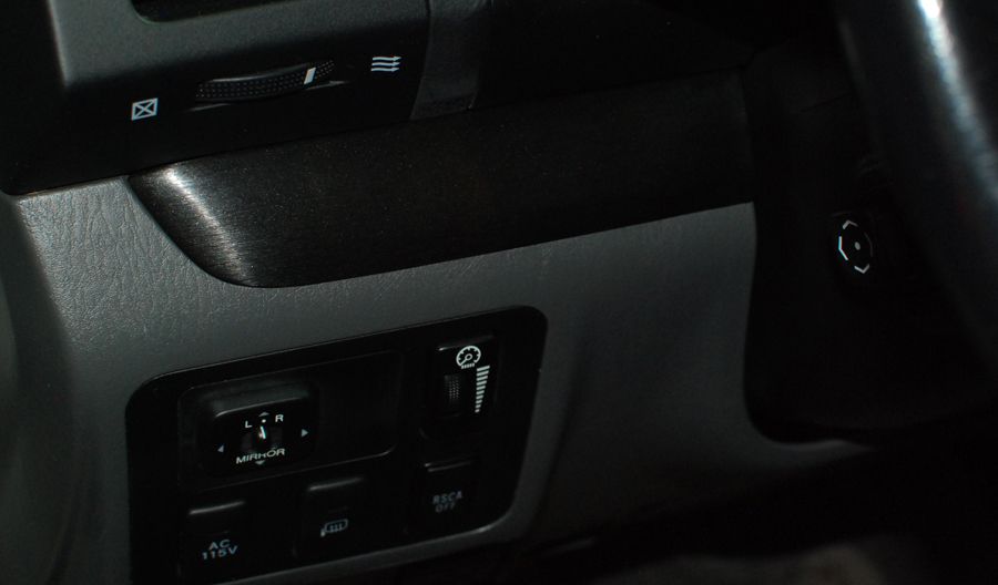

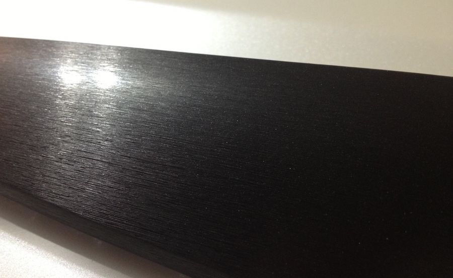

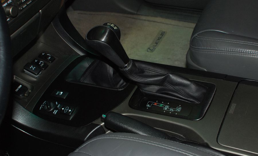

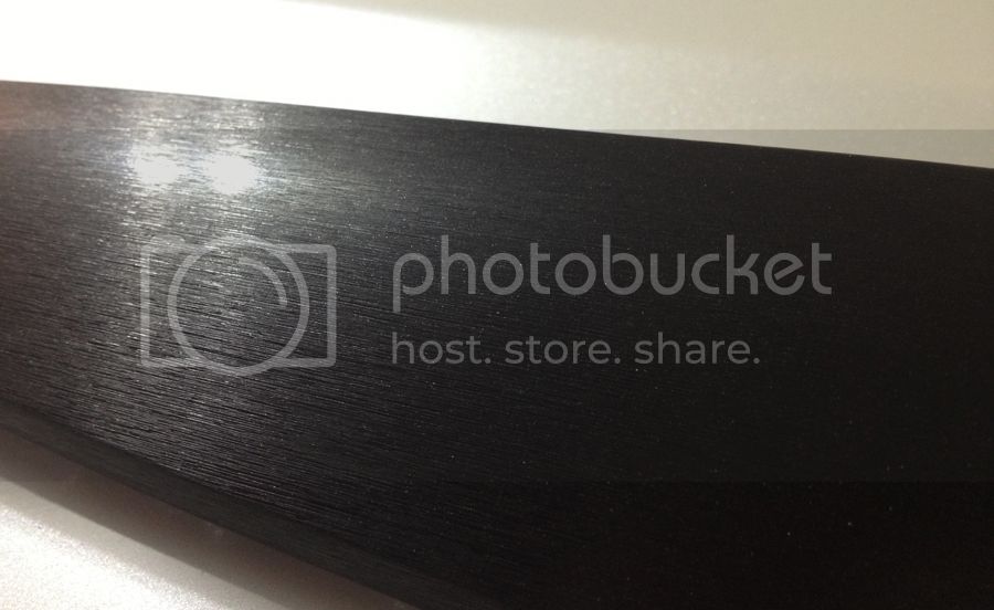

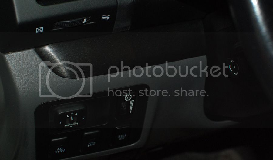

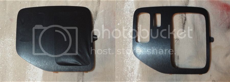

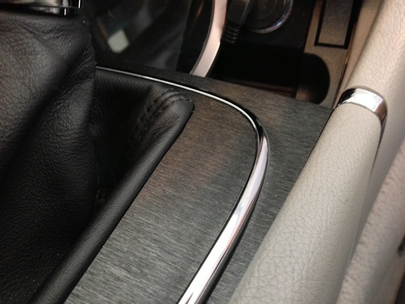

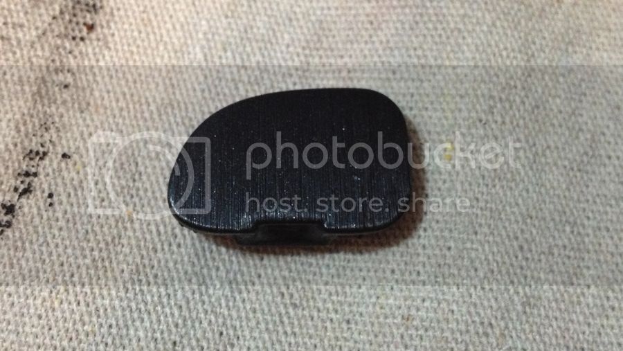

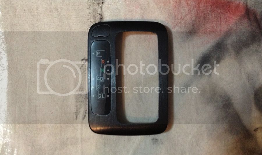

I did a few pieces today...so far so good.
http://i140.photobucket.com/albums/r34/rrcompton/Lexus GX470/3M/brushedmetallictexture.jpg~original
http://i140.photobucket.com/albums/r34/rrcompton/Lexus GX470/3M/leftofsteeringwheel.jpg~original
http://i140.photobucket.com/albums/r34/rrcompton/glovebox.jpg~original
http://i140.photobucket.com/albums/r34/rrcompton/Lexus GX470/3M/gearshiftknob.jpg~original

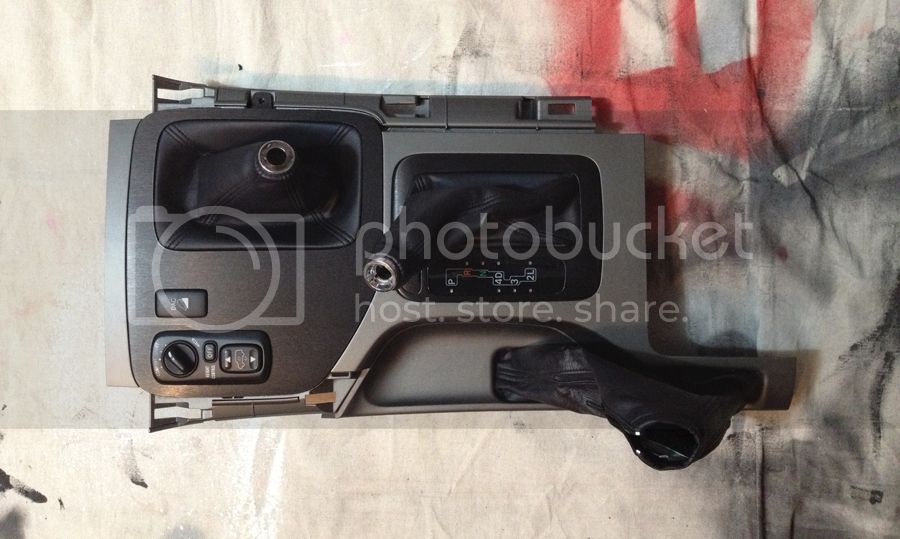

http://s140.photobucket.com/user/rrcompton/media/Lexus GX470/3M/console.jpg.html

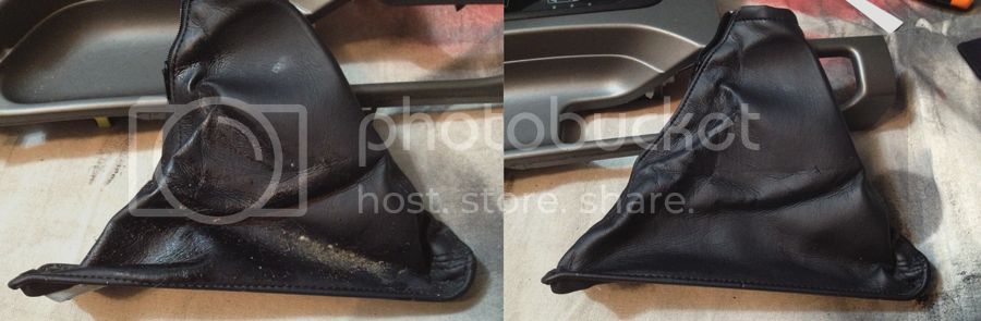

*While you have the console out, remove the shifter boot, transfer case boot and most of all the e-brake boot so you can clean the part of the boot that you can't see when they're mounted.*

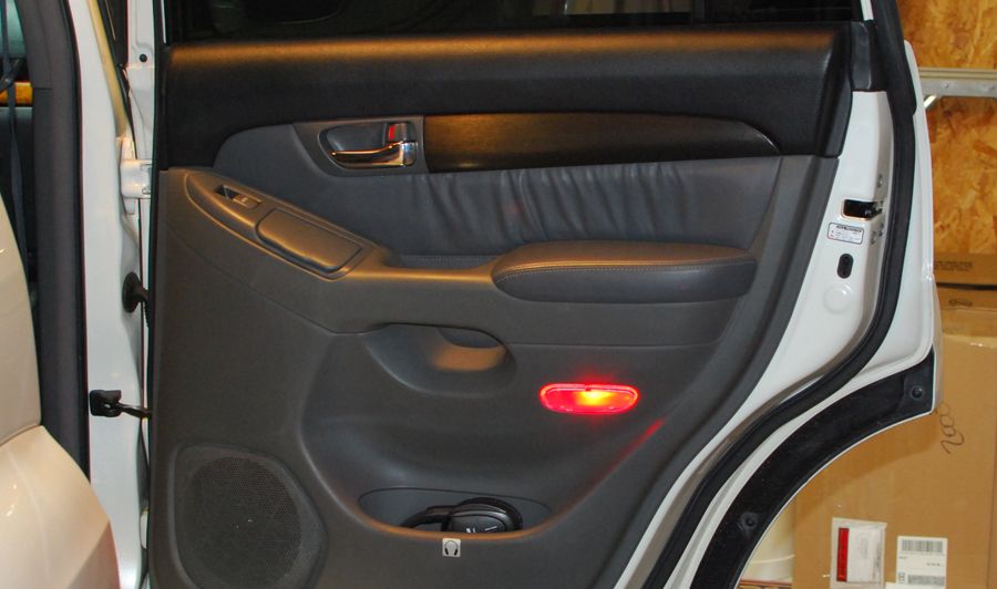

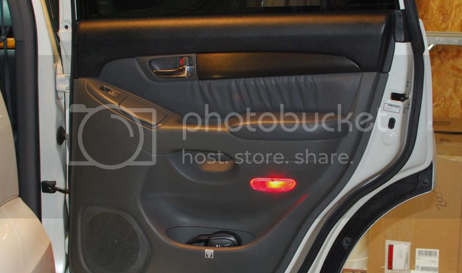

http://i140.photobucket.com/albums/...470/3M/closeupmountedondoorpanel.jpg~original
http://i140.photobucket.com/albums/.../completedandmounteddoorpanelD80.jpg~original
And disregard what I said on post #14. The door panel trim pieces are NOT held in by pressure clips. You have to remove the door panels and unscrew the wood trim from the backside.
