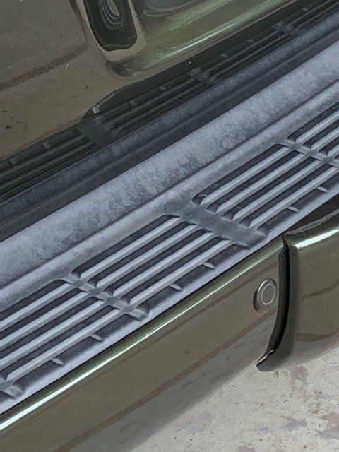

I have a 2010 Cruiser, and it looks fantastic except for the black trim pieces such as this one, which is highly visible. I was thinking about taking this rubber piece off and shooting it with new paint. I know there's a lot of "back to black" creams, but they really just give it a shine and it's still not back to black. And it wears off after a couple of washes.
So...should I paint this? And if so, how does it come off?

To take it off you’ll need a bunch of the replacement clips. They nearly all break. Easy to do otherwise

Replacement is a great idea; part is slightly more expensive than I would have thought. FWIW I have found that even when these Toyota plastics start to turn chalky they actually accept plastic restorers extremely well.

The gold standard by most accounts is Solution Finish. It is actually impregnated with black pigment and is what the vast majority of high end detailers will use to restore trim.
I probably would not recommend painting due to the expansion and contraction of the plastic, especially a climate like TX.

For black plastic what you are seeing is just oxidation. You can remove it easily if you very lightly wave a propane torch over the area and its amazing all the oxidation just disappears. It happens as soon as the heat hits so you dont hold it in one place long enough to melt anything. Can also use a heat gun which may be a bit safer if you have never done it before or want to do it while its still on the car. Have used this trick for decades with windshield cowls with cars that had unmatched black plastic bumpers. Made them look new in 5 minutes and it lasts for years as you are basically taking of all the buildup and it strats over again.

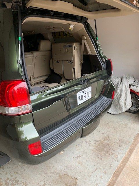

@TexasHusker, unrelated to the post but, that is a great green color on your LC. Is that a wrap or paint? Do you have the code name/number by any chance? I'm planning to wrap my LX green and been torn on the exact shade.
Be careful with the propane torch. It works well but is pretty easy to get streaky on the Toyota plastics. Works great on GM plastics though.
Also have had good success with degeasing with Dawn and using black shoe polish, lasts for a few years.
