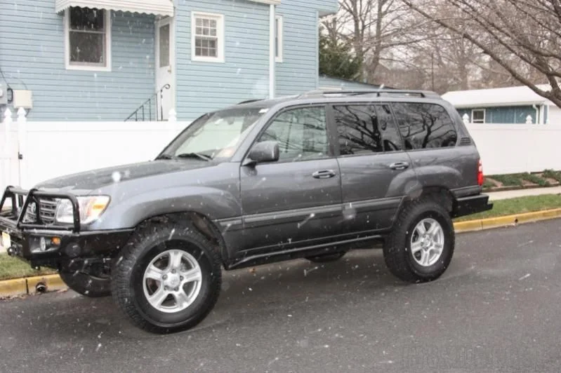

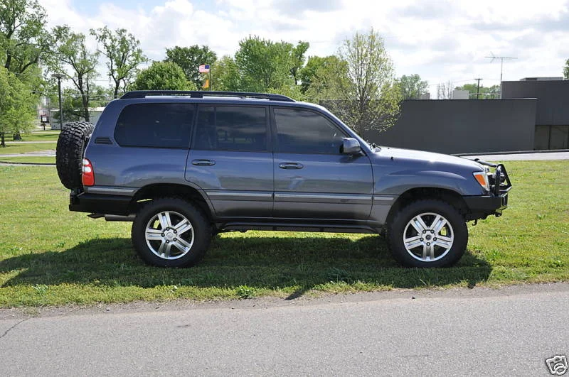

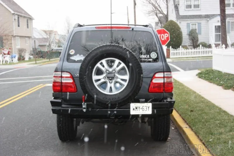

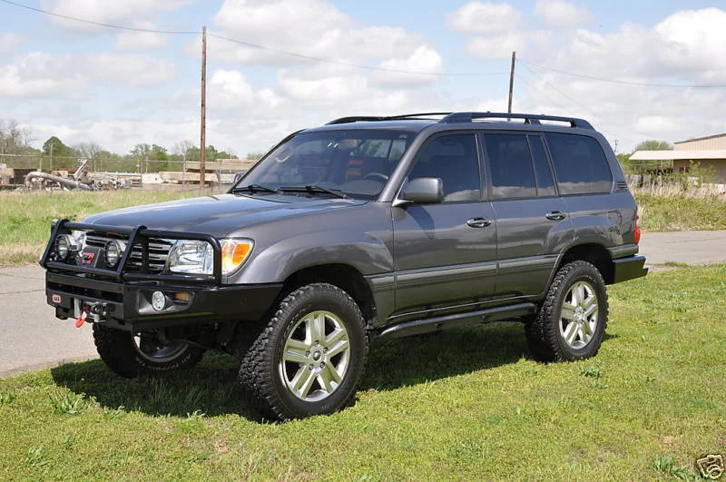

I would like a black rim combo, with alittle smaller rim but same overall tire height. So more rubber. I was thinking of just painting the rims, but just dont know.
2 picts of as is
The problem with the LC's is the 5x150 bolt pattern. Now that the newer Tundra, Sequoia and LC have this same bolt pattern...more wheel companies are making aftermarket rims. Unfortunately, the rims are 18" and larger.
It would be nice if the former owner kept his 17" combo that was posted on here when it was for sale earlier this year. There are some pro-comps in alloy and gloss black that are 16" and have less offset, which will make them stick out of the wheel well.
I have some photos if you want to check out some different looks.
Bendfj
here is what it used to look like....
it looks too skinny now from the front and rear. I just think it needs more of a meaty look. And any picts of suggestions would help. its in the shop getting my radar hard wired, alarm, new speakers in doors, and the front drive shaft balanced or sleeved.... Has a wierd vibration around 65

Cool. I say sell the 20s with the 35" tires to someone with a tundra, get yourself a set of 16s (or 18s if 2" more of tires will work) and get some 35s. Keep the drawers, you'll wish you had them after you sell them.

I say 305 cooper stt's with black steelies. I think it would look very good.
With your gearing, you are likely going to want 35" tires, maybe 34". Basically, the size tire will be (there are a few others too)
315/75-16 (~35")(may or may not require wheel spacers as you have the UCA's)
285/75-17 (34")
285/75-18 (35")
35x12.5-18 (may or may not require wheel spacers as you have the UCA's)
I like the 285 width myself.

As far as the wheels, if you were to paint them black it would match quite well and tone down the 20" quite well. However if you actually plan to go offroad with it I suggest downsizing.
