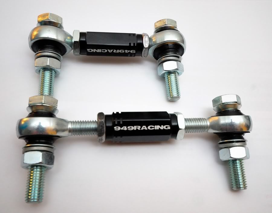

Heim joint or uniball in place of the rubber bushing but it'll probably interfere with the mount.
Aside from that, you can probably just make your own links fairly easily.

I only have 285/70/17's and I'm not running a KDSS relocation bracket. In my case this issue is being caused by my Tundra IFS swap and a taller lift than most. I like the Heim joint idea - but I prefer a rubber bushing here...
