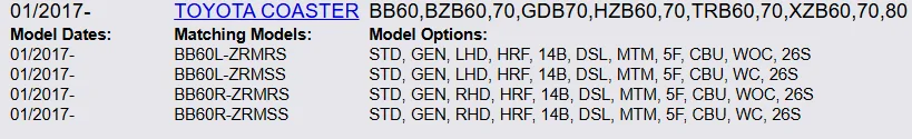

A 14B or 15B-F would be the best solution IMO - easy parts availability (the 14B is still in production), no chassis/transmission/driveline modifications (maybe a bit of clutch housing grinding on earlier H55Fs) and a big improvement on a 3B in every way. And a far better platform to put a turbocharger on than a weak IDI engine. The only snag for some would be that they are hard/expensive to find in North America.

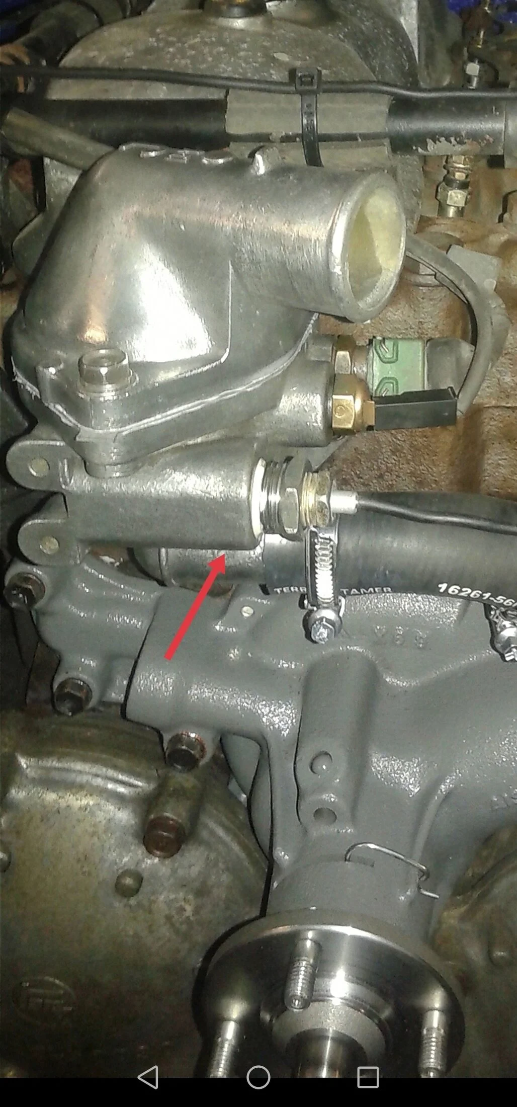

It’s strange, the gauge never says it’s hot, but sometimes I worry it’s not reading correctly.
factory gauge is a liar....
theres a port on the thermostat housing that will accept a proper (aftermarket) temp sensor, screws right in....

...A 14B or 15B-F would be the best solution IMO - easy parts availability (the 14B is still in production), no chassis/transmission/driveline modifications (maybe a bit of clutch housing grinding on earlier H55Fs) and a big improvement on a 3B in every way...
Love the 14B for the reasons you mentioned. Not sure that is still in production though... 🤔
