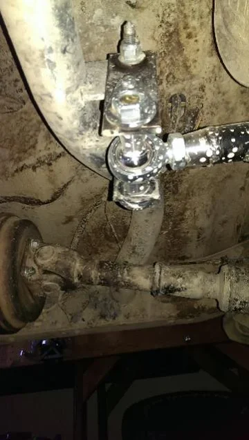

Is it BENT over toward the pass side of the rig?
If so then I would suspect a bind somewhere.
Yep, bent towards the passenger side. The bracket also broke, towards the bottom of it.
I thought it could be a bind, wonder if too much articulation caused the bend? That's one thing I didn't do when I installed it, test fir binding.
Testing for binding is important.
It looks like you side loaded it pretty badly.
A lesson learned for sure, I'm also thinking the 3/4" heim didn't allow enough twist, and this is the result.
I think I'll try to get it as straight as possible, and see if I can locate a possible bind.

I wonder if the Heim (under full flex) isn't hitting the bracket and binding??
There are spacers that you can get to put on both sides of the heims that that will allow more free room for them to clear and not hit and bind.
The bracket that's there looks to be about a 1/4 in? The ruffstuff bracket is markedly thicker! I wonder if the Heim (under full flex) isn't hitting the bracket and binding?? There are spacers that you can get to put on both sides of the heims that that will allow more free room for them to clear and not hit and bind.
The bracket is 1/4". My buddy has the RuffStuff kit, it's super beefy, which I like.
Maybe the weakness is the size of the bracket, using 5/8" heims, (instead of the standard bushings). I have misalignment spacers on the heims, just don't recall what size. Since it needs to be re-done, might as well do it right this time, or do it better, more or less following the standard designs.
the axle end does not need misalignment spacers, the shackle end does.
I have a small one on the axle, just enough so it doesn't rest on the bracket itself.
Here is what the shackle end looks like.
I think the total width with the misalignment spacers are 2 5/8" wide.
If you notice that rod end is already maxed out. you drop just the DS rear tire and it will put a ton of force on the mounting bracket.
If your talking about what I think your talking about, mainly the heim, it looks like that because the bracket is bent, and I haven't straightened it out yet, when it was put in, the heim was straight.
You bent the shackle as well?
The thing is that you really do not need anything but bushings at the axle end. The heim at the shackle end has to be able to twist tho..
Yea, I had the heims already, which is why I used them, I plan to go with bushings on my next one. Do you think upgrading the heim on the shackle end would help in allowing more flex? As far as I know, I have some of the biggest misalignment spacers, I'm thinking the 3/4" heim isn't allowing enough twist.

So I took a closer look at the bar today and the setup. I think I know how it failed.
The jam nut came lose enough to allow the heim to move to the left (drivers side)
When the rear axle articulated, the heim was already maxed out, which I believe caused the bracket to bend to the right (passenger side).
It makes sense, and I can see how the heim being maxed out would cause this, because it would not allow the joint to flex like it was intended.
Make sense, or am I just crazy?
