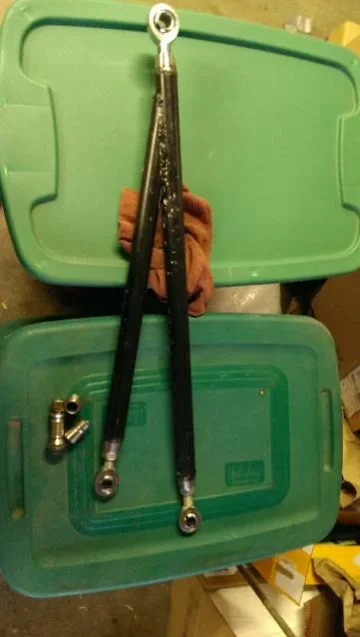

I think it's time to pull out the GoPro and do some testing. I'm going to change my design on Friday, I'm going to run a heim joint at the frame, along with the 2 on the axle.

Despite all the debate on the "better" design, the standard triangular design you're planning will likely be more than sufficient.
That's kind of what I was thinking. I'm a little curious as to why you would want to use a shackle and a telescoping anti-wrap bar, doesn't the shackle basically do that exact thing, as using a telescoping style?
I'm starting to think my 5/8" heim's might not be "big enough" for the anti-wrap bar.

I think I used a 5/8 in heim and used 1/4 wall DOM for the ladder frame. I'd make every effort to have the upper and lower tubes meet as close to the end of the wrap bar as possible. I added 1/4 In plate as sort of a gusset INSIDE of the triangle. There really is a LOT of force generated in "wrap". The one failure I had seen resulted in a busted pinion IMMEDIATELY after the wrap bar snapped. It was a design where there was 2-3 in. of overhang on the main tube.
I'm using 1/4" DOM for both bars now. If I remember correctly, the bottom bar meets the top bar with about 2-3" to the joint. I don't have a gusset though, even though I thought about putting one on. Since I'm going to be changing it, I might as well put one there, definitely would not hurt.

After looking at my tubing again, I made an error, I'ts not 1/4" DOM. It's actually 1 1/4" .120 wall DOM.
I think mine is fairly decent, but I do believe I will be changing to all heim's, and maybe adding some gussets to it.
I'm running a F135 w/ 3sp, and original tcase, on 33's!
if you use 5/8 heims, get the larger aircraft quality ones. those should be strong enough with your set up. IIRC that's what I have now with the LT1. the regular 5/8 ones broke with the I-6 and took out my pinion. (many years ago when I was much more inexperienced at wheeling and fabbing)
Nope... Sorry, I mis spoke earlier and said I used. 5/8's heims.... I used 3/4 heims.

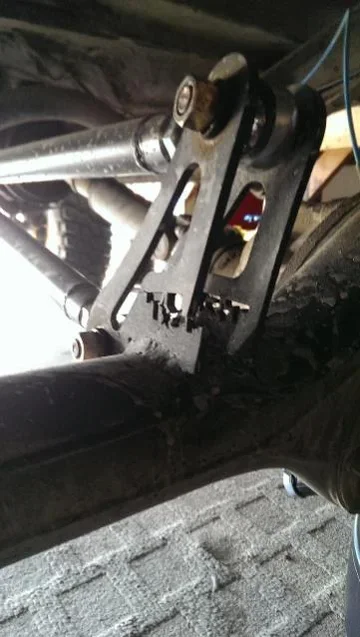

So long time after my last post. I got my anti-wrap bar modified, after I snapped the welds off the bracket the first time.
So after I installed a 3/4" heim joint at the front, and took it on some back roads to do a little hunting, this happened.
How it happened, I have no idea, still can't figure it out. My goal was to put my GoPro under the tub, so I can see how it was flexing, but I left at night, and didn't put the GoPro on.
The front shackle moves, does not bind or anything like that, I'm thinking the weak point was the anti-wrap bracket itself, might be time to upgrade to the RuffStuff anti-wrap bar.
