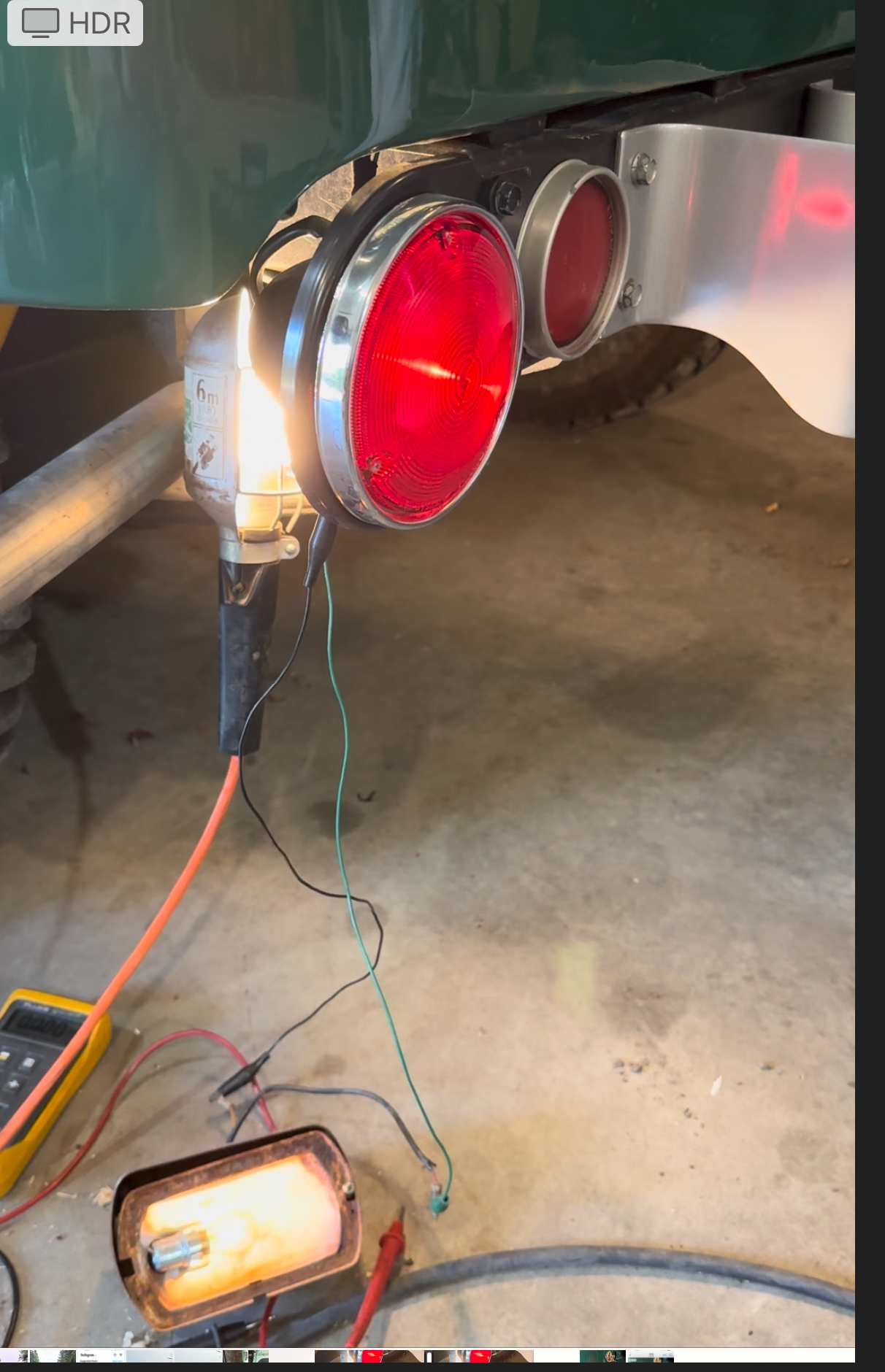

I think I have found a solution to this issue. It is definitely load related. I tested a theory tonight and added a third light to the circuit and the flashing rate changed from a fast rate to a normal rate. I have ordered 2 LED load equalizers to install. At this point, with only two installed, the turn signals and hazards should work correctly. Anybody see a problem with this solution using incandescent blubs?
Third light connect changed the blinking rate from fast to normal.
Is that a unicorn 1973 backup light being used as a test light?
