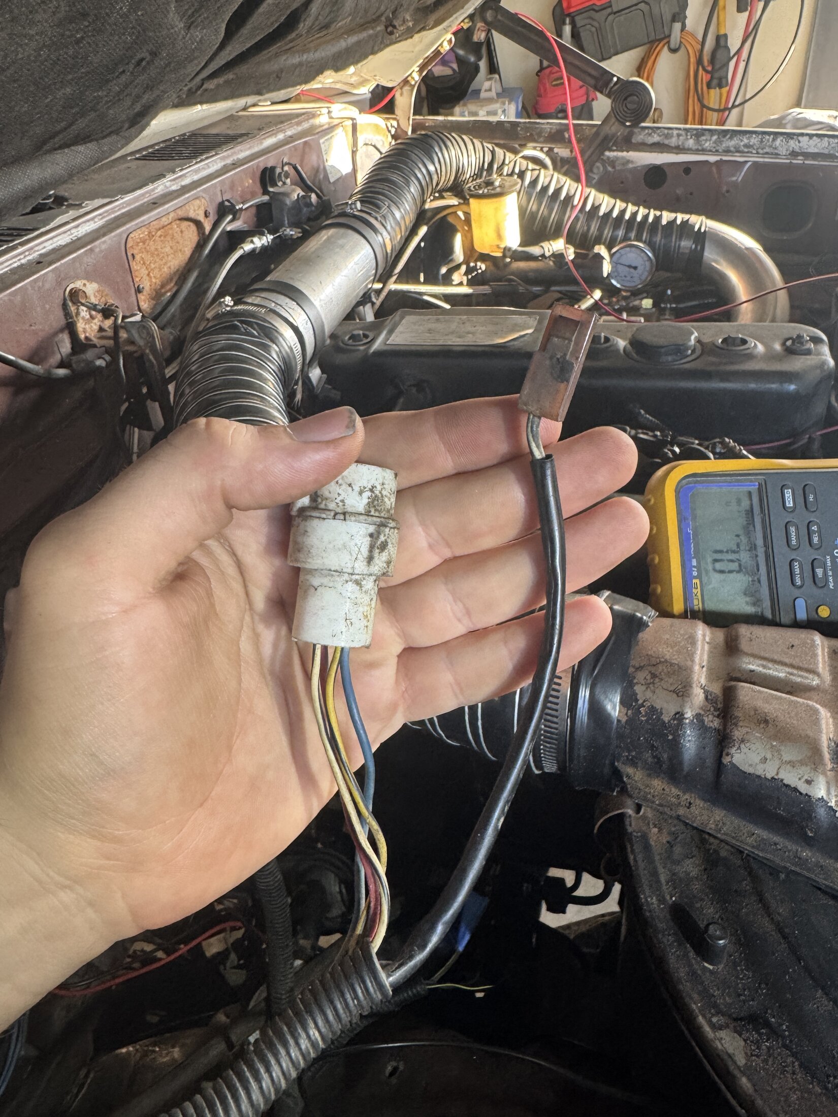

Hello all,
Working on wiring up the 4BD2TC in my FJ-60. I have the factory Toyota diagram, but I’m having an impossible time IDing this plug. It’s a 4 pin plug that has ignition hot, start, 12v hot, and accessory hot right next to the starter exciter wire. Nothing in the wiring diagram shows what it is or what it originally would have went to. Anybody know?
all 4 are +? something is wrong, generally white with black stripe should be ground -
I'm thinking that plug went to the trans/transfer case wiring
Hello all,
do you need to repair or replace that Female 4pin connector housing or terminals in your hand
or
the male one and its male terminals your still searching for that it mates up with ?
that is where the sub-harness for the transmission/transfer (reverse and 4wd light) plug into.
