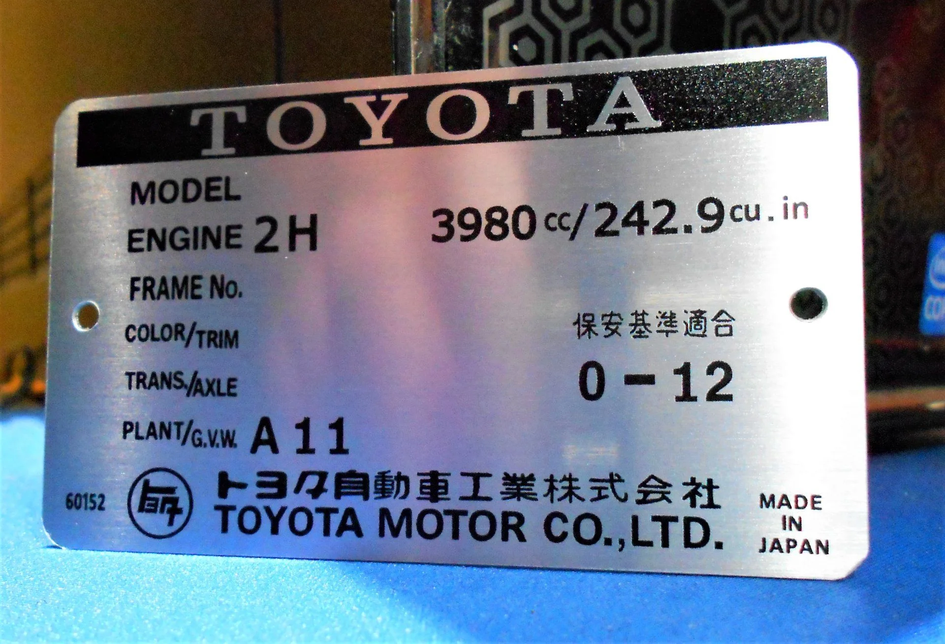

is this the earlier engine you have replaced it with ?
