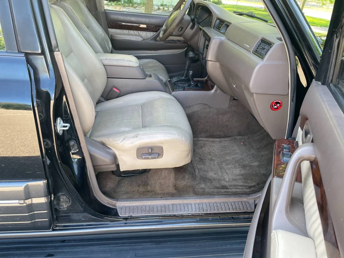

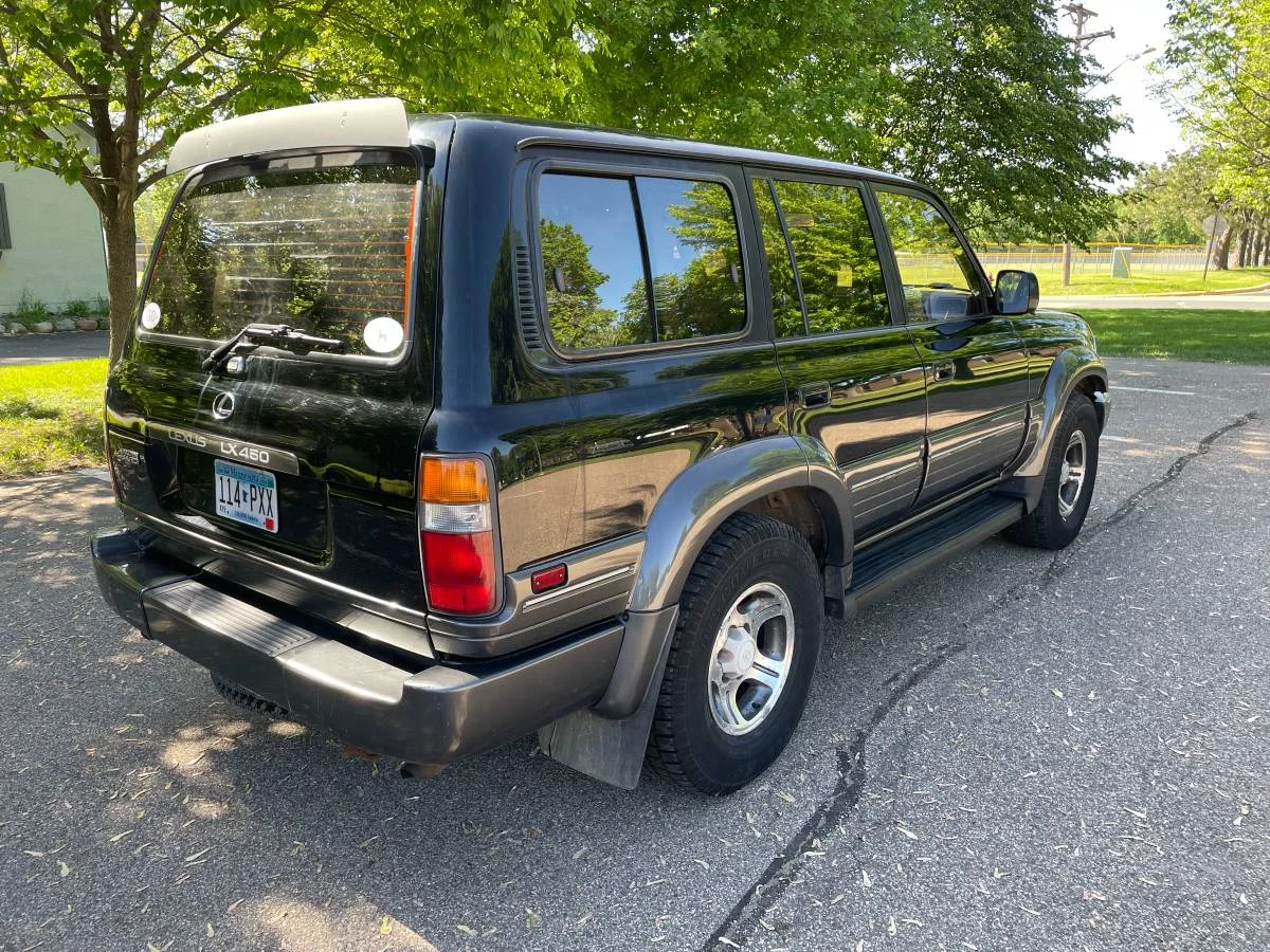

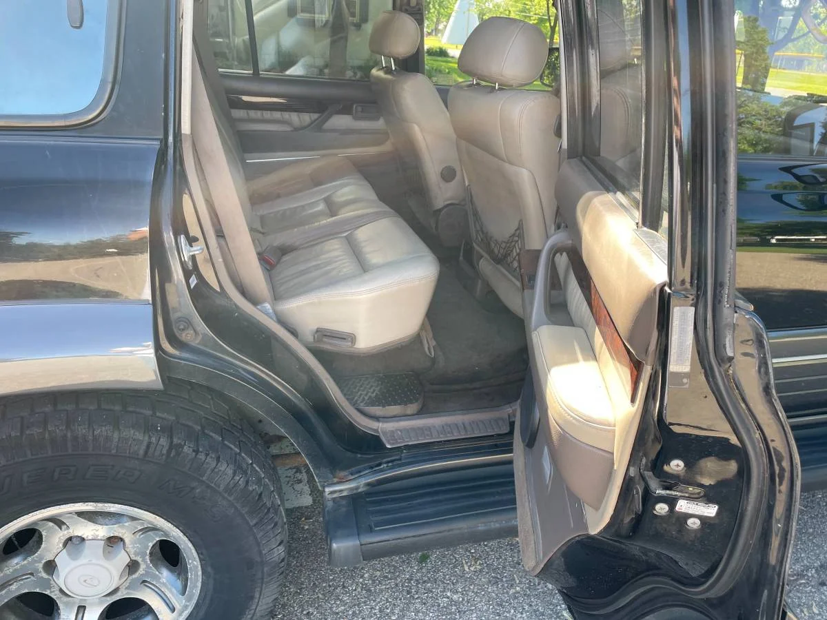

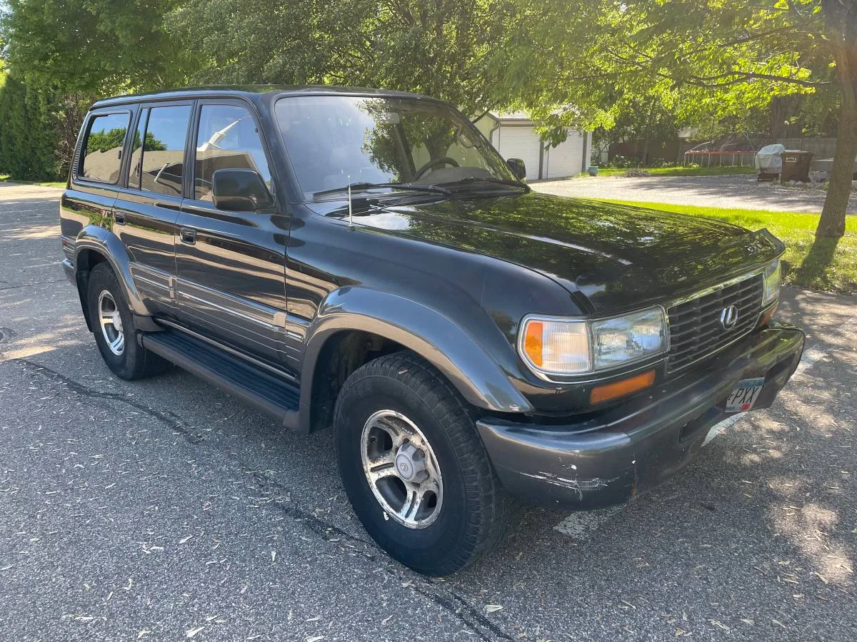

Anyway, here's some pics (she sure is a looker from afar, but as they say "beauty is in the eye of the beholder").

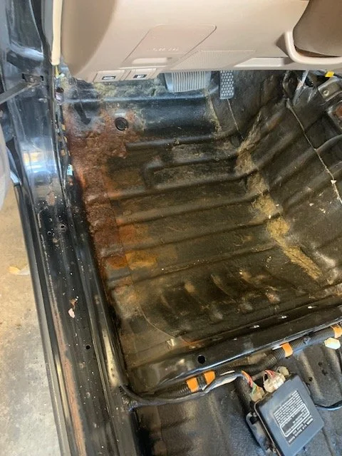

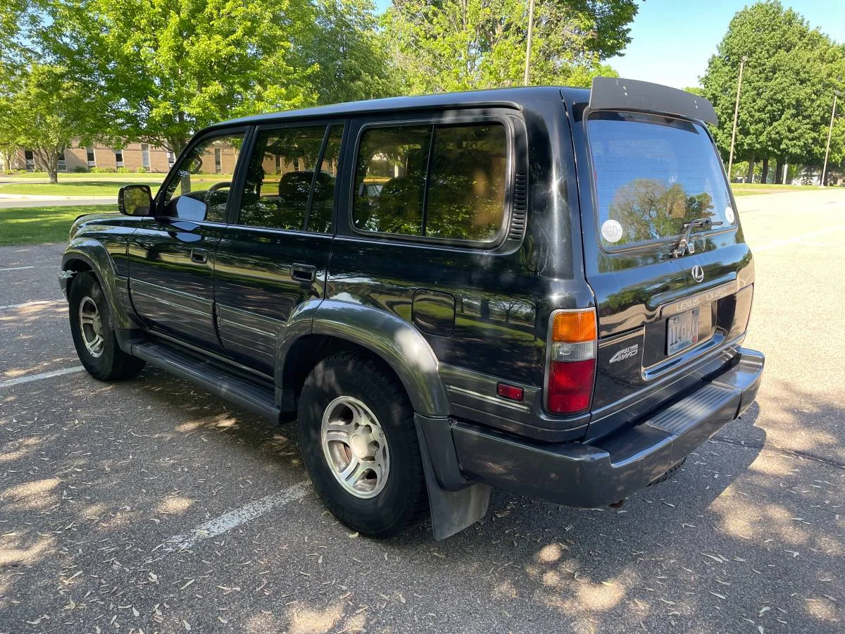

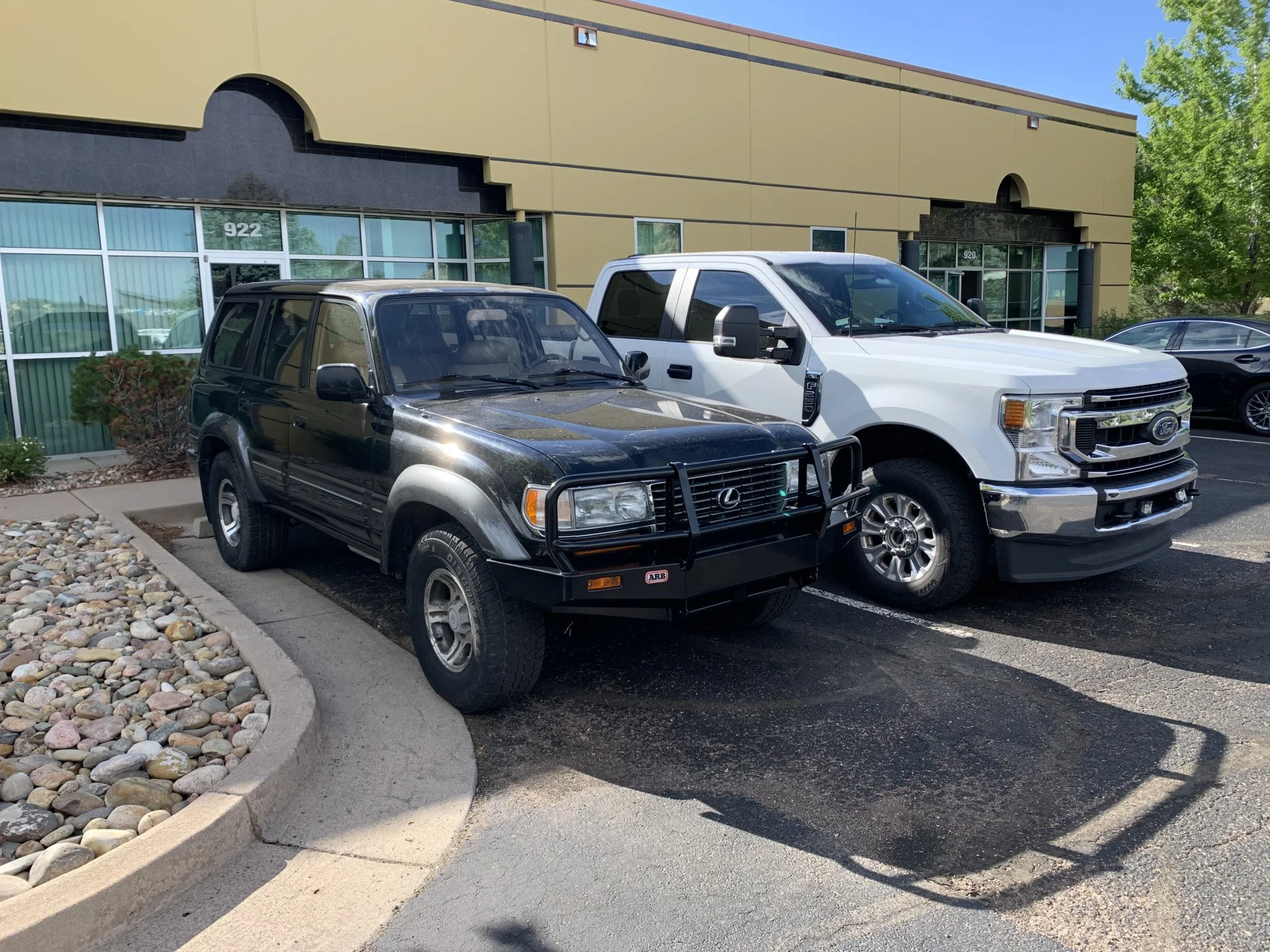

Well, here it is less than a week ago I picked her up in Minnesota. She's all there and unmolested...that's about where the positives end.
Under carriage is fairly rusty. While the frame and suspension attachment points all seem good enough, she's gonna need a lot of wire brushing, cleaner, neutralizer and coating. I went with KBS Coatings (or will when it get's here). I tore out the interior down to the factory sound matting. While the carpet was out, I vacuumed it, soaped it, and pressure washed it. Removed all the 1/2 (13mm) insulation off the carpet as a good portion came off when I pulled it out. Surprisingly, the only bad spot for rust was the driver's footwell. This will be a tougher spot to address, so until I have the time and it's at my house, I'll leave it be. Removed and cleaned all seats. disassembled the driver's seat as the gears on the outside fore/aft jack screw is stripped and I moved it all the way forward and could not return to a useable position.
Changed oil (I can only presume the previous person that did the oil change was a relative of Andre the Giant!) The oil filter was about 3/4's of a turn too tight. Took me an hour of handling (running back to my house to get my large mouth pliers). I ended up driving a screwdriver through it after moving the power steering reservoir out of the way.

5) Removed front bumper and mounts. Need advice on ordering new (plain jane, weld at home or go with Slee or ARB or similar?)

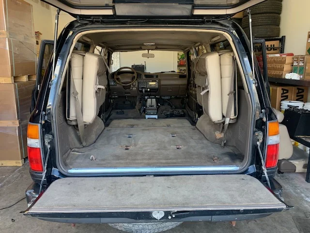

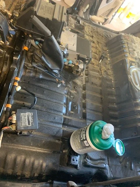

I am horrible at taking pics as I go as I prefer to boogie and get as much done as possible. Spent a good portion of Friday, all day Saturday and 4 hours today.
She needs:
New seat gears (Forward/Reverse)
New Driver's window motor
Still need to free the transfer case shifter. It is frozen solid. Looking underneath the joint is thoroughly corroded together (nice way of saying rusted AF). I sprayed some penetration oil on it twice on saturday...we'll try again this week. I had the whole center console out, removed both shifter plates, sprayed the joint, tried freeing...nothing).
Need the brakes squared away. While the seem to function just fine, it has a quirky feeling I'm not used too. Not soft, but not confident either. It does stop.
Still need to replace valve cover gasket and spark bolt tubes, cap/rotor and possibly wires?
Couple of pics...

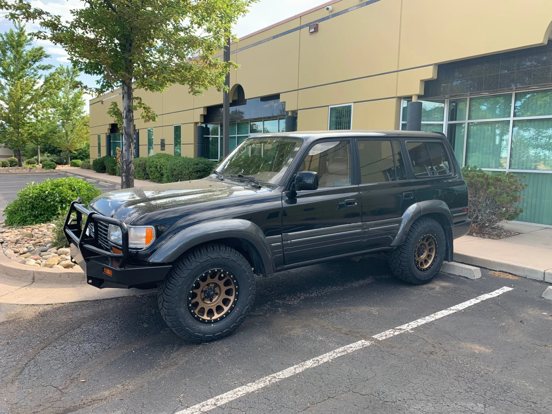

Me too. I also got the non winch version. Yours apparently didn't come with a roof rack, or perhaps someone removed it?
No factory roof rack. If my son wants one, we’ll look at options at that time. On the non-winch ARB, to me, a winch instills unearned confidence. First time driver, so I went this route as to not tempt me/us from making this a hardcore trail rig/over lander needing a winch. He has a badass KTM 250SX for his off-road buzz!

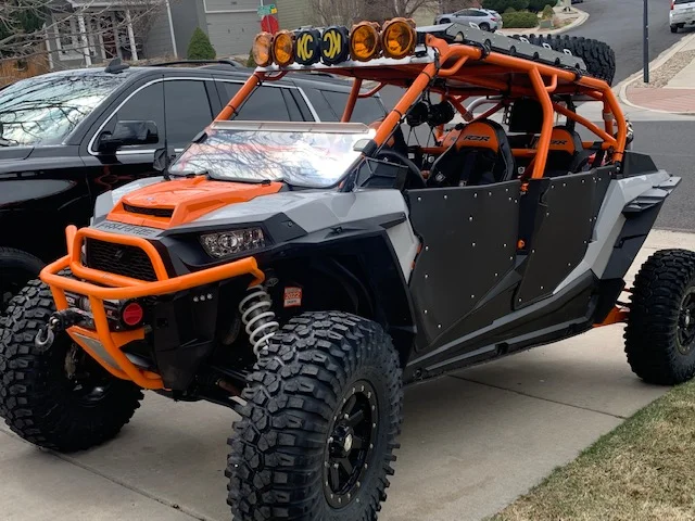

Nice bike! Are you looking to adopt a 50yr old stray? :)
Method Wheels NV305 in Bronze 17x8.5 O offset 4.25 BS with 285/70/17 Yokohama AtT-X E rating.
