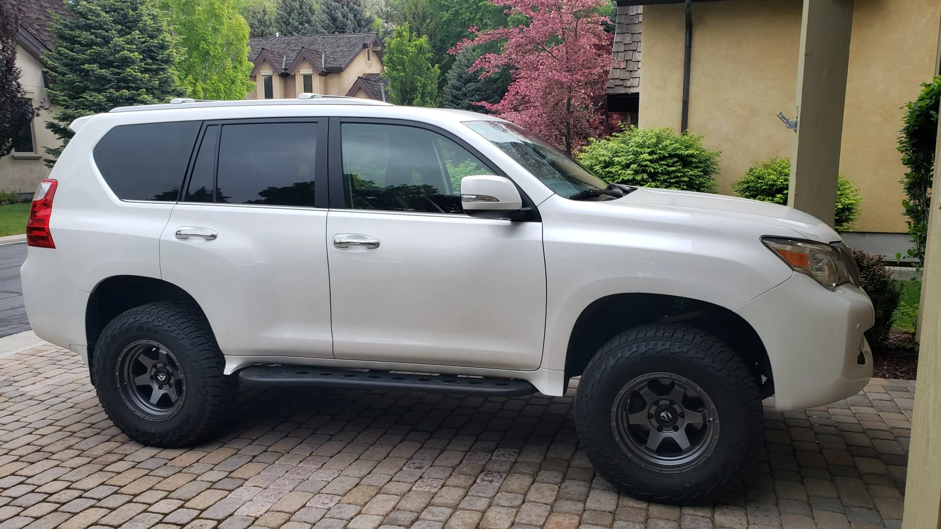

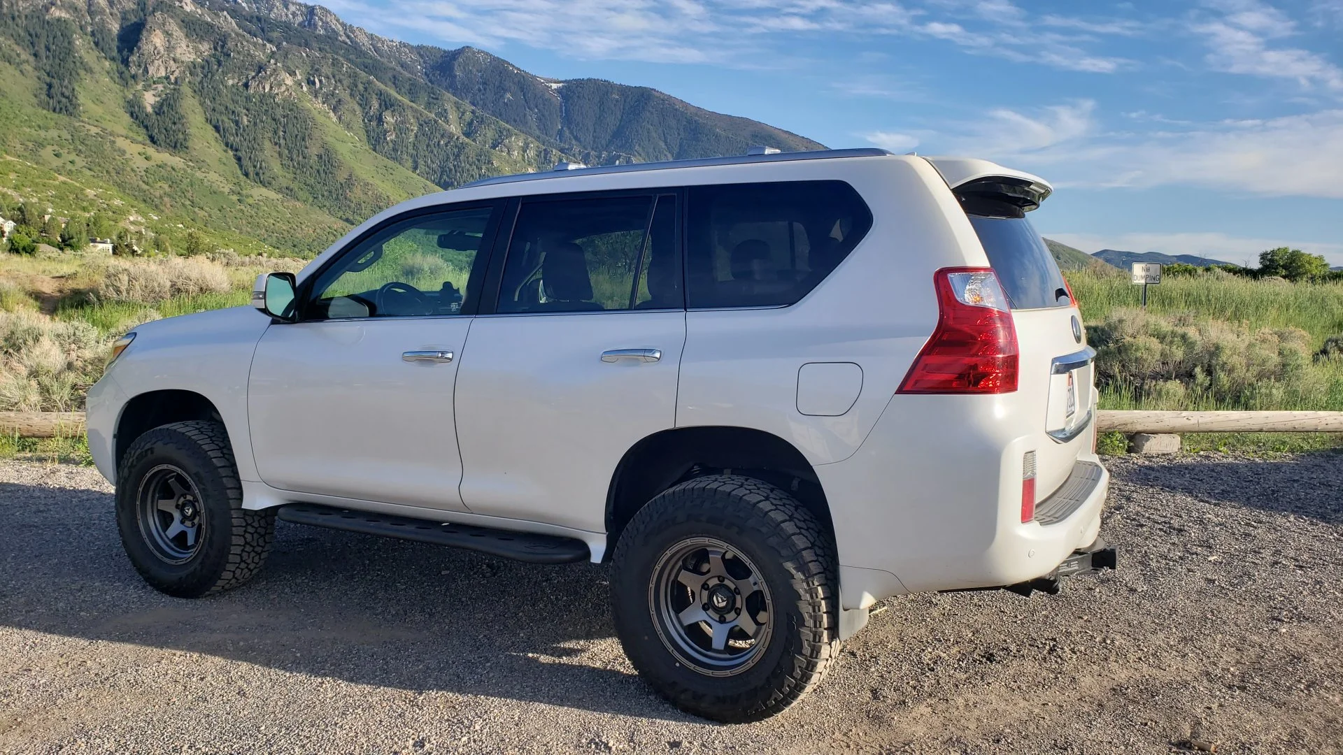

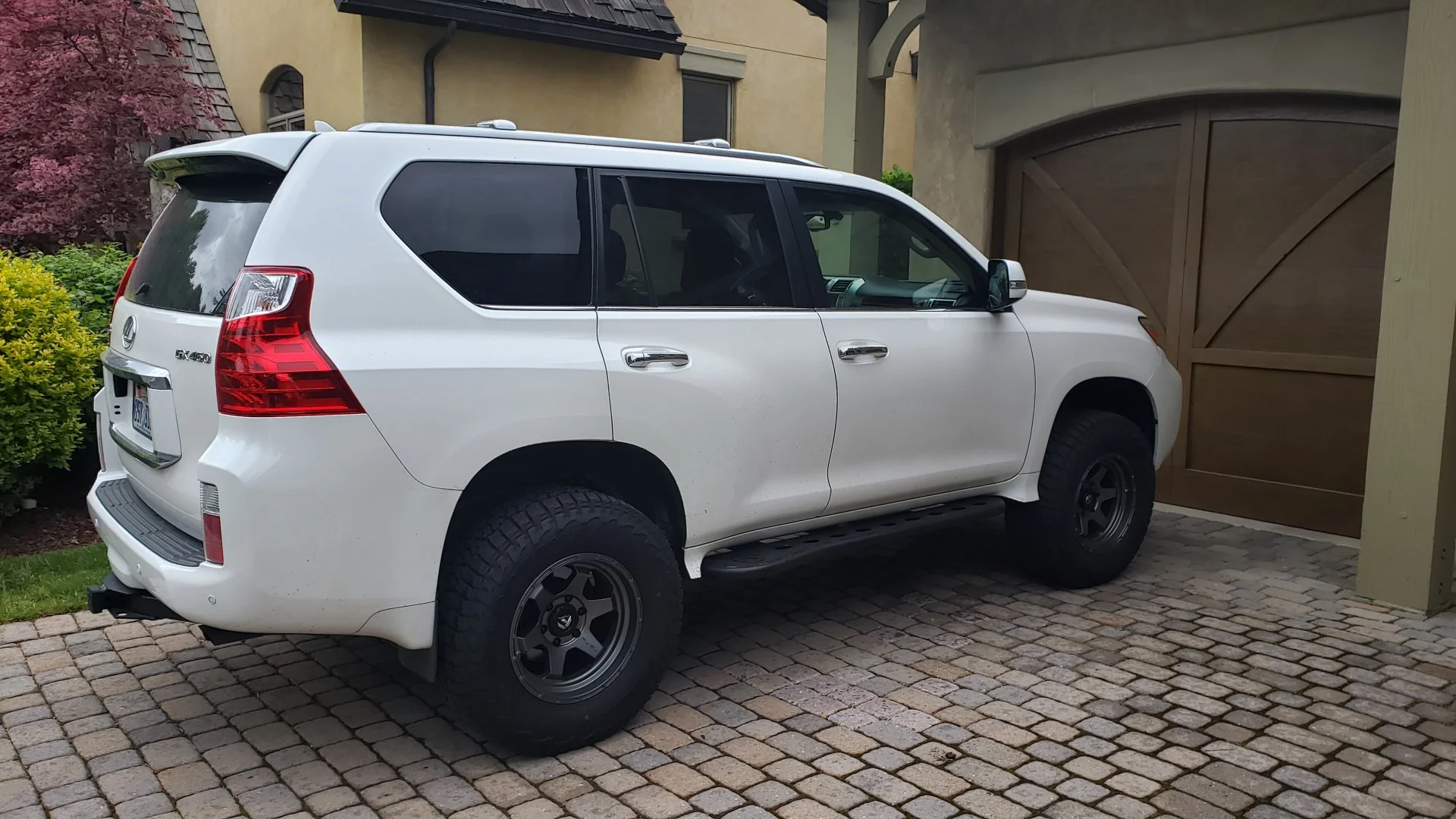

After a few idle winter months and various parts sitting in my garage, I have made the following mods in rough order:
1- OEM Hitch (purchased from local Lexus dealer; installed myself)
2- Lexus OEM 2 part rubber cargo area mat (Amazon)
3- 3D MAXpider - Kagu Black 1st Row Floor Mats (eBay; ordered 2nd Row as well, but that was canceled as out of stock and still is)
4- RAD Rubber Fender liners (RAD Rubber; installed with the lift, the old liners were brittle and had nearly disintegrated)
5- Ironman 4x4 FCP Stage 2 2.5" front and 2" rear green springs (Ironman USA direct; installed myself)
6- Step removal, trim piece cut and RSG flat sliders with top plate (not gripped) with kickout black powder coated (including logo) (RSG direct; installed myself)
7- Wheels - Fuel Shok Gunmetal 17x9 with -12 offset and Tires - Falken Wildpeak AT3W Passenger rated 285/70/17 (Discount Tire)
8- UNI Filter 1" Clamp mod (Amazon - actually a K&N 1" clamp filter and not UNI)
9- 2010 "Lexus" rear badge delete and swap of Lexus logo to 2020+ black and crystal logo
