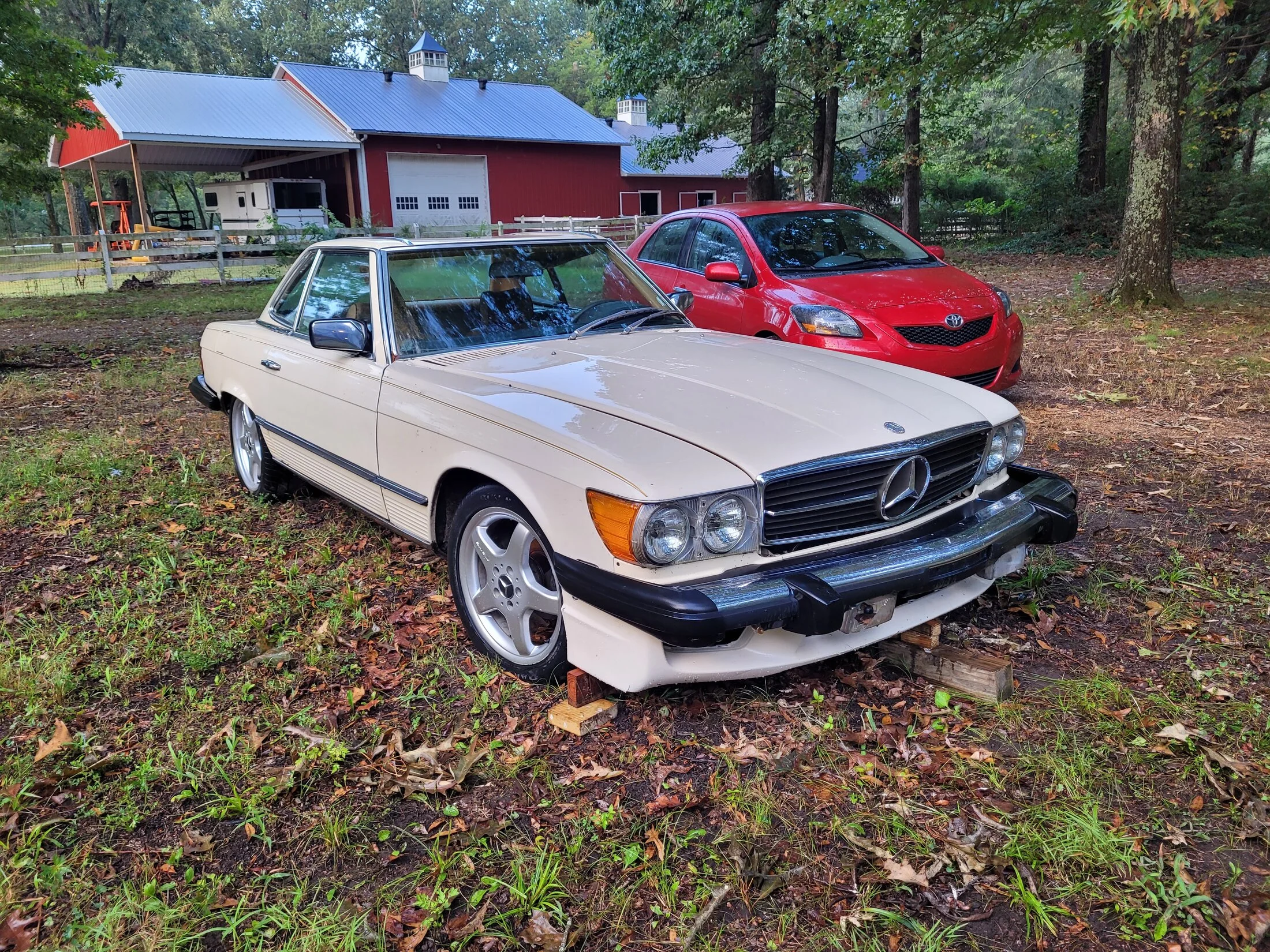

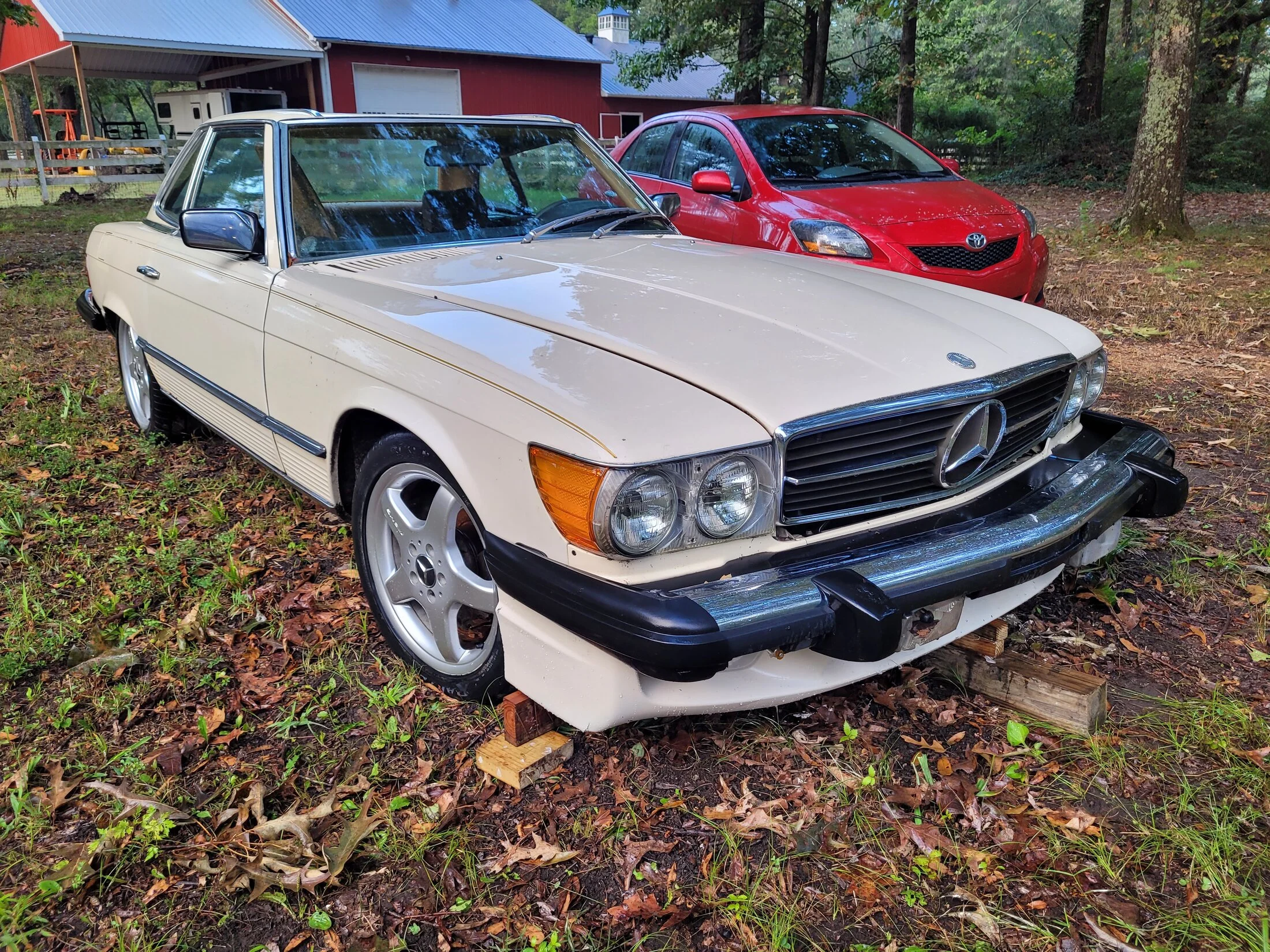

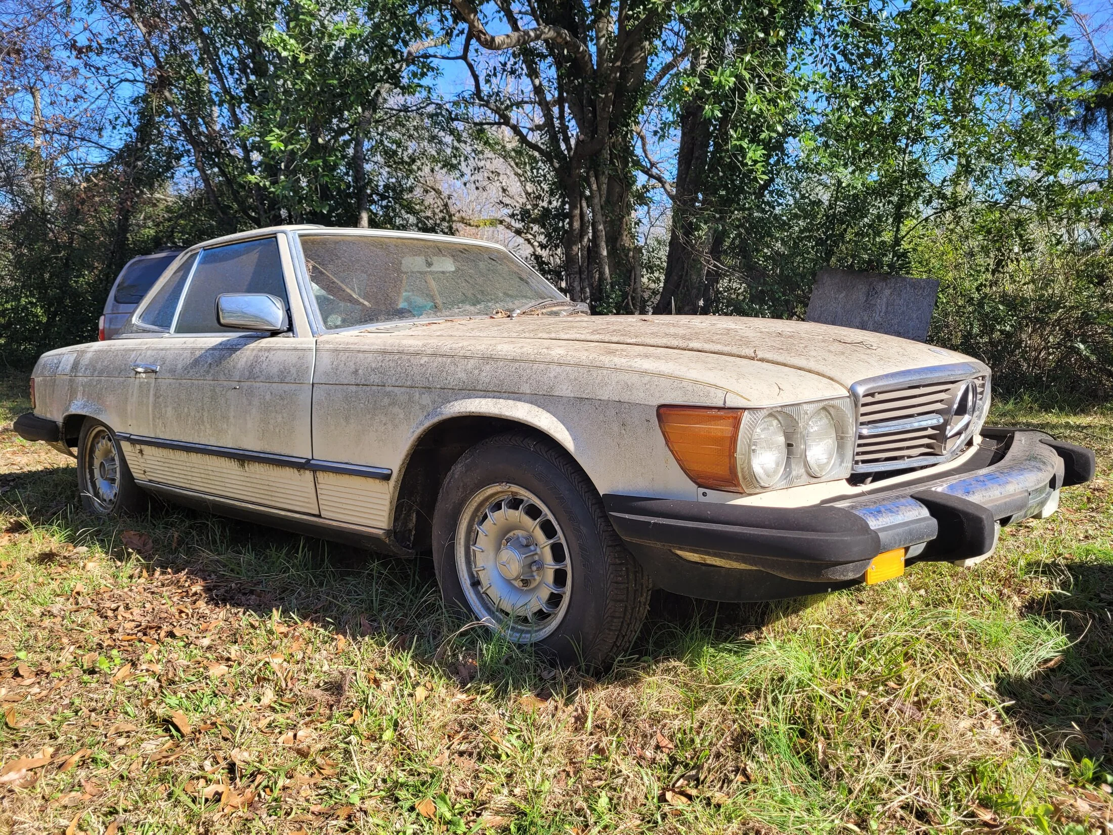

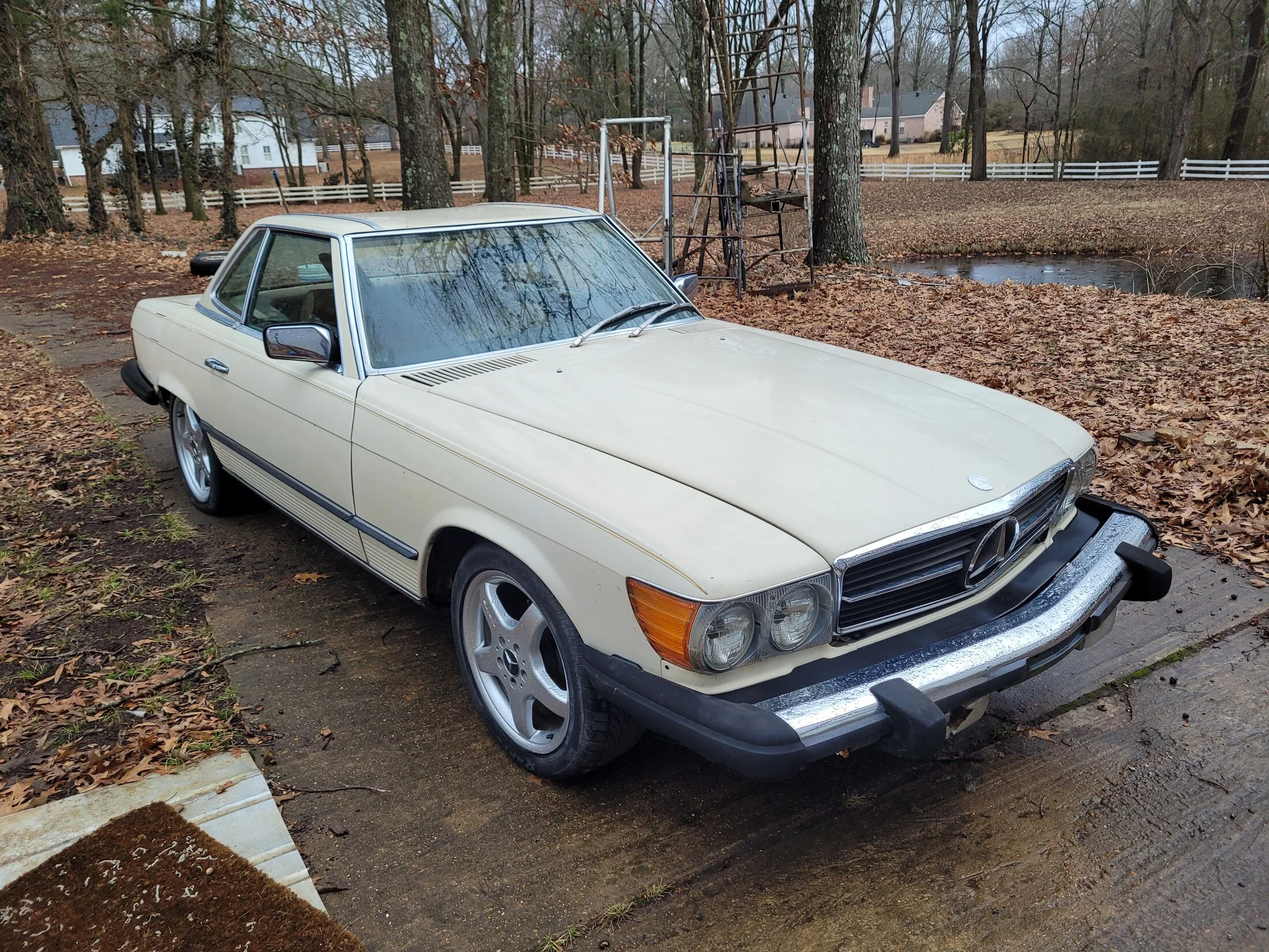

I too bought a cheap Mercedes convertible to play with.

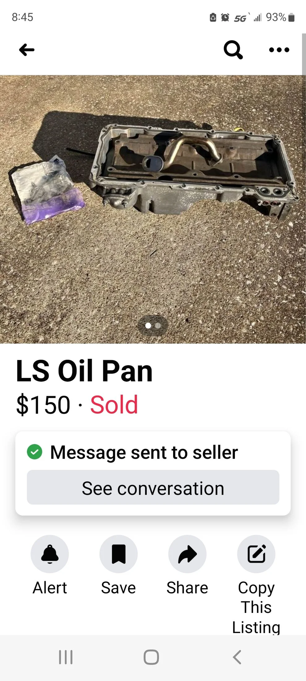

I know these cars have their issues, but I plan on getting rid of everything that causes problems. I'm sticking a 2002 chevy truck motor in it. A stock 5.3 is almost twice the horsepower this thing had when new. Supposedly a GTO oil pan is the trick to make this swap possible without replacing the whole front suspension. I will find out if that is true.
I plan on gutting the car and getting rid of the vacuum powered stuff. I will be putting street rod components in their place.

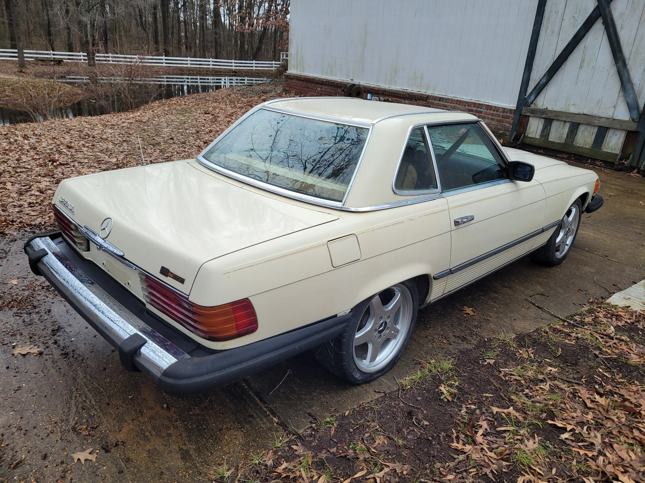

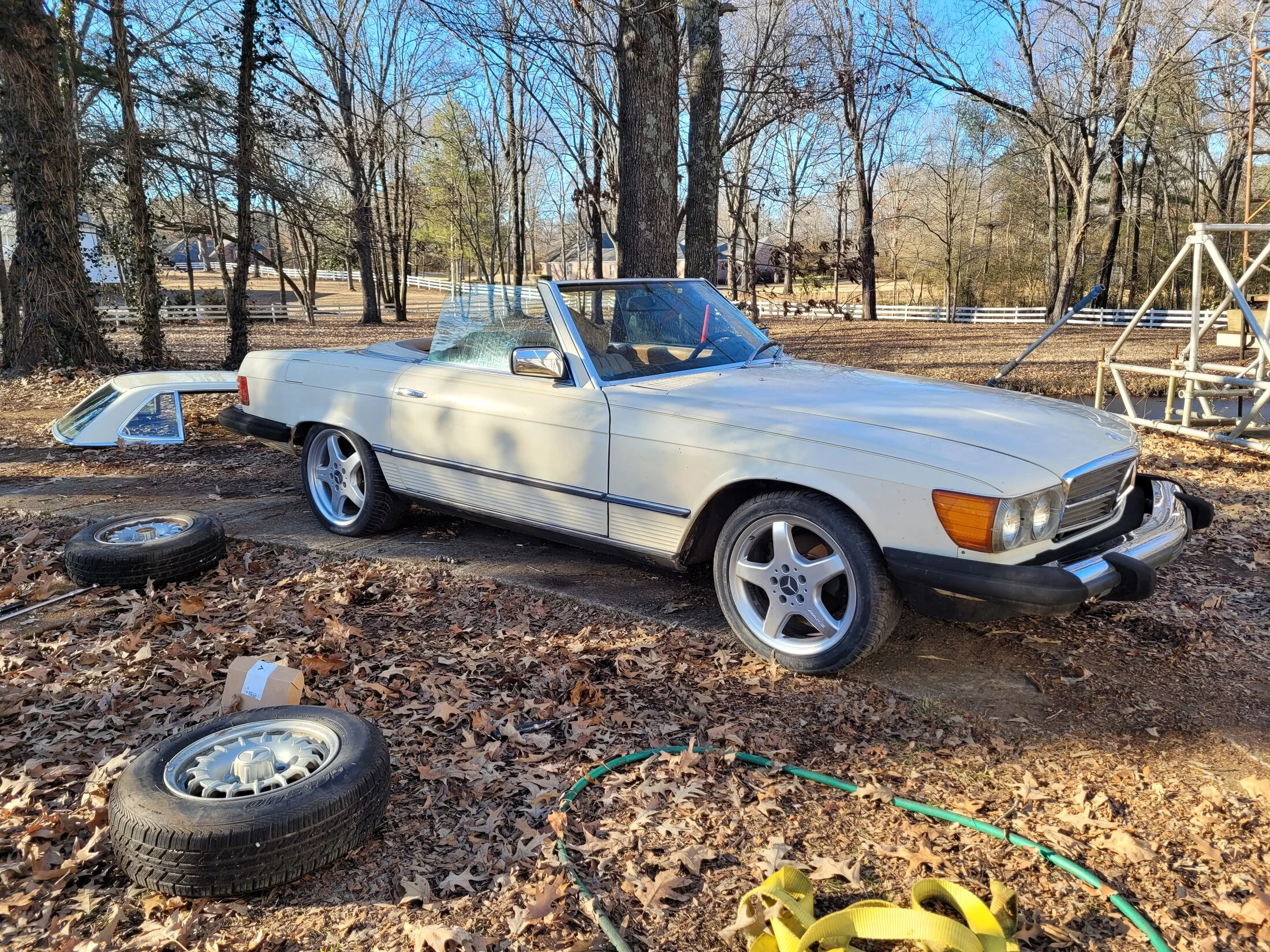

The AMG wheels came from marketplace, the same day I bought the car.

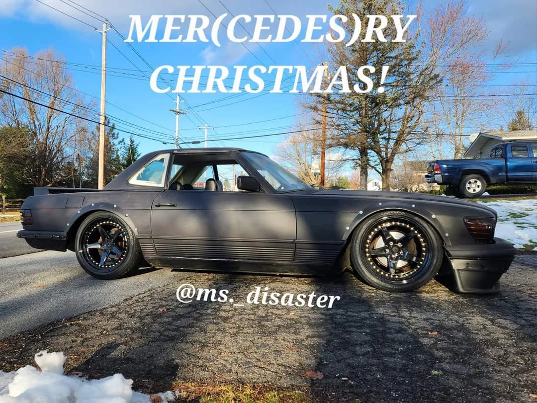

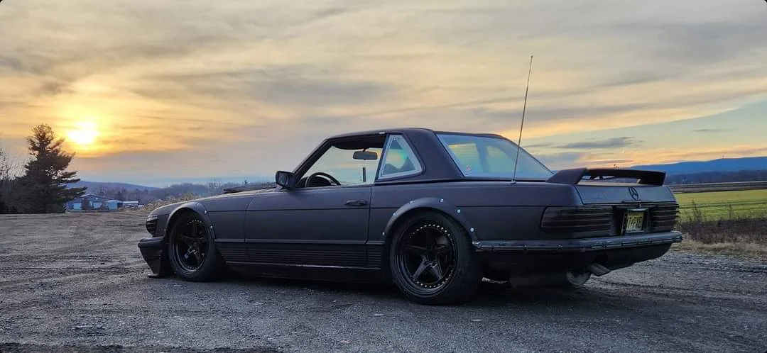

This car is along the lines of what I want my car to look like. I like the lowered ride height, tucked bumpers, modified rear valence (mine will hang down more) and quad exhaust tips

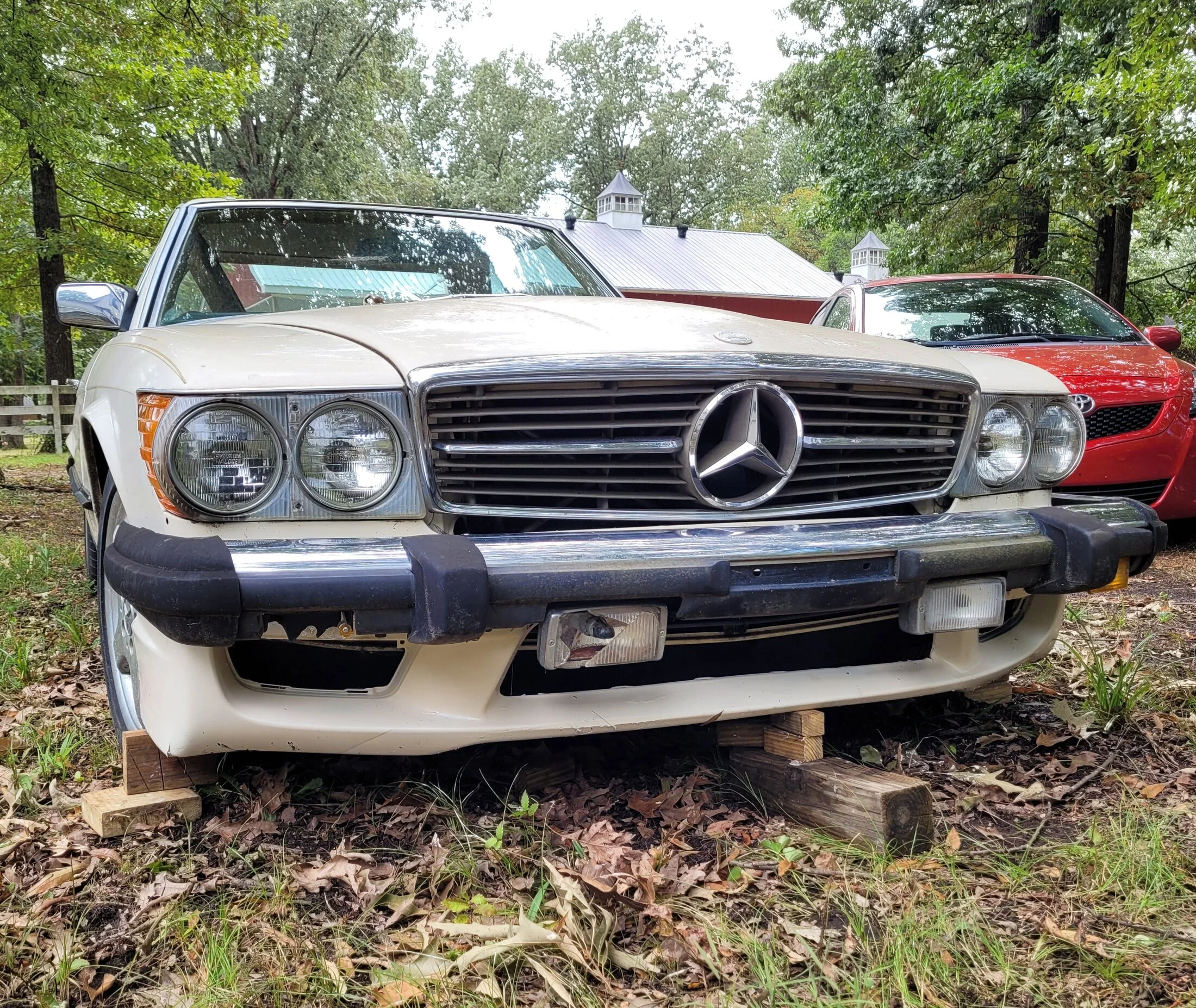

This one has euro bumpers. I plan on reworking the US bumpers for a similar fitment, but a little more substance. I think the euro ones are too thin.
Mine are gonna need a lot of love. Rubber end pieces are going to get fabricated from steel, tucked tight, and painted body color.

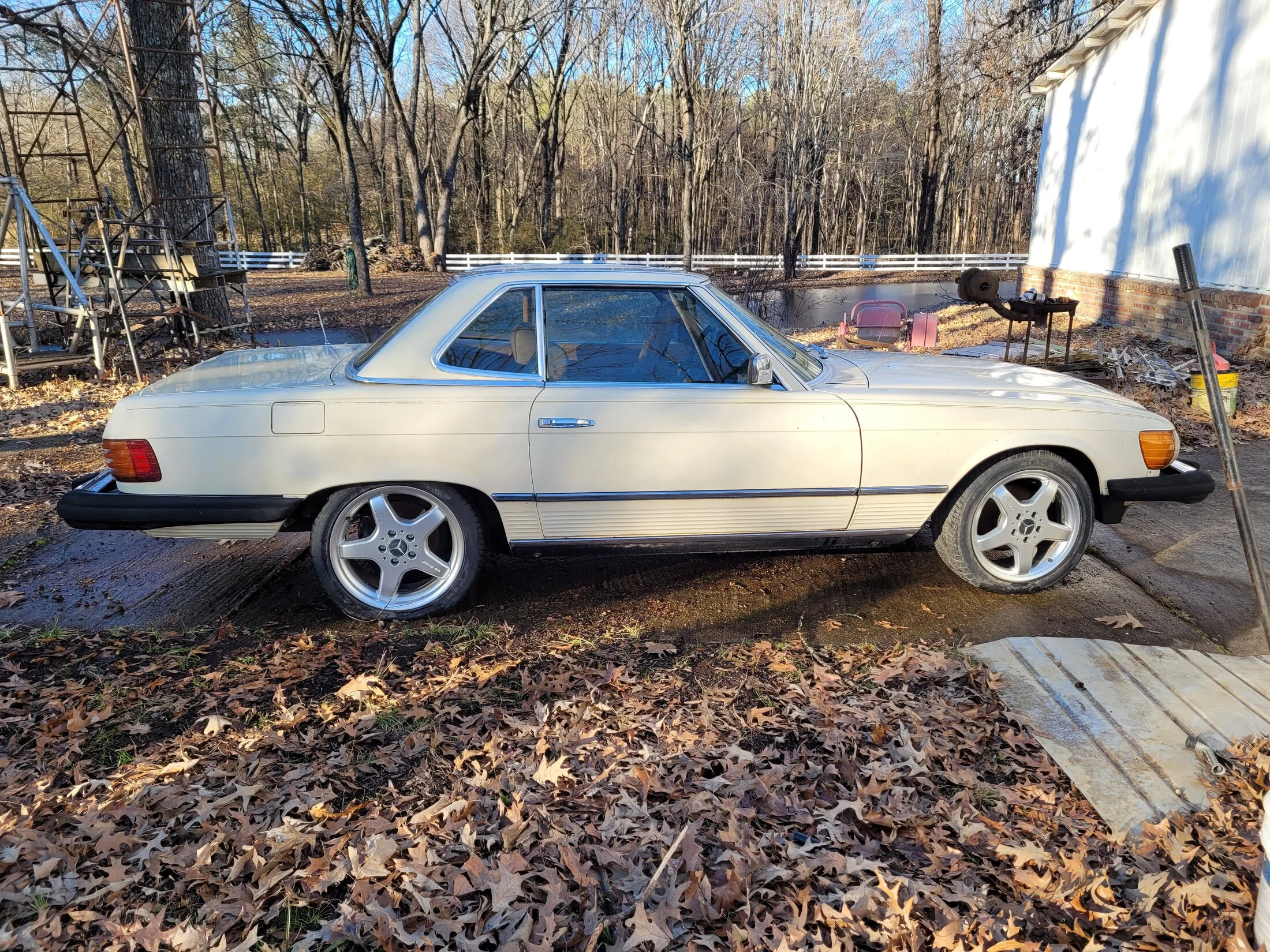

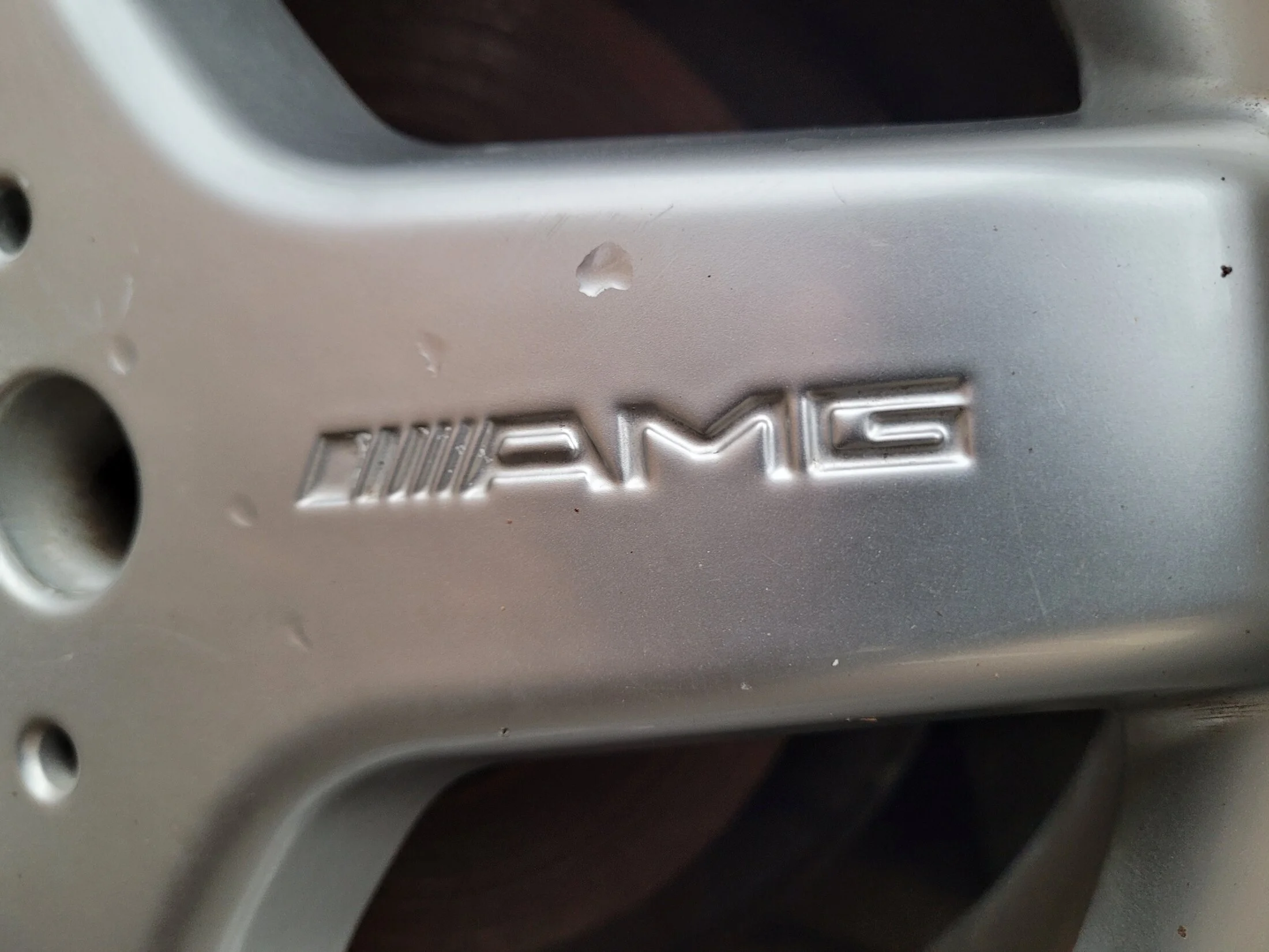

The AMG wheels look like they were made for this car. 17x7.5 front and 17x8.5 rear with room to drop the car down some. Amazed that I bought them for $200. They did wonders for the looks of the car. For whatever reason, mercedes guys don't seem to like the monoblock wheels with the long skinny spokes. I do.

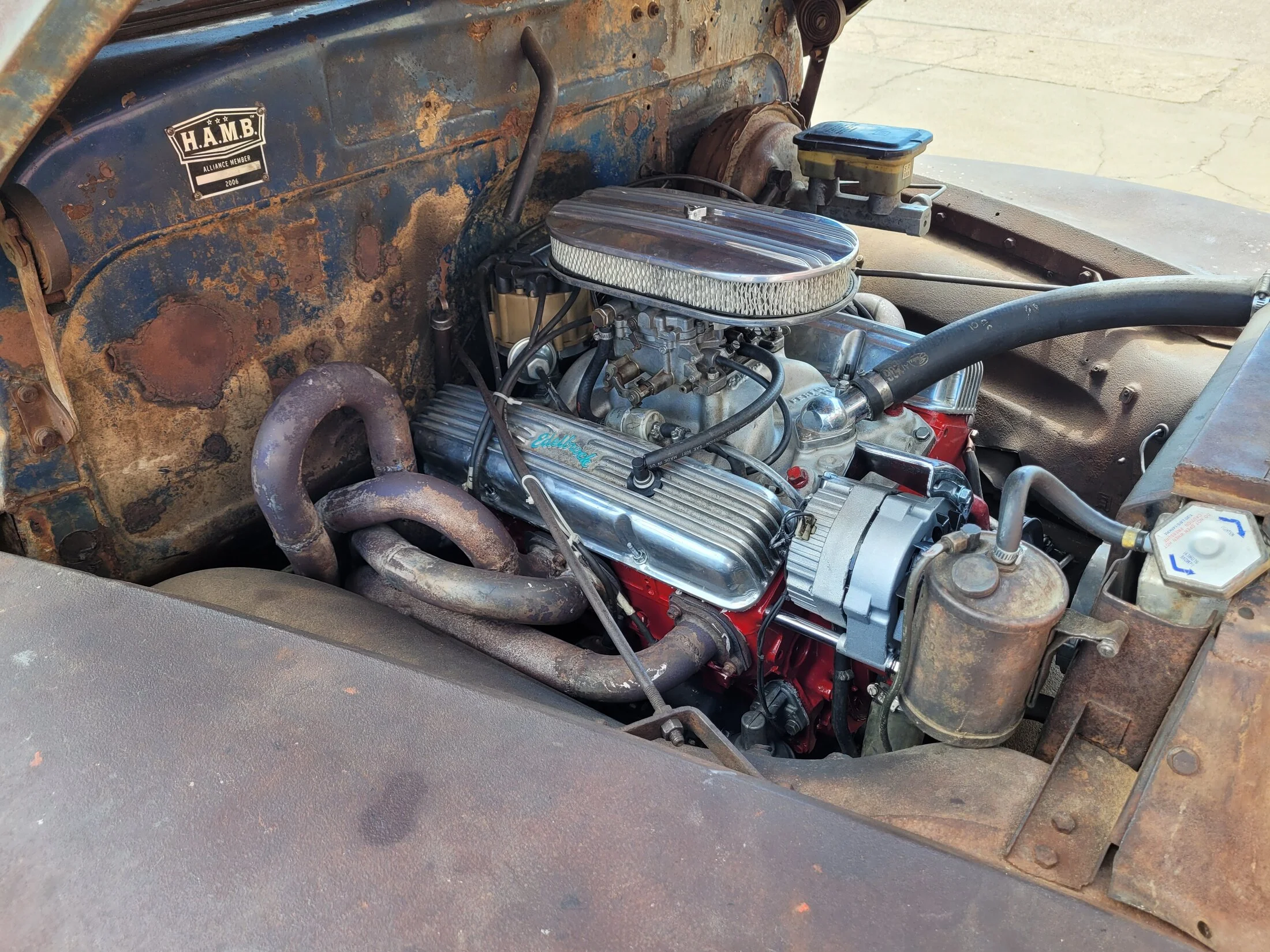

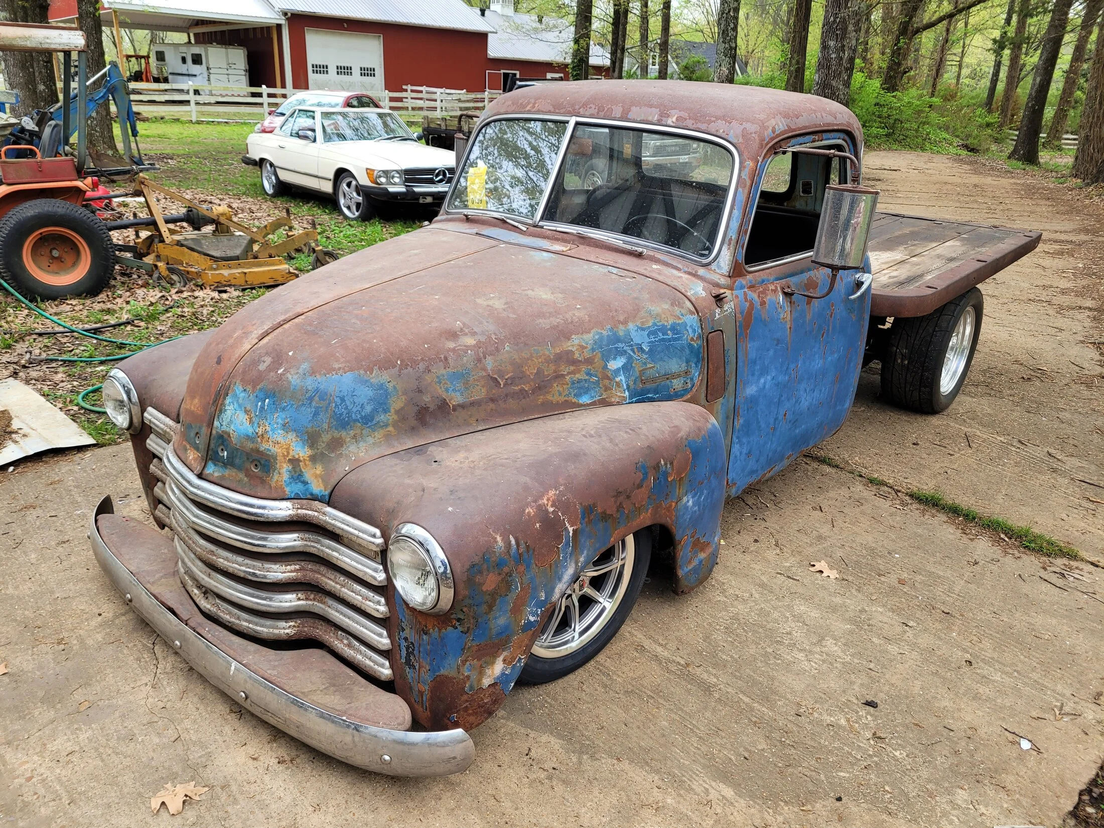

I'm a big fan of low stuff. Here is my 48 chevy rat rod. No air bags, this is ride height. ....around 3". I have driven it over 12,000 miles at this height. ...and yes, I have body damage from it.
On drag radials and skinnies.
Same truck on 20's
Just fabbed them. I used jeep cj5 body mount pucks. My body sits way lower than the kits. Rear suspension is stock height and front has a couple of coils trimmed.
The only thing goofy about the s10 swap is the radiator. I kicked the bottom of my radiator forward to clear the steering box and ran an electric fan. It's been fine for the last 17 years.
Mounting the body low makes the engine look taller.

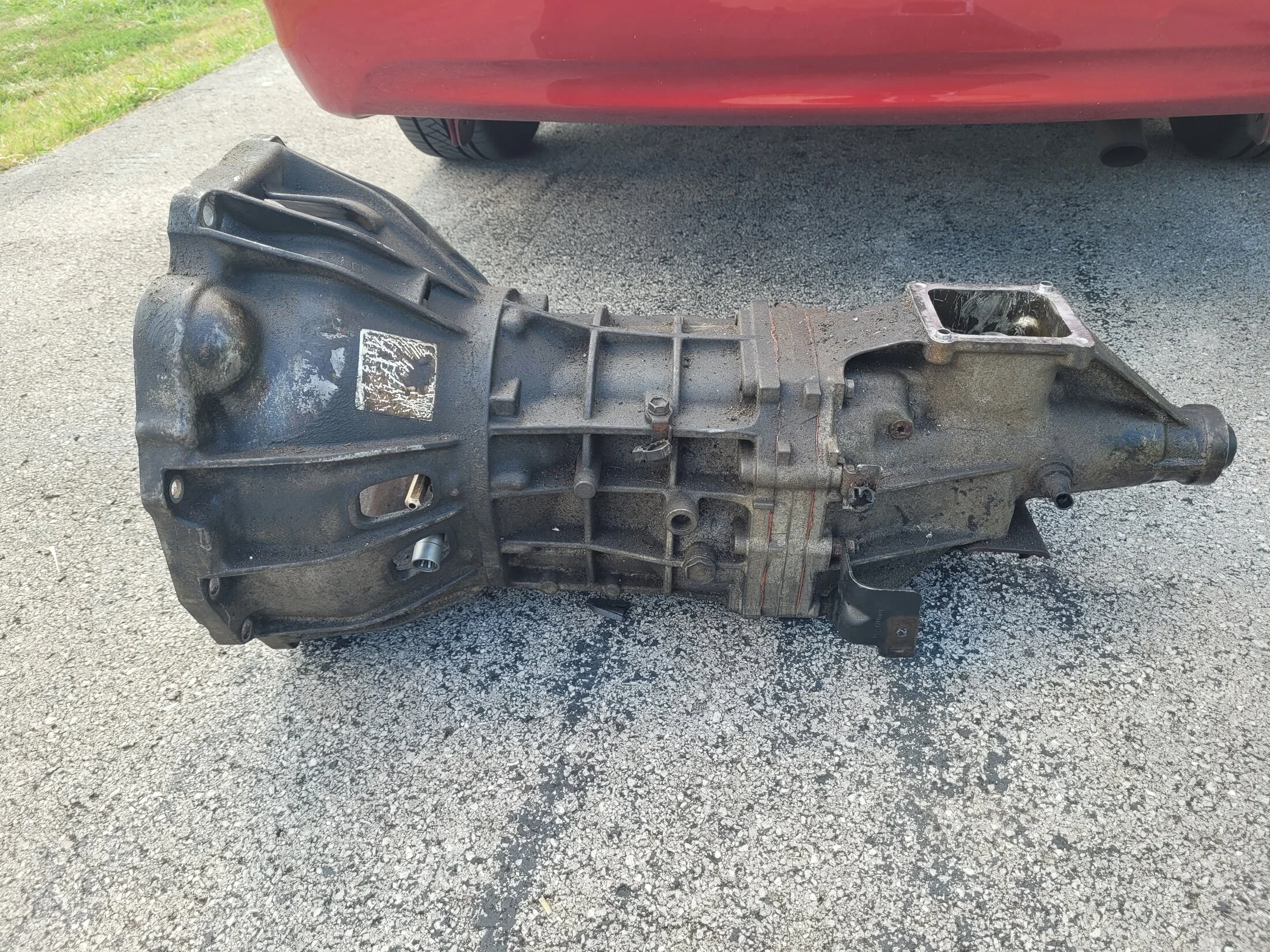

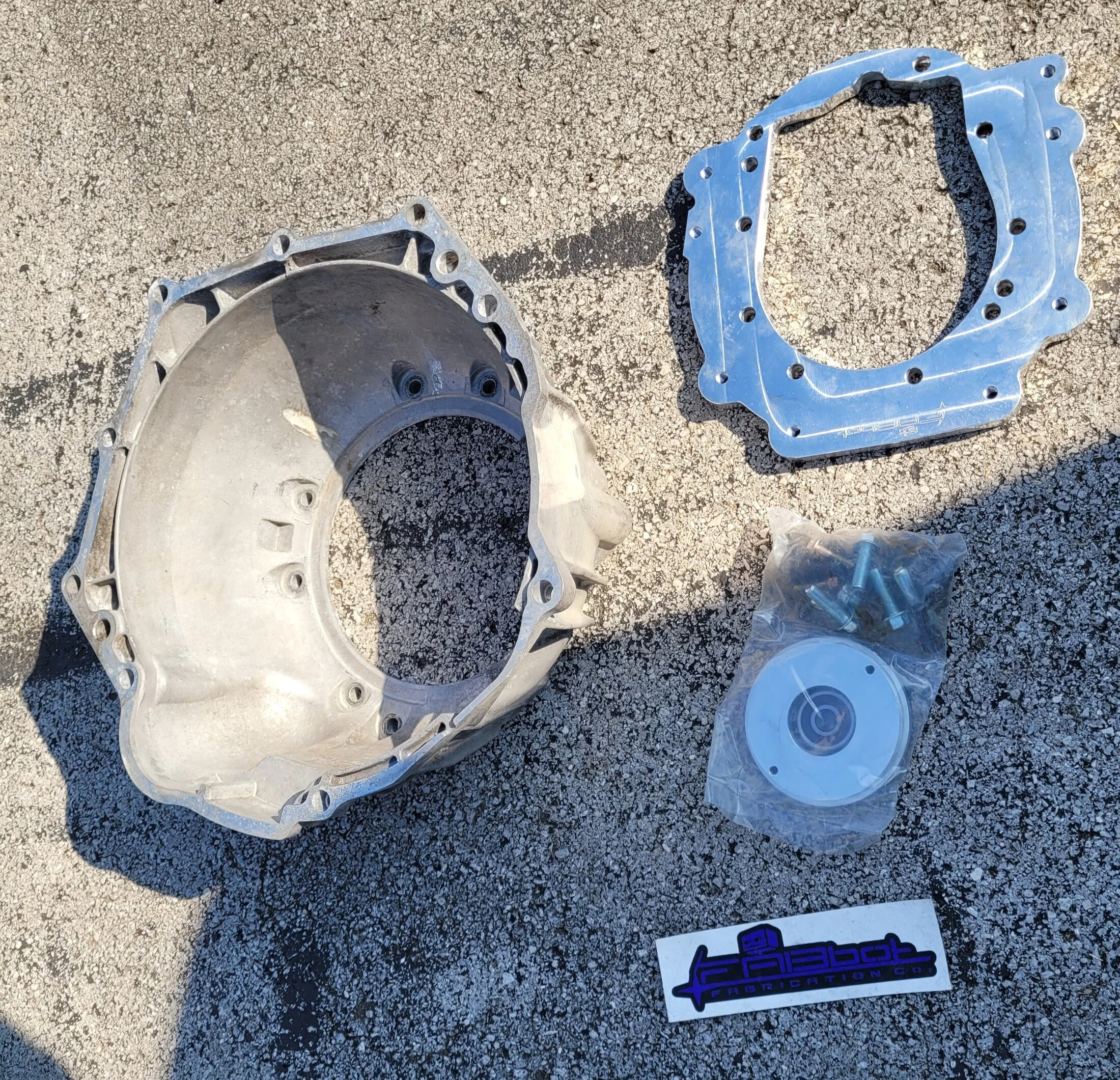

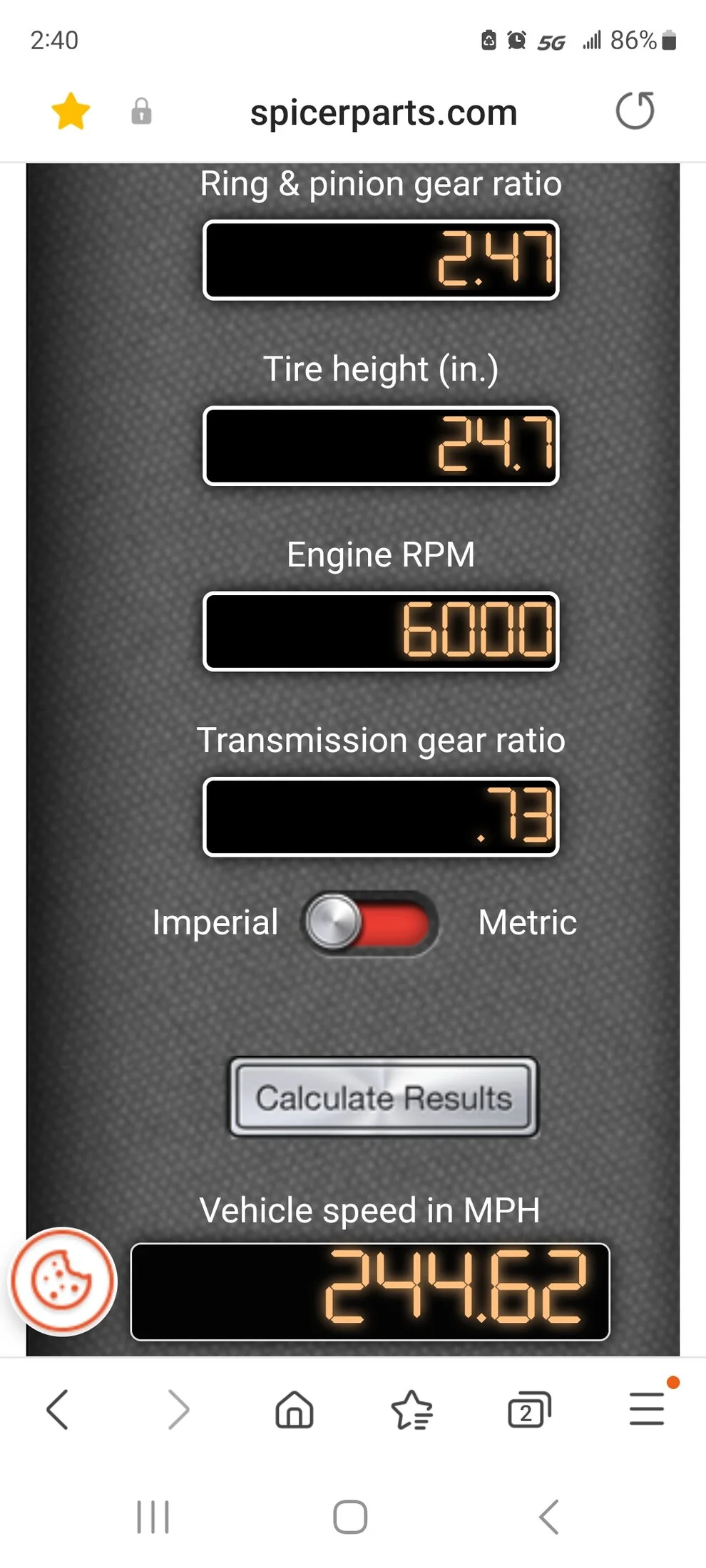

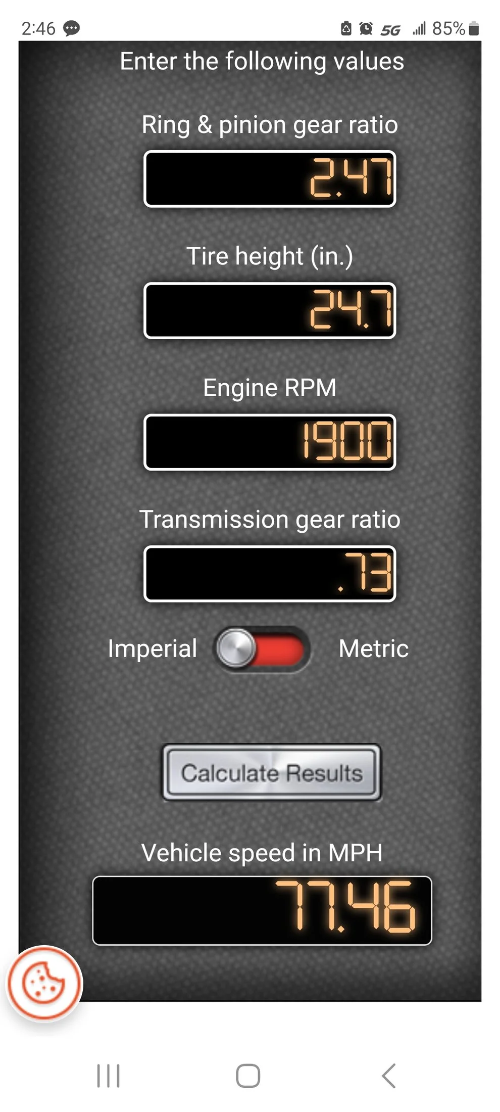

Today I bought a 5 speed manual trans to go behind my 5.3 LS. It is an AR5 from a chevy Colorado. Gas mileage should be pretty good.
And hell on wheels if I had a procharger.
Bolting the trans together and drilling the holes for the hydraulic lines went smoothly.

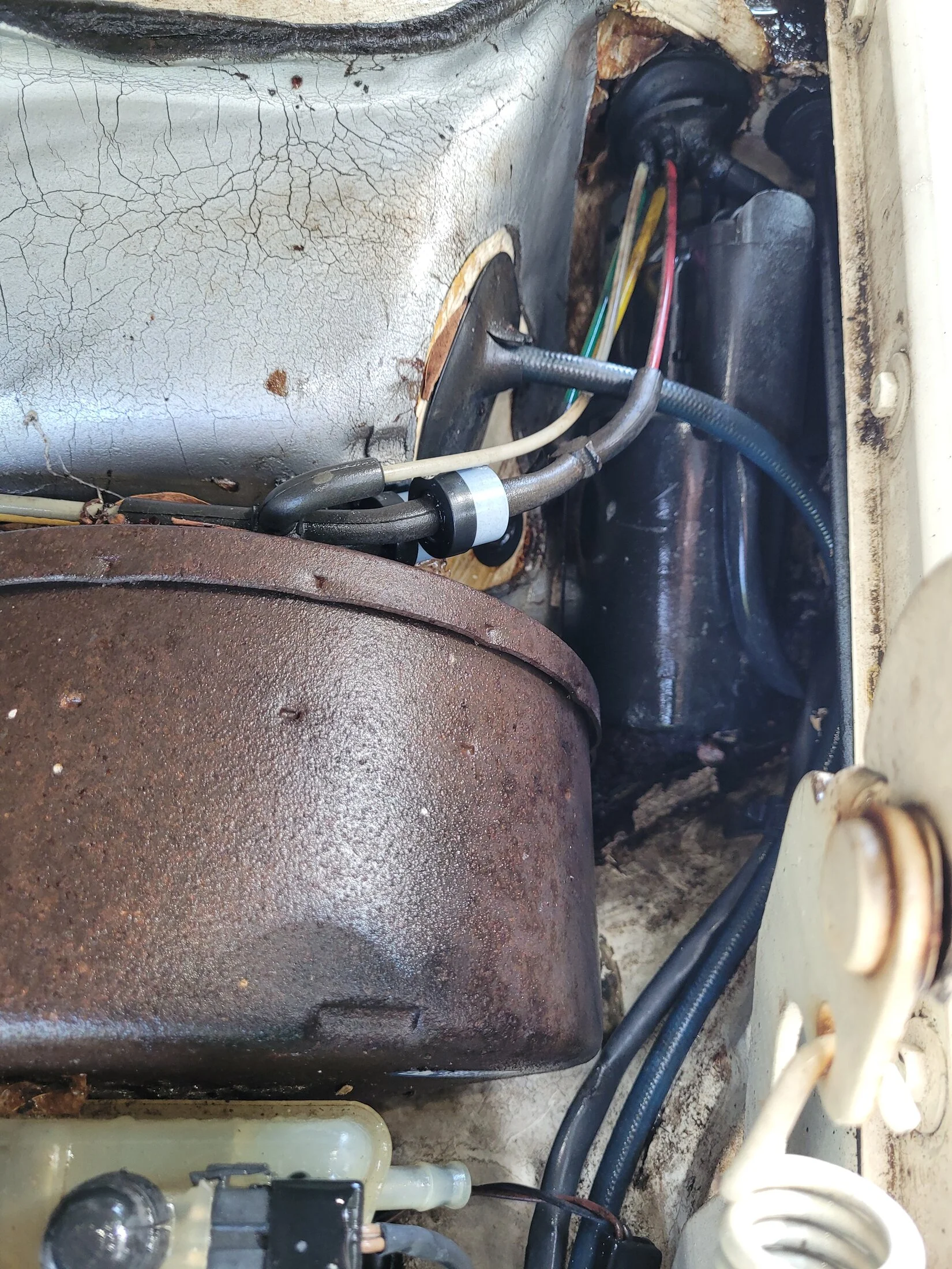

Finding room to fit a clutch pedal, not so easy. There is no room outboard of the brake booster. The wiper motor sits there. Wiper may get relocated and the firewall re-shaped for a spot for the Colorado clutch pedal to mount.

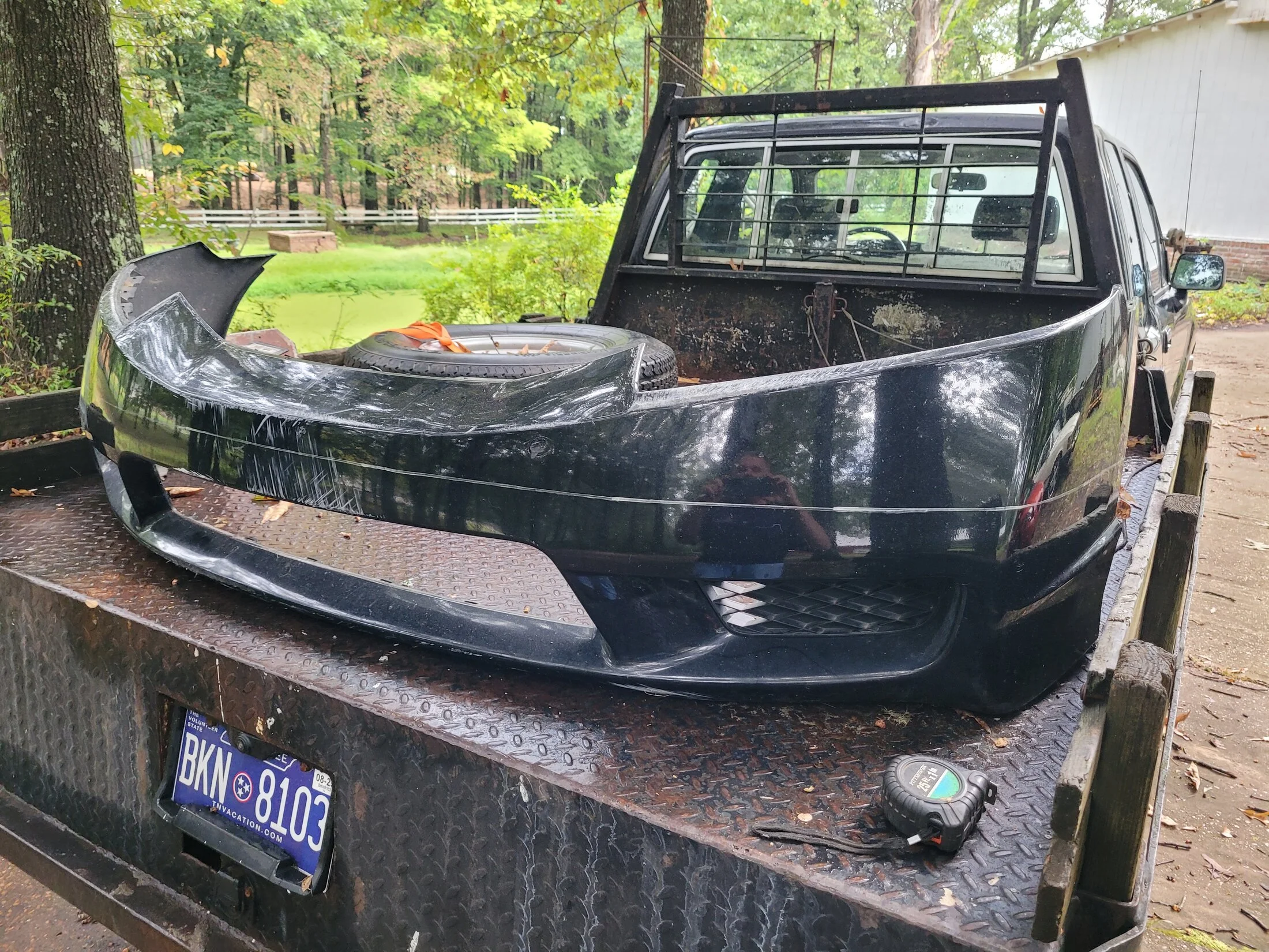

I also played around with making an air dam out of a Honda civic bumper I found on the side of the road.
I used to have a merc that came original with those amg monoblocks. The wheels look absolutely perfect on this body SL. I never would have believed it without seeing it! Very neat project and best of luck.
