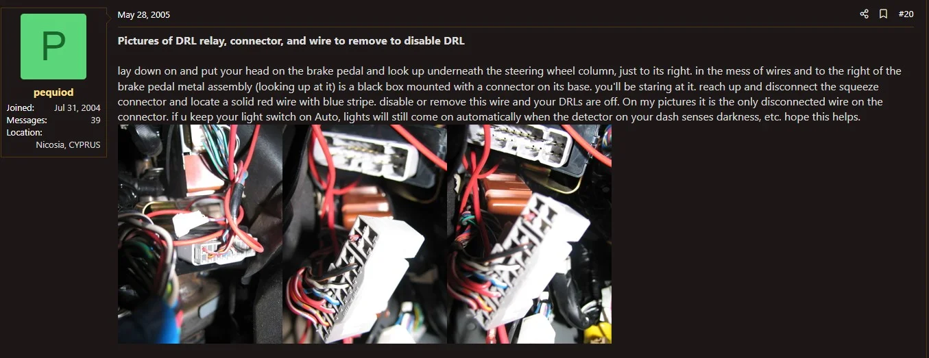

Want to do this trick below, but can I leave my LEDs in there, or do I need to switch back to the halogens?

I actually placed both halogens in the connectors for the high beam, replaced a 20A fuse which crapped out, and everything functions as normal. I just need to disable DRL, the absolute cheapest way. Did anyone perform the fix from the screenshot? I think I might just go back to halogens for high beams.
