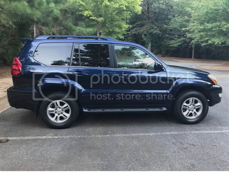

Yet another had boarded the Toyota/Lexus train!
It's an 06 gx470 with 115k miles. Belt and water pump were changed at 90k and it literally has a glovebox full of service records. It's the ivory interior, non-kdss, non-nav which I am SUPER pumped about. It feels like I found a unicorn.

Thanks! At first I wasn't looking for a Nautical Blue truck but it eventually started to grow on me. Now, I love it.
Welcome. I wish mine was non-nav.
I almost bought a blue one like that, but my silver one was free, so can't complain.

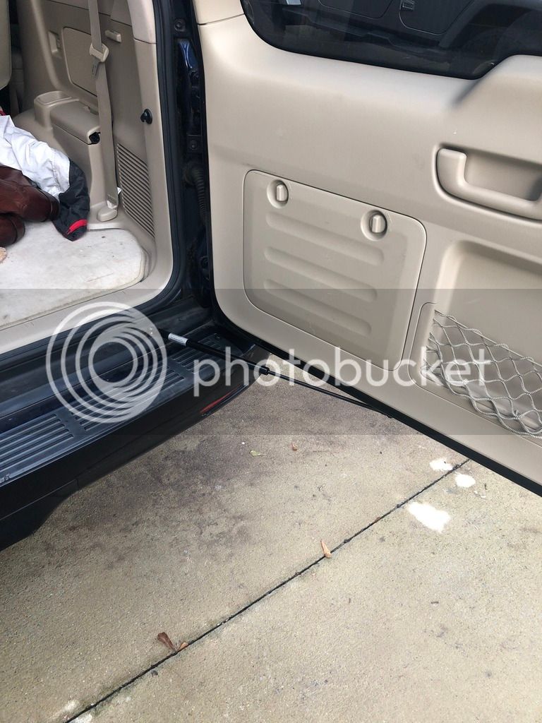

4) So I got tired of getting hit in the head by the rear door so I finally installed a gas strut. 1000% better than the stock setup.

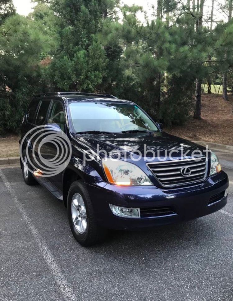

BTW, how does your truck look after the tint? A good tint + that color must look great.
