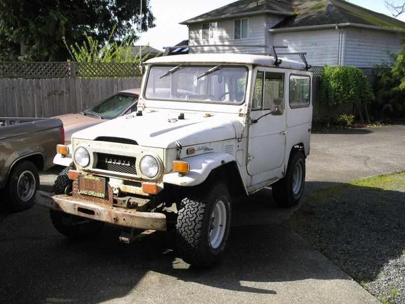

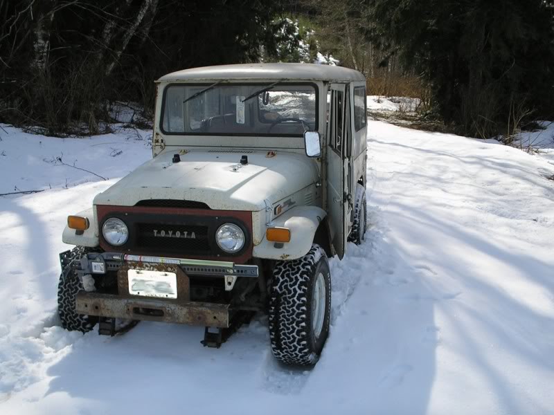

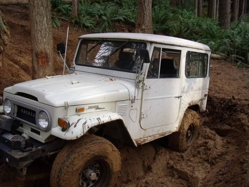

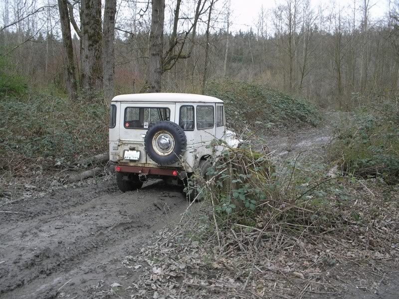

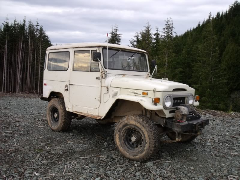

Newly purchased 1972 FJ40 for $3500. From a starving college student.

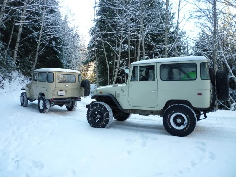

First thing to do was to take it out and play.

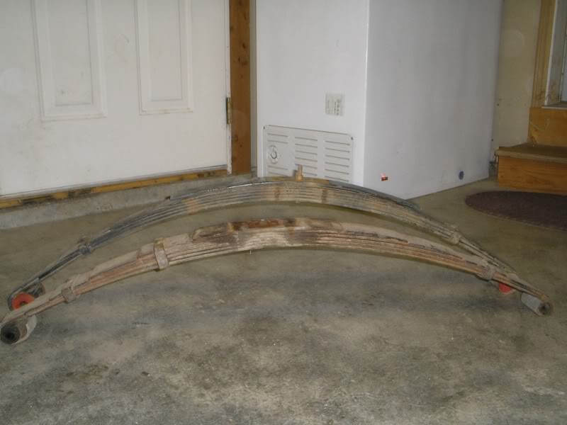

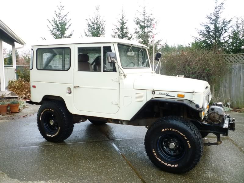

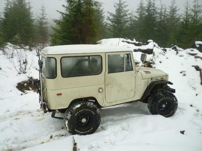

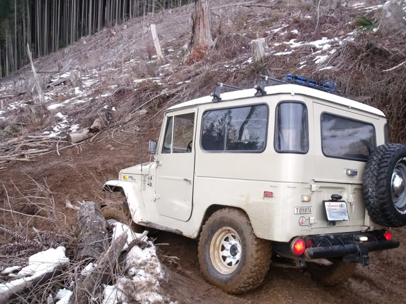

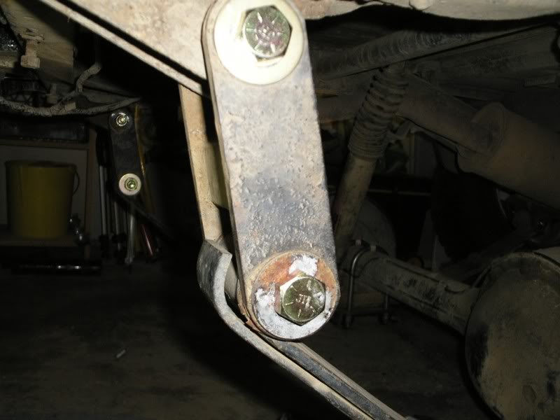

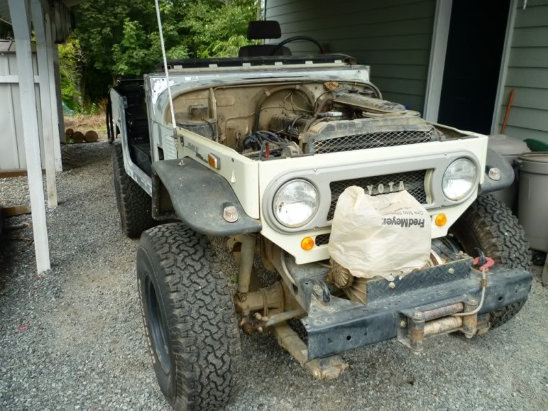

The cruiser did fine as is, but I found a good deal on some lift springs. So I added a 4” lift.
Comparison shot.

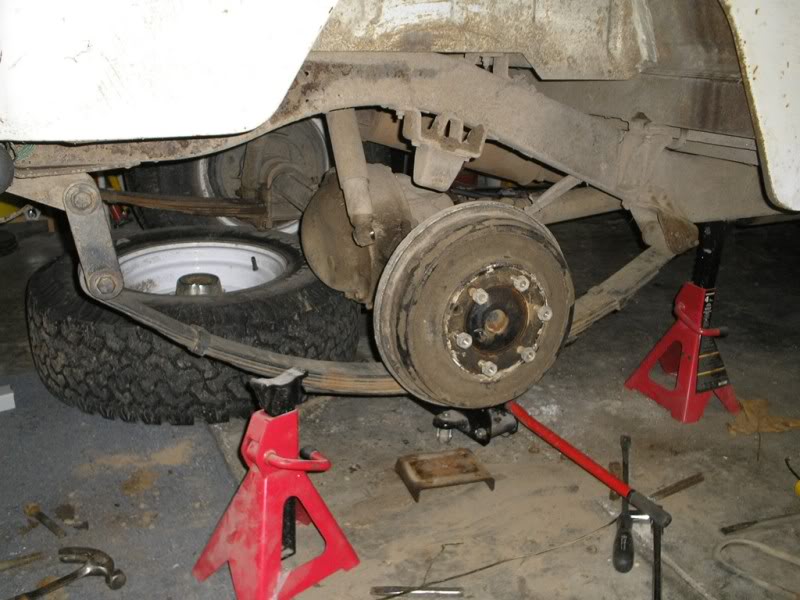

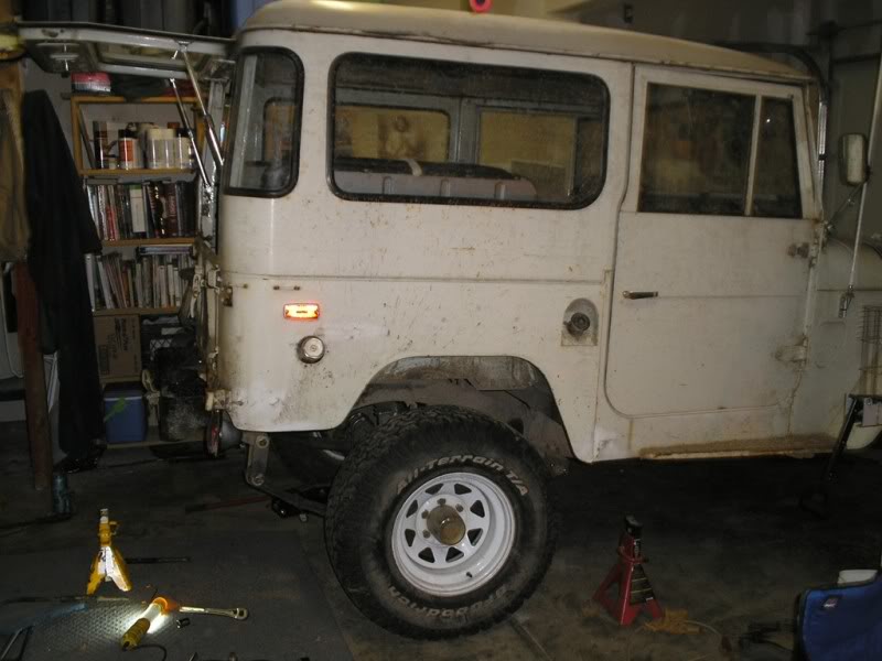

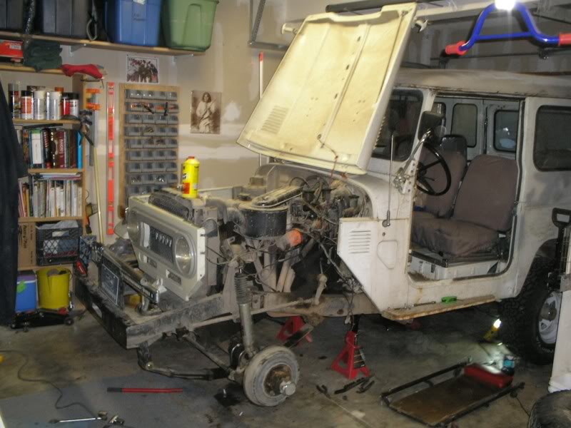

It was easier to remove everything.
I had these bent up locally.

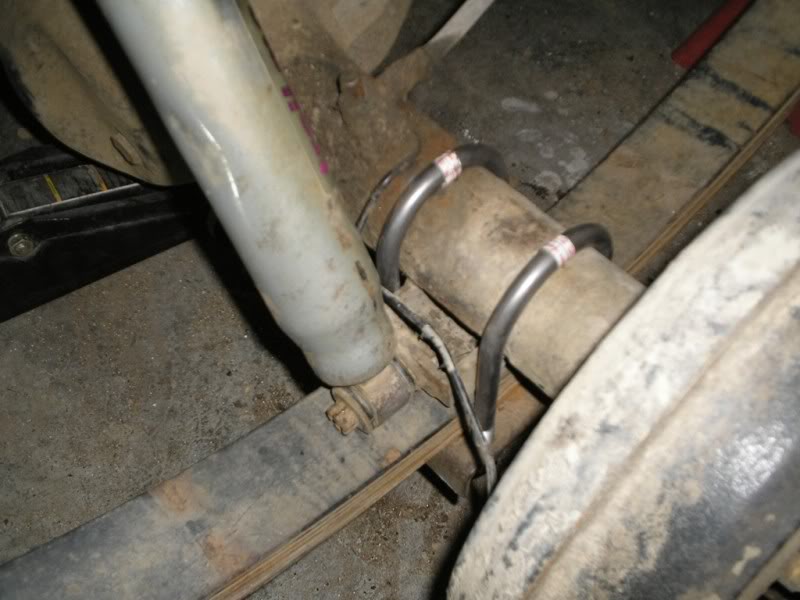

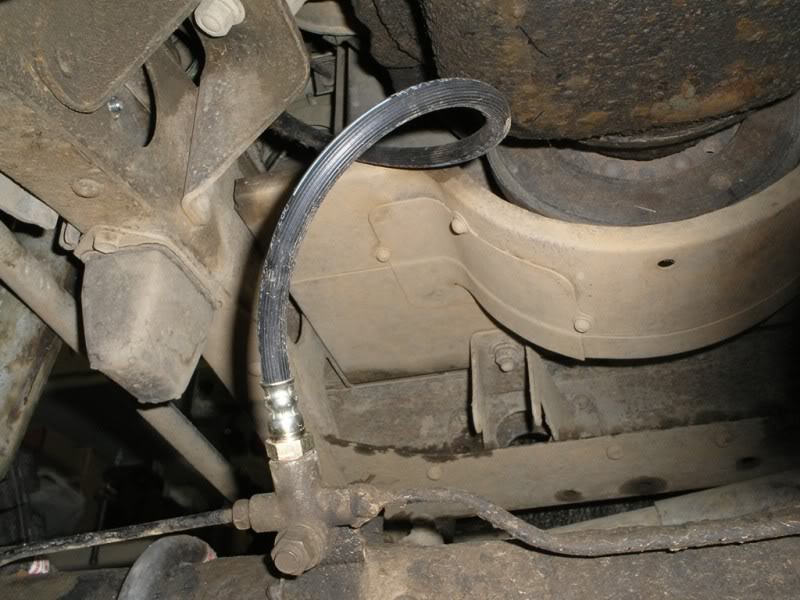

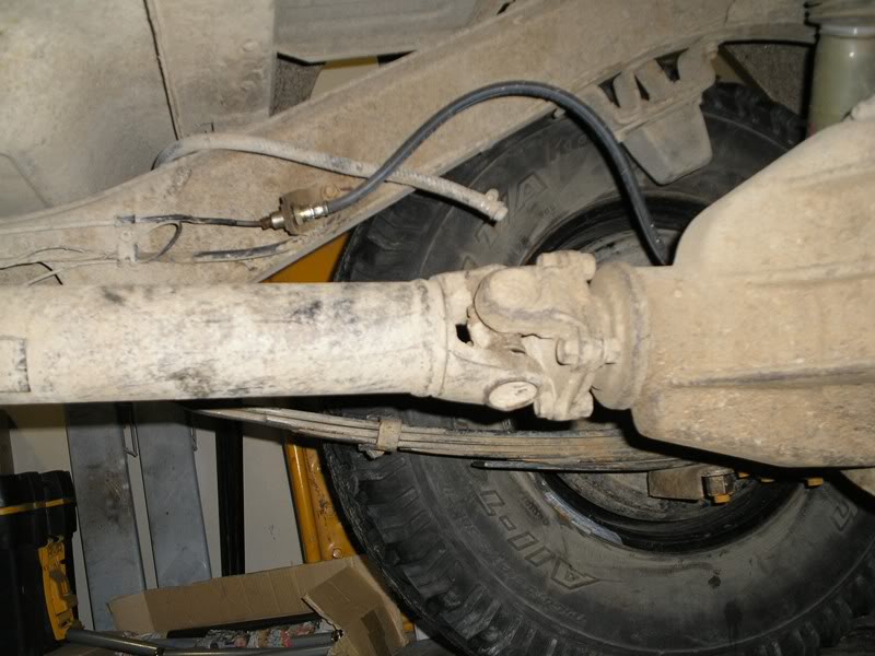

Had to extend my brake lines
Here it is back on the ground. Unfortunately I don’t have a "before" side shot.
Looking good. Was it a FST?

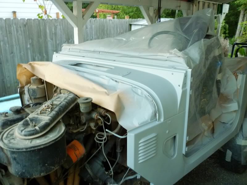

After fixing the fenders I went on to repaint the front end.

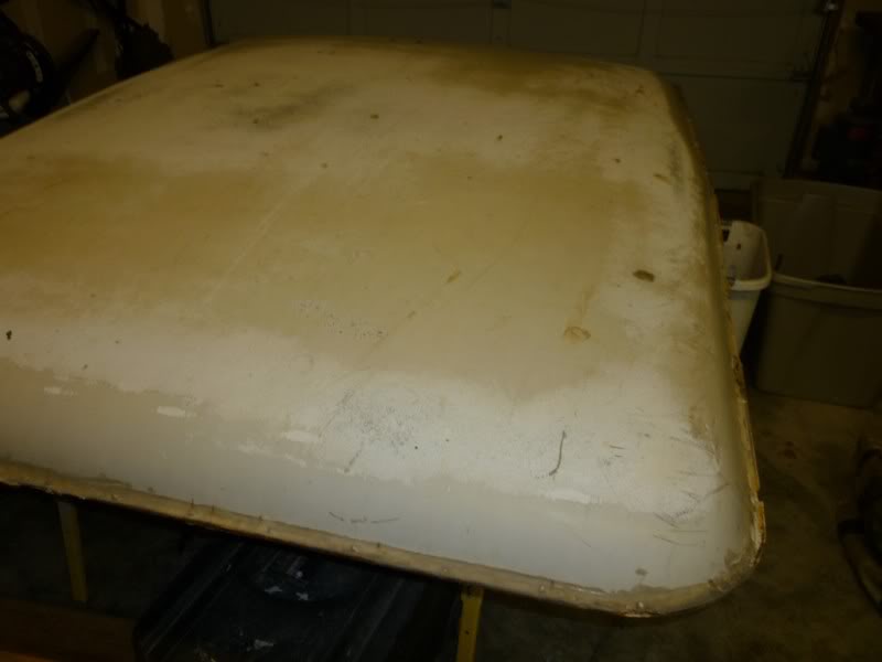

Here is the top of the hood sanded down.
I used a rust treatment spray on the bottom of the hood. After sanding down the hood and fender I decided that I never want to sand vehicles for a living. So I took the rest of my parts to be sand blasted.

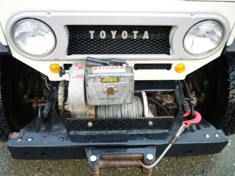

I did some searching on CL and found a good deal on a Warn 8274. Brought it home and cleaned it up. As with most things I need help with, no one was around to help unload so I had to use a winch. This thing was welded to a heavy duty Ford bumper.
It was pretty corroded, but cleaned up well and has been a great winch.

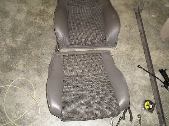

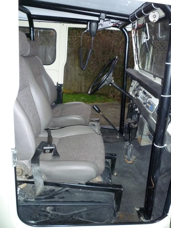

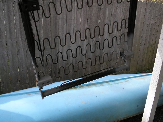

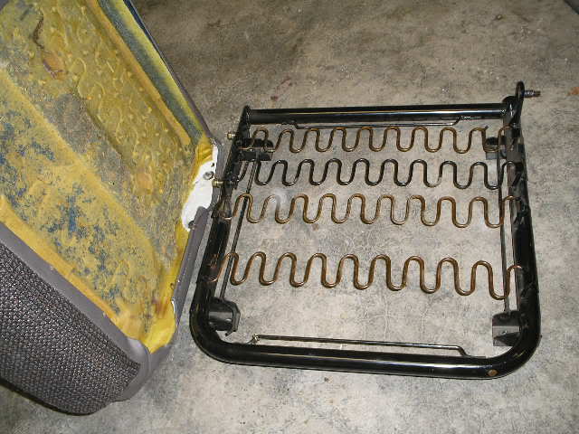

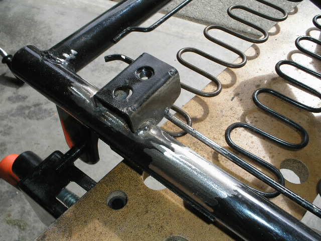

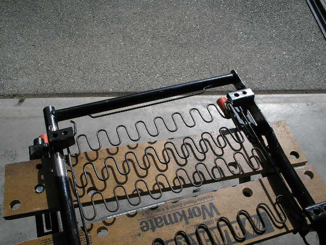

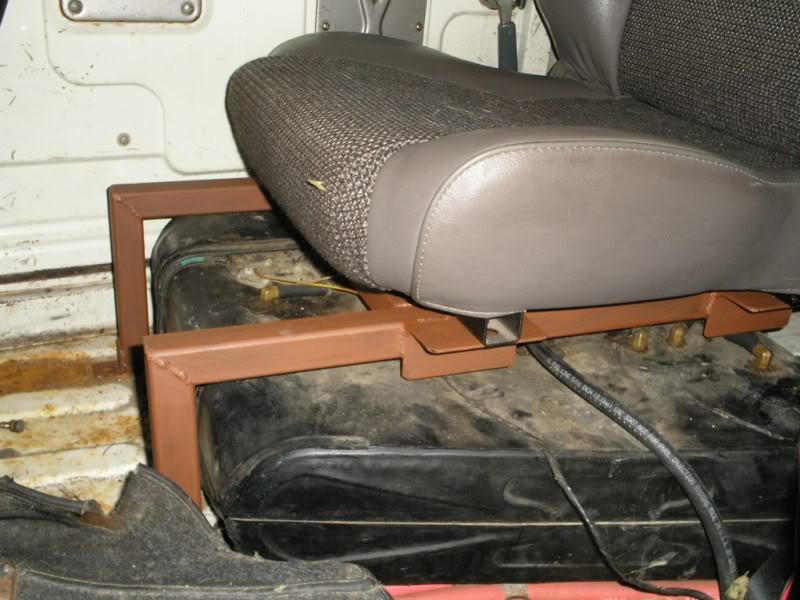

I found some front seats out of an early 90’s Isuzu Trooper, then fabbed up some brackets to fit them in without removing the stock fuel tank and storage compartment. I am 6 foot tall and still have plenty of room above my head.
I just used some 1”x 1” and angle.

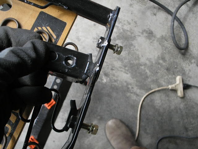

I did have to mod the drivers seat to get it to sit lower.
Test fit.
Drivers side was easier. I used the existing brackets and slides. Then made a simple frame for it to mount to. I am also able to get into the storage box.

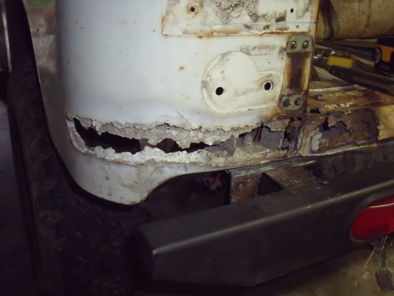

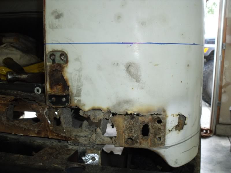

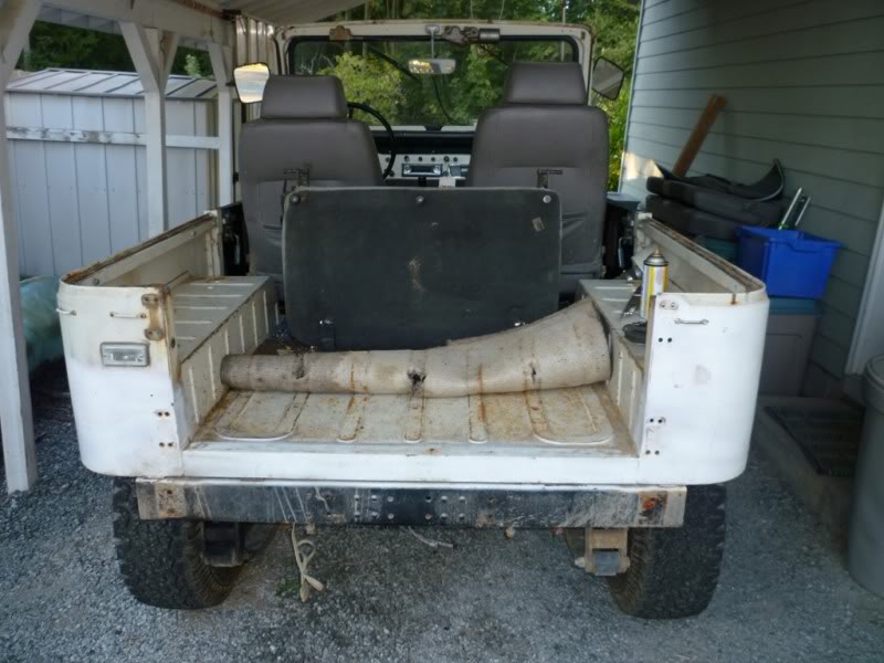

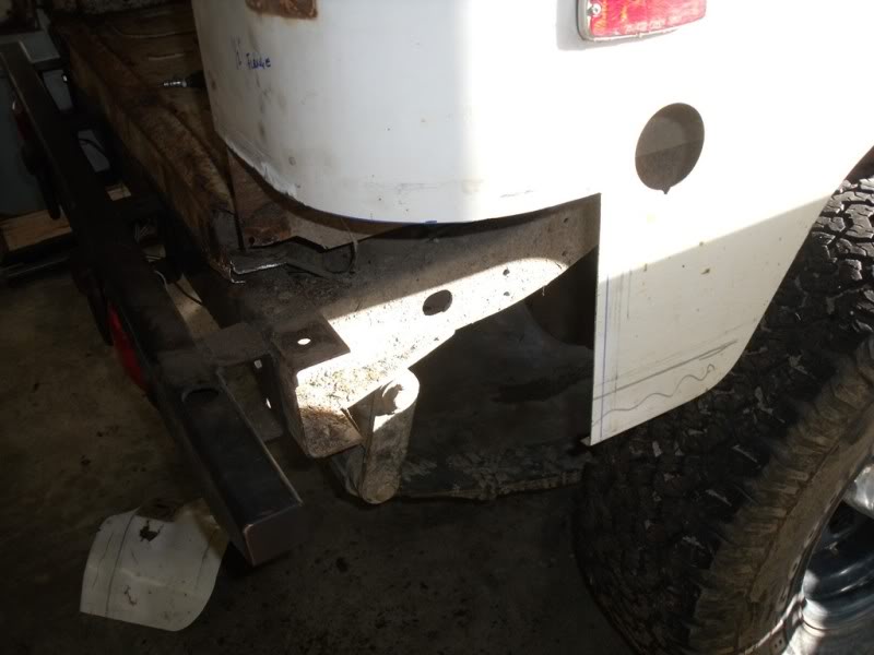

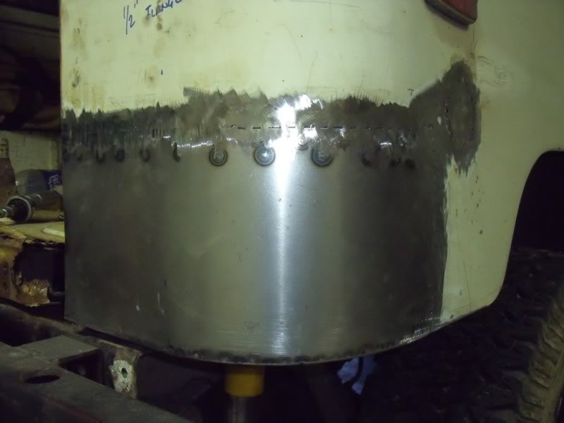

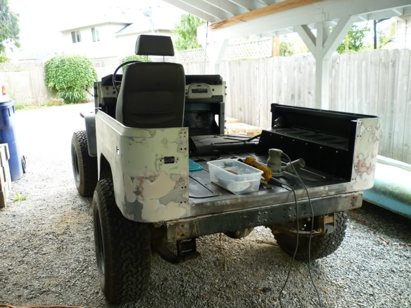

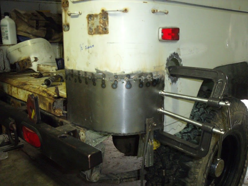

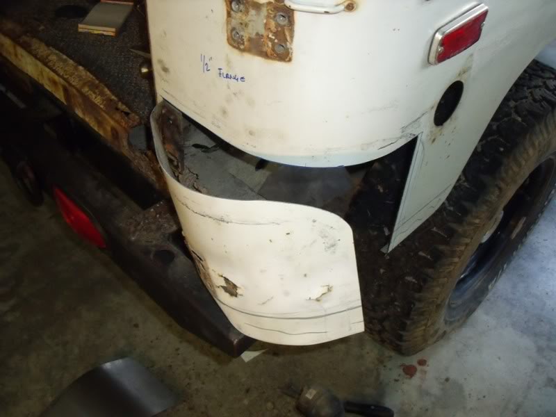

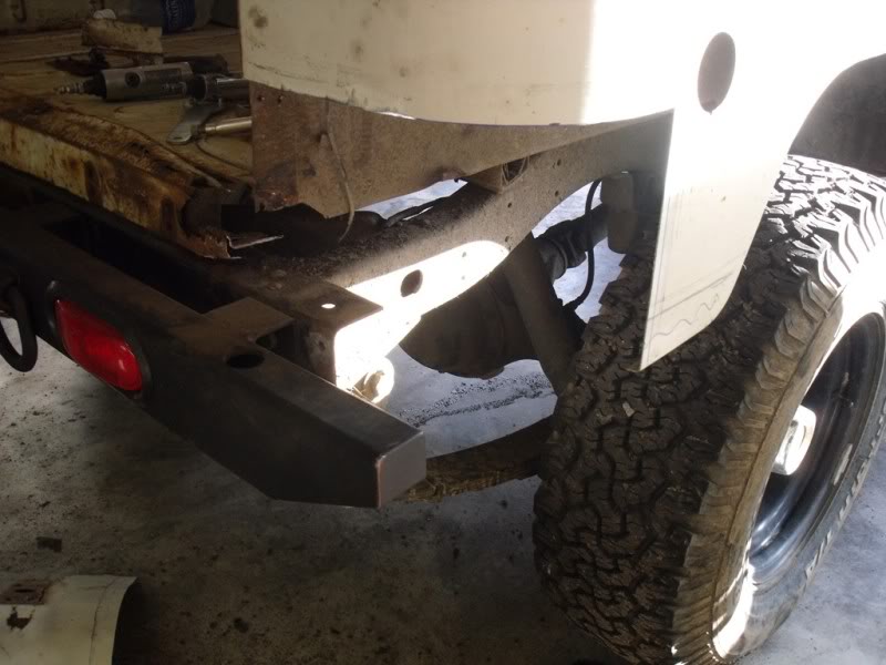

It was time to address the rust issue on the back panels.
This was a Montana cruiser so the rust had eaten thru pretty good.

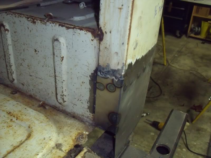

There was no turning back now.
I welded on a strip to reinforce the new patch.

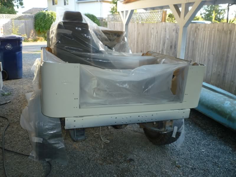

I decide to fill in the spare tire holes and soft top loop holes while I was at it.
I didn’t take pics of the sanded and primed part of that project. I got lazy.

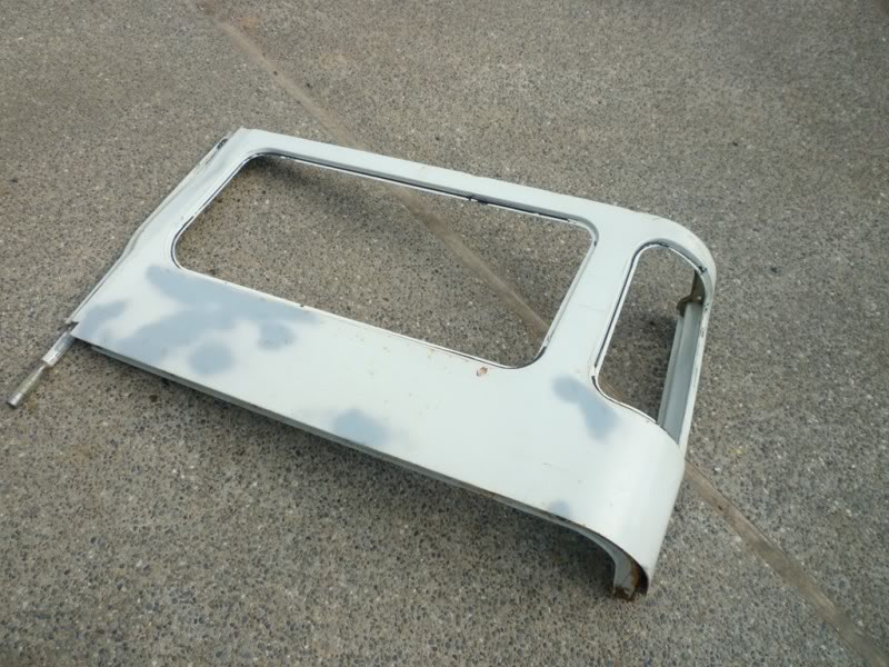

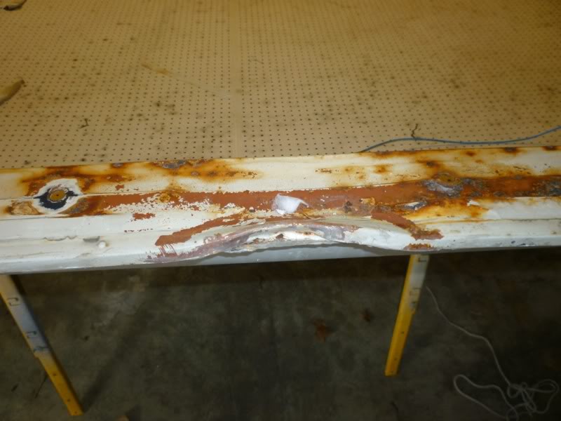

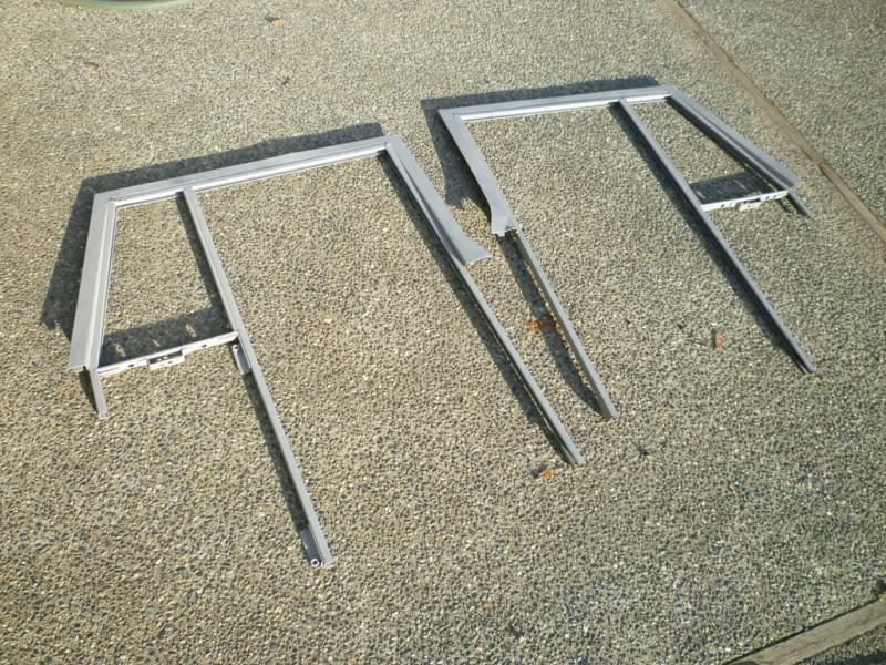

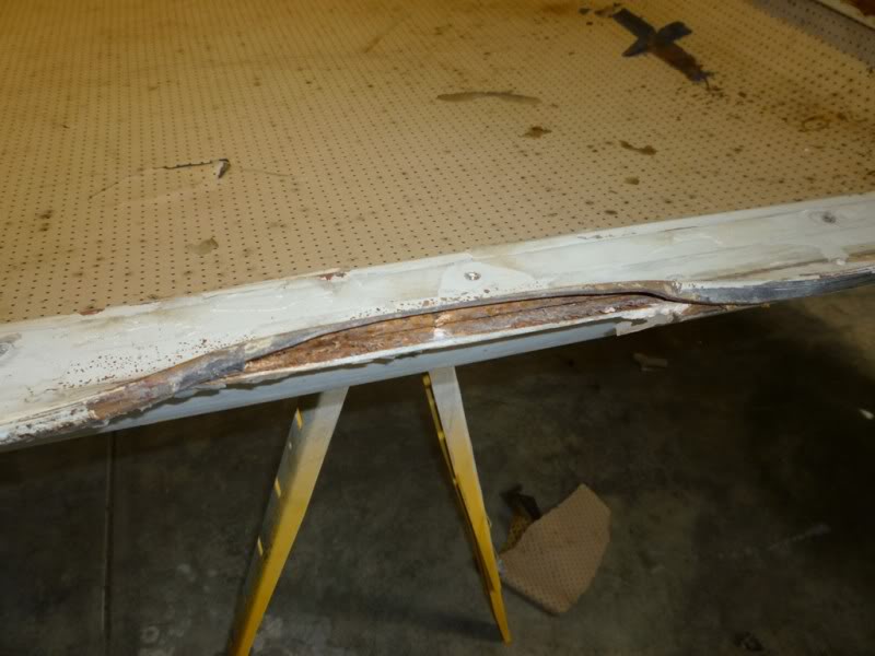

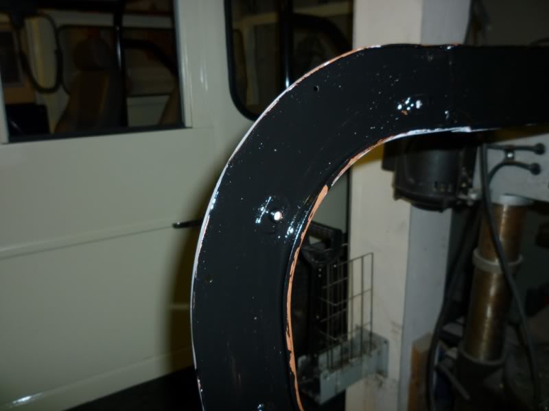

The top was next since I destroyed the rain gutter on a few trees. Fortunately the rain gutter had very little rust under the cap. So I hammered out the dents and reshaped the flanges.
This was folded over my door. I had to use pliers to bend back up so I can open the door.
This was the trees fault.
Another tree.
This thing was in bad shape.
After sandblasting the rain gutter and reshaping it I painted it with a 2 part rust preventive paint.

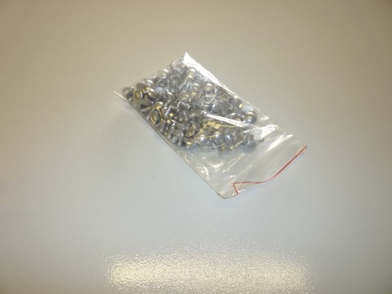

Rivets from CCOT.

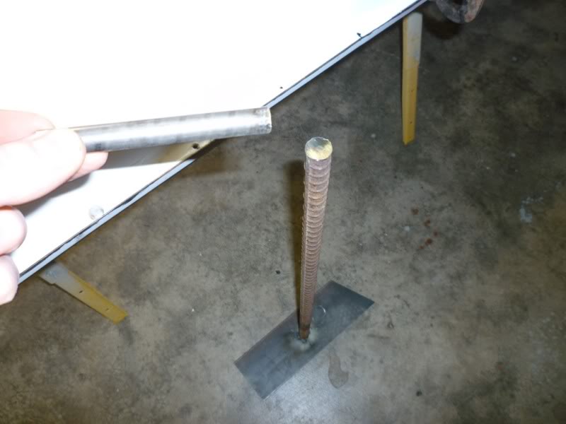

Homemade tool to install the rivets.
First one…. 150 or so to go.
Here it is ready to put back on.

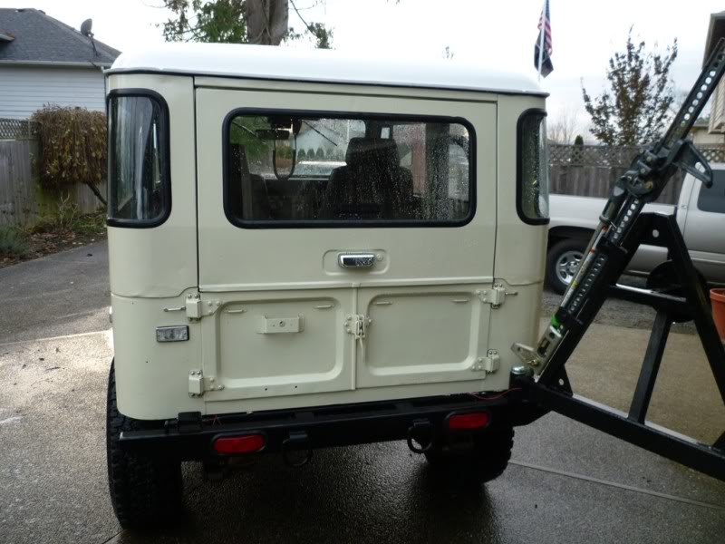

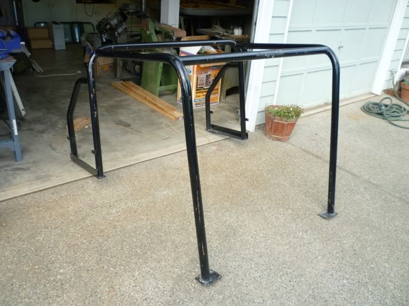

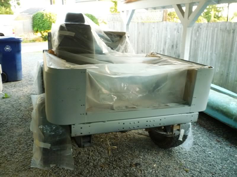

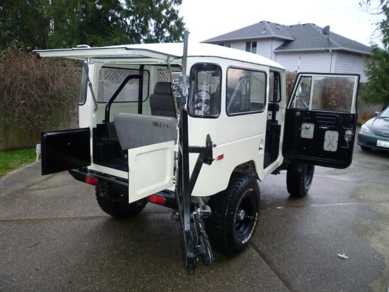

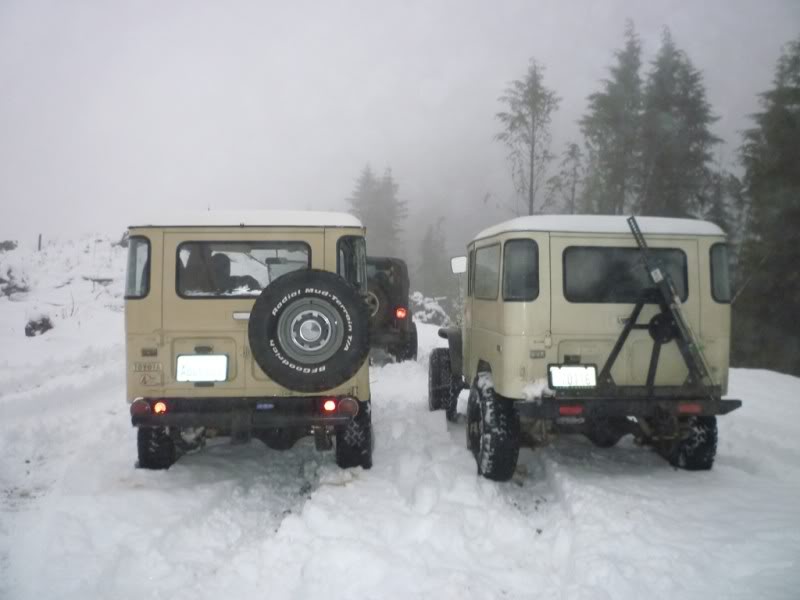

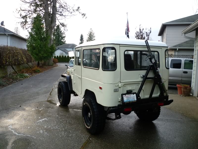

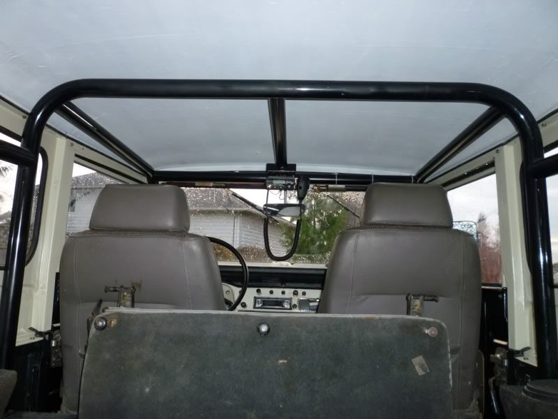

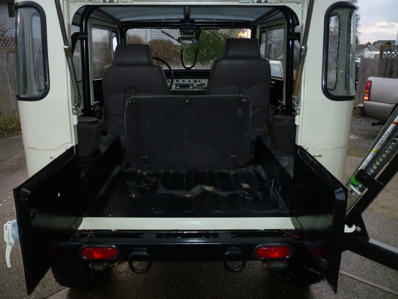

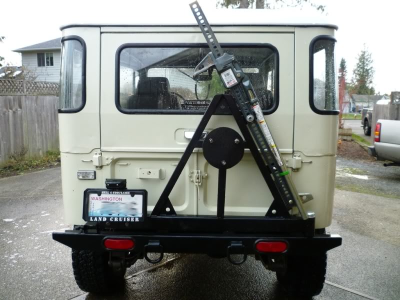

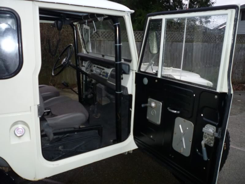

While the rig was apart, I added a full roll cage, painted the interior with bed liner type paint. Then put it all back together. I also finished up my swing out rear tire carrier.
New bumper coming soon.

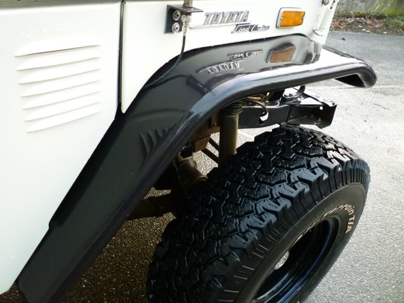

Metaltech tube fenders.
Future plans include power steering, disc brake conversion, new bumper and whatever keeps me busy.
