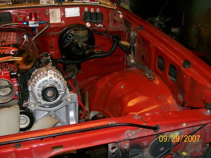

Fuel lines and start of harness
Sorry guys here are some more pics the fuel lines are done. Just need 2 connectors. The 20 ft of line was exactly enough. Also the harness is almost set and cleaned up. I haven't mounted the ECU yet. I have to secure the harness under the truck first. Just have to have my muffler guy check to make sure I don't put anything in the way.

ECU mouont and DS harness
OK here is how I ran the ECU. It will be mounted under the back seat. The harness length for this is 6.5 ft from the rear of the engine. For those who order an FIS harness. The hole is 2 1/4 in. and make sure you put a grommet over that. I just need to secure the harness under the truck and I will be good to go.

OK the harness is in. Need to make 2 connections and then guess what?...The tranny has the wrong pin connectors for the controller!:mad: STUPID STUPID STUPID!!!!! Now I have to get the correct connector and repin it. My bag I should have told Jeff what controller I had. But no big deal.
Oh and thanks Scott... I have to get the drivelines on Monday and the radiator is ready. Just need to pick them up and then finish off the little stuff. I still need to pick up a couple items I will get with you on those. Don't work to hard today. Hope it is slow all day:beer:

I get where the fuel pump goes what's that other item on top of the fire wall?
That engine bay looks soo empty now..
Scott, guess now yah going to have to fill all the empty spots with goodies eh !!
Double battery set up, Air compressor, Air tank...bla bla bla bla bla bla bla...

Hey Frank, What are you working on today? The thing on the firewall is a fuel pressure regulator with a built in return. You will have to have this. Any engine after 03 will need it since it has a returnless fuel system. It will maintain the 62 psi you require and gives you a return line to the tank. And yes he has alot of room for added on goodies. If you look all the wiring is inside the fender well. Have you ordered your harness yet?
I see lot's of possibilities for all that space, but no immediate $$$ plans. I'll just have to live with the wide open engine bay for a while. But,,,,,, it does make it easier to see the motor, which is nice!
