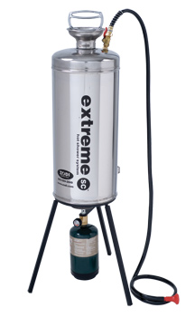

That's like a miniature Zodi Extreme shower
I think this one holds like 3 or 4 gallons but not sure....
At about 5 times over the price of yers...
nice economical set up for sure!
Thanks MaNu-
The Zodi was one that I looked at getting, but the size, price and all the accessories you had to carry with it kinda turned me off. Although, they're a very nice piece of kit.
