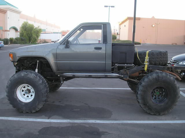

Finished pics of the truck
Ended up going with some 38x15 swampers grooved. And when I ordered the wheels they screwed up again and now I have 2 white wheels and 2 black wheels. UPS took forever and the driveshaft was supposed to be here friday and never was. I ended up making one and didn't have the right flange for the transfer side and the calipers were leaking and wouldn't seal. I ended up picking up some at the junk yard and went to register it and went wheeling.
