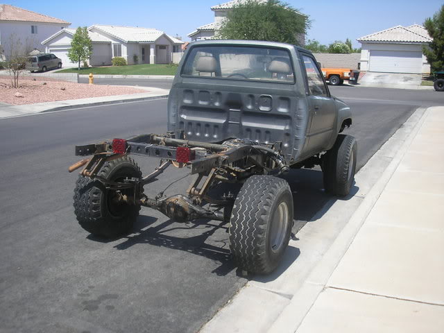

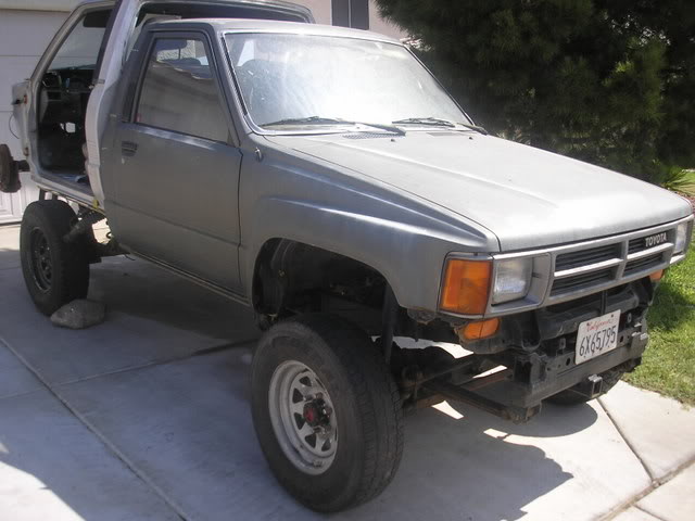

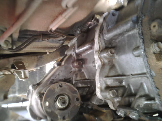

Well my bro traded his 4runner already. He was going to swap running gears but ended up trading for some toyota truck thing. Here's some pics when we got it home. It came with an extra cab on the back and we took it with the truck. anyone want it? It came comeplete with a 22re-i believe a w56? 5 speed- dual toy cases w/ 4.0 in the rear case. 4.10 thirds with an ifs rear. the springs are stock but some drop spring hanger thing. see

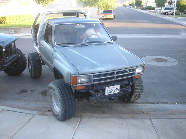

The rest of the parts were another rear axle shaved with discs, 3" spacers or something for the front. brand new 5" trail gear springs, trail gear dual crossmember. 5.29's front and rear, arb front, spool rear, brand new longs and chromo inners, arb compressor, a couple driveshafts, and some lame ass 35's. here's some pics of the truck as it sit right now with some rollers on it

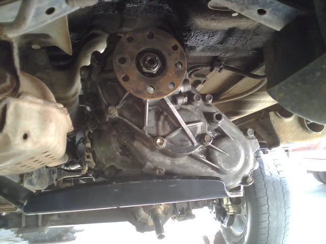

So far all thats been done was thats I installed the dual cases and the crossmember. We used trail gears dual case crossmember. I'm not sure that I like it though. We'll see what happens. I might just make something. The plans have changed again. he'll be putting toy rears front and 52" chevy springs rear but will be selling all the toy 5.29 arb & spool diffs, longs, 5" trail gear springs, rear housing thats been shaved, front axle rebuild kit w/ bearing, new marlin seals, vented rotors, arb compressor and what ever else I missed. He'll be getting the sky's fullwidth kit and swapping 1 ton drivetrian in it. anybody interested in this shtuff

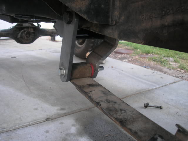

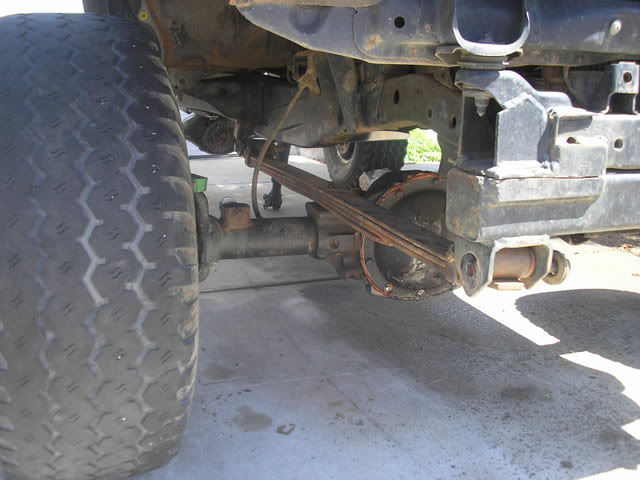

here's some pics of the rear. I installed some 52" chevy springs in the stock location to get about another 5" of wheelbase. Still need to install some 2" blocks and it should be alright until we link the back. those c channel shackles are on there until I make some other ones. I bought it with the bling shackes at no extra cost :greengrin:

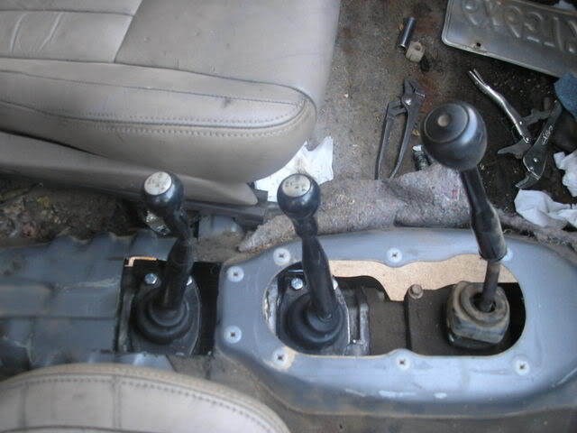

Did a little work yesterday. Took the dash out of the other cab to install part of it in this one.
I need to cut some holes for the ac lines because the truck doesn't have any on it. I also cut the floor and installed the shifters for the dual cases.
I also upgraded to some bigger rollers ;D pimpin the 33's haha

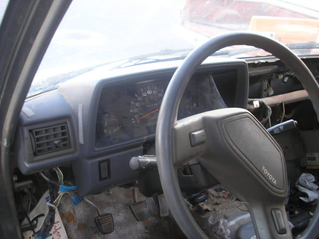

and one of part of the dash. I'll be making a custom dash

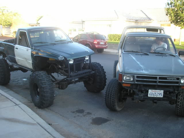

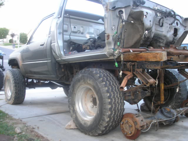

Haven't had much progress lately. I took the cab down to the recycling place. got $18 for it. put some fluid in the cases. drove it around. still need to make some front springs. I got some center bolts for them. I'll be picking up some fullwidth axles here probably this weekend and then swapping them under. here's some pics. I'm not sure of the wheel base. it should be about 115 or so I'll have to measure

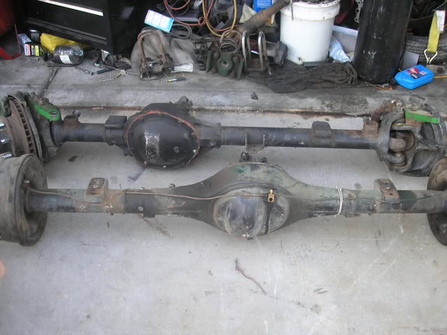

my bro picked up some axles for it today. He went with a ford 9" rear and actually a 10 bolt up front. since he couldn't find any 1 ton axles and he wanted to get his rig done. the axles have 5.13's hysteer front, locked front and rear. gonna be swaping them in either today or tomorrow hopefully.

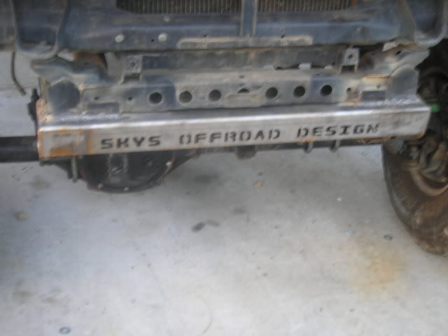

The 9" is now under the truck. I'll ordered sky's shackles and crossmember for the fullwidth swap. It should be here friday or saturday and then I'll be putting the front axle on. I have half of the front square driveshaft done I just need to make the rest of it.

Well I've built about 5 toys all with solid axles. I fabbed 3 of them and went with skys kit for the other 2. This one is my bro's buildup. I'm way busy at work and he's working two jobs so he just went with sky's kit to save some time. It can definately be made for way cheaper than the kit. But oh well it's his build and it saved a bunch of time fabing the spring hanger and shackles so it helped. I need to get it finished before the first weekend in november and now I need a 60 in the front because I think he'll be picking up some 44" boggers

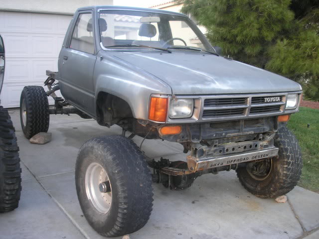

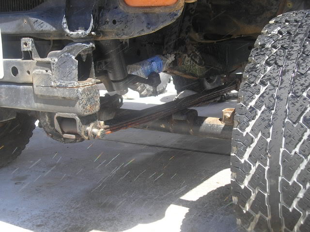

Here's some front shots. I got some sliders and a box mount and hopefully the rest of my steering will get here soon. Should have the sliders, gm master cylinder and brake lines, and steering this weekend
