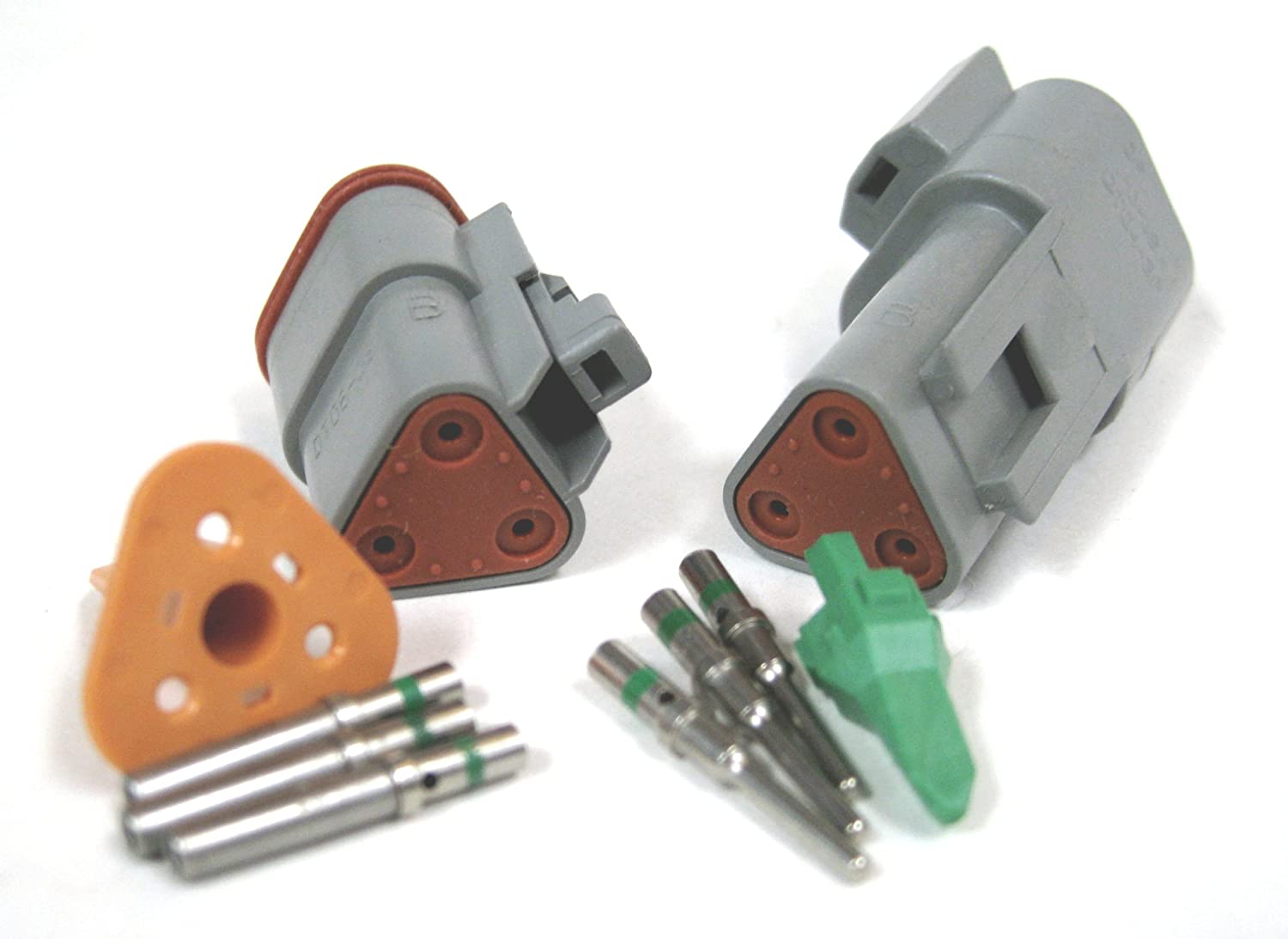

I've got a question to those who've installed these brackets already. Do you think a compact 4-pin Delphi Weatherpack connector will insert up from the bottom into the mirror housing. I'm considering using a Ram ball mount to make my lights removable and I'd like to have the wire connector tucked up underneath the mirror and secure in place as flush as possible. Here's a pic of the connector. I'm thinking about the one in the center, second row.

I meant once the wires are routed to the outside, I want to install the connector and somehow embed it into the bracket and/or mirror housing rather than have it dangling under the mirror or surface mounted. I thought it would be neater if it could somehow push back into the mount and end up flush or only protrude slightly underneath.
Yeah there is space in the housing behind the mirror panel. Not a lot, but it's more open.
The Round hole is 1¼" ID and is intended to run the ditch light wire down from the top of the bracket through the round hole under the mirror and into the door. As you can see in the photo the mirror reduces the round hole in half. I don't think you can stuff the connector into the hole or want to have it out for people to see.

Thanks for the pic. I was planning on using the puddle light hole for the puddle light but maybe I can use it for the connector and move the puddle light over a bit with a new hole. Maybe I'll pickup a junk yard mirror and play with it a bit.

@Dissent that might be a little big for the space. Why not use a flat connector? Even go with Metri-Pack? Have you seen my thread on installing this? I stuffed a LOT of wires in mine and have several Metri-Pack connectors but I kept those inside the door, not the mirror. I never saw a need to use a connector inside the mirror housing.
