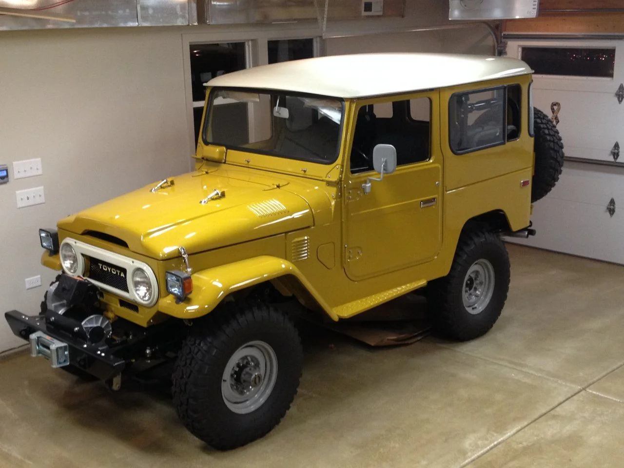

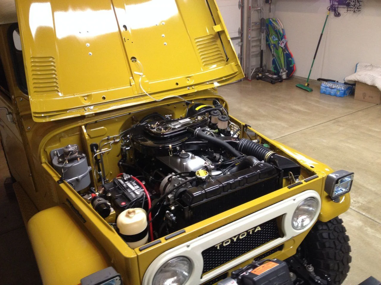

Okay some more updates, I finally installed my fuel door with a new rubber bumper I got from Beno, happy birthday Beno by the way:) I adjusted the catch till the door was flush with the body...

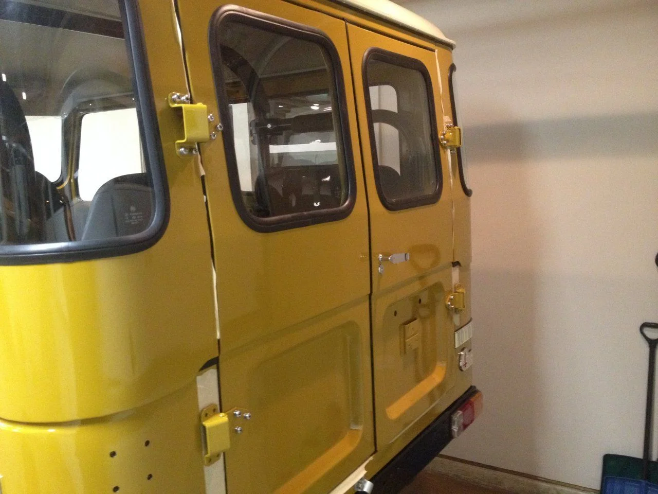

I hung my ambi doors, I lined the jams with tape so to protect from scratched while I adjusted them and the new latches/catches...
Came out pretty straight..

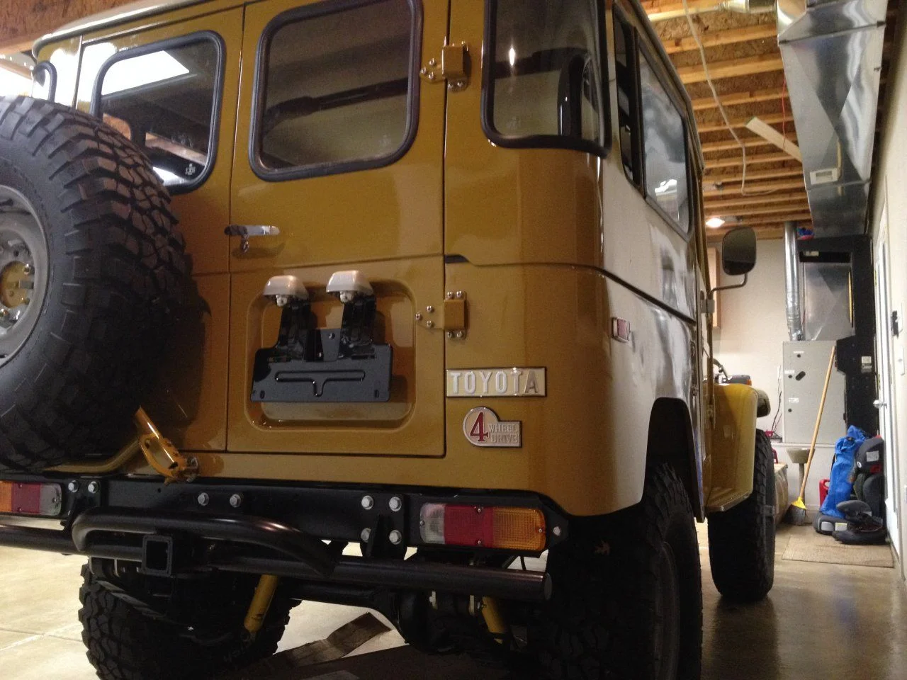

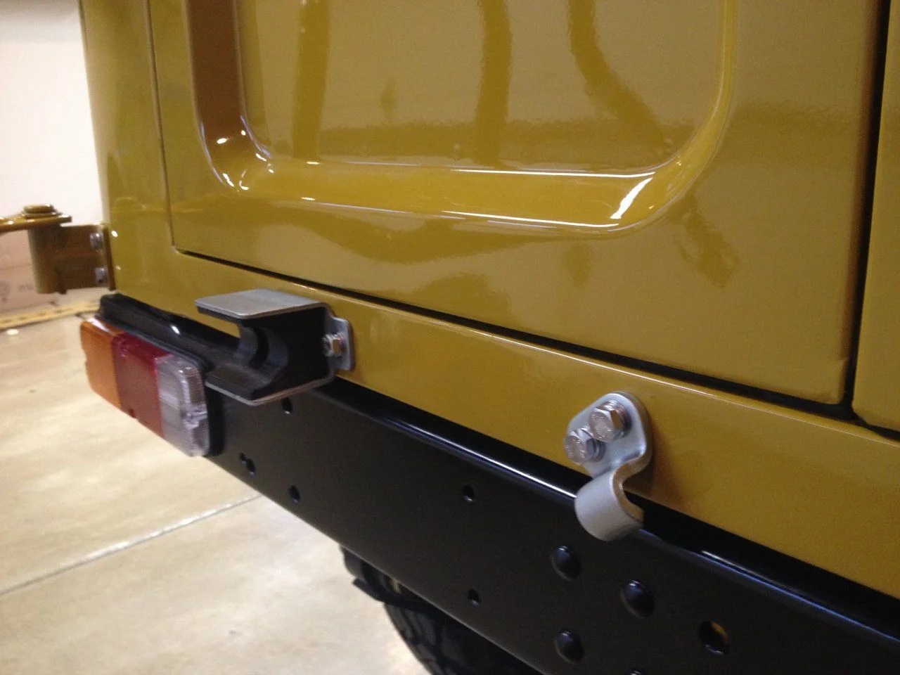

I installed my tire carrier and hardware, I had the catch and the bumper re-zinced to match closely what they looked like from the factory, these were the only things re-zinced that wasn't yellow like everything else. I also cleaned and soaked my rubber grommets in silicone for my license plate bracket that I restored awhile ago and installed that all with new stainless hardware all around.

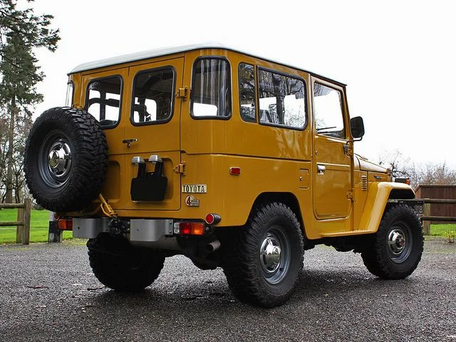

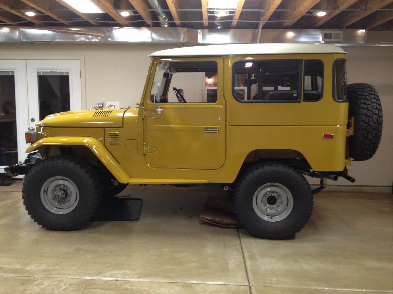

Here are some random shots I took before heading in for the night. Getting very close to selling her soon, what do you guys think? Would a buyer like the 4Plus bumper or would original bumperettes be better? Personally I love the 4Plus bumper and think it looks perfect on this truck, but would be a snap to unbolt it and bolt the bumperrets on it. I would keep this bumper for my next project but I'm already using one of Dave's tire/ cooler carriers...
Freakin' fantastic. I just love the overall look of this rig. And I like the aftermarket bumpers... tasteful and more purposeful than the originals. But I'm not a hardcore purist.
Gorgeous...

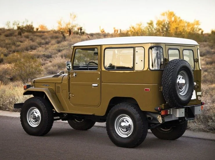

If you are looking to maximize value, the auction record FJ40s retain the stock look, including the original bumperettes.
