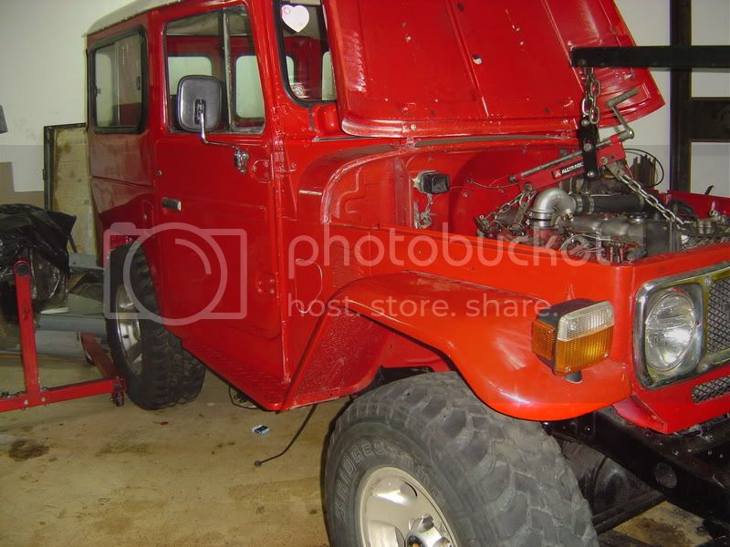

Hi guys, Its been a while since i posted here. But I finally got another cruiser, or better yet cruisers.
I've been wanting to build a 40 on an 80 chassis since i got my first 40, but that one was too nice to chop up, so I sold it a while back to a customer who really wanted it.
It was this one
Since i got my hands on Joeri's Land cruiser. This one.
https://forum.ih8mud.com/vehicles-trailers-sale-wanted/514603-bj-40-1hdt-ff-cable-lockers-ready-rock-roll.html
I figured it was worth more in parts than what i paid for so I chopped it up and parted it out:doh:
Sold the coils first.
Engine and trans next.
Basically I was only going to keep the body, doors soft top, winch, tires wheels, guages and assorted parts, everything else was getting sold.
