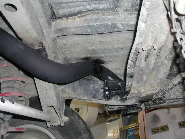

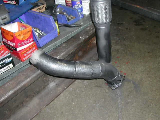

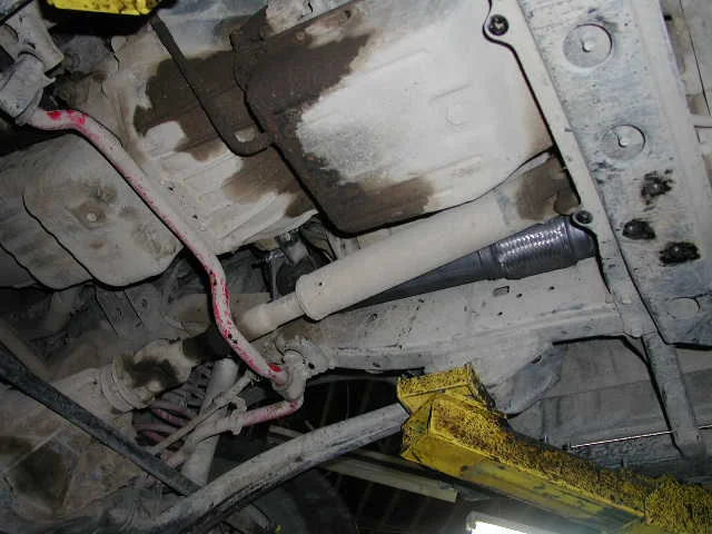

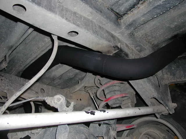

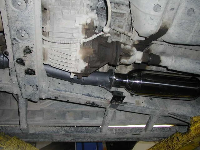

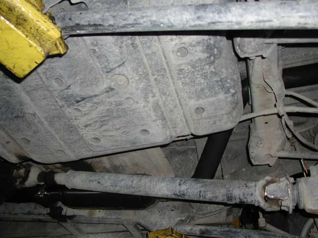

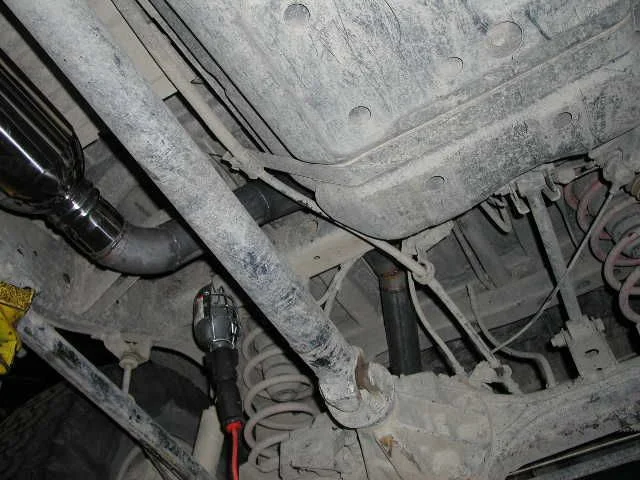

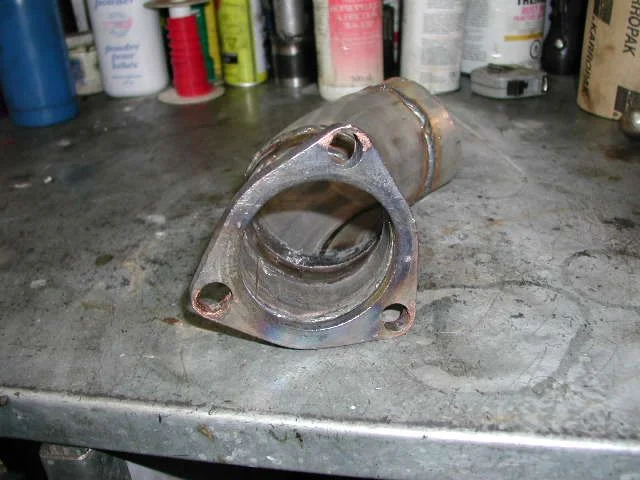

installation photos
John of Ateb sent me some of the installation photos.

I thought I'd share my results. I recently copied Enigmas/ATEBs routing on the inside of the frame. I originally installed the exhaust following the factory path but was unsatisfied with the performance and installed a take off after the turbo down pipe. After a couple years with the take off and my wife complaining of the noise and smell I re did it. My installation is pretty similar to yours with a few variations here and there.
This is the way to let the 1hdt breathe!:cool: There seems to be very little difference in performance between this path and the direct take off I had on. I figure I avoided a full 360 degrees in bends by staying on the inside of the frame. Version 3.0 is a success.......and my wife approves.:grinpimp:
The only flaw with mine was I should have went stainless. In the last pic in post #11, the bottom radiused portion is already beginning to rust because it's the low point in the exhaust and that's where all the water/condensate collects.
