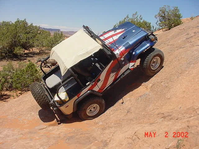

Paint is done... FINALLY. That sucked ass... My garage has mist all over it, the floor is red & blue, and I spent waay too much time and money on this... Next time, it will all be vinyl, but Nicole wanted to help (She did the design and the masking, I just did the labor), and who am I to say no? :grinpimp:
I gotta give credit to Texican - ever since I saw a picture of his cruiser, I wanted something like it..
Sorry for the blur, it's kinda dark in the shop, and the flash washes out the colors.
(And yes, the paint is pure Rustoleum, for EZ touchup. the rattle cans match perfectly!!)
OnTheSpot said:
Never seen flames like that before but I like it. Right on!
Her idea was that the flames are the stripes on the flag, which is why they are straight at the leading edge of the hood... It's also why the stars are oddly shaped, 'sposed to be like embers from the flames..
Thanks :)
Eventually, it'll have skins of some sort, but with a private ride coming up, skins are last on the list..
The front of the cage will just be red, and will go to blue at the point where the rest of the paint does.. I'm trying to talk myself into doing the whole cage blue, and not just taking the easy way out and going black.

Damn, we could take the back half of mine and the front of yours and have one truck red n white stripes and one blue with stars...... :confused: :confused:
Thanks Nolen..
Butch - When nicole asked me what I had in mind for paint, I showed her your rig for inspiration... We just didn't have as much sheet metal to work with, :D Nor was I willing to have something I can't repair with a rattle can on my junk. Something like yours is what I'd LOVE to have, but then I'd become one of those guys who won't use the body to get around a rock...
She really liked the art on your Cruiser though..
You get over that after a year or so of babying it, mine is getting some rash now.....
Maybe we'll get 'em side by side some day.
Butch
