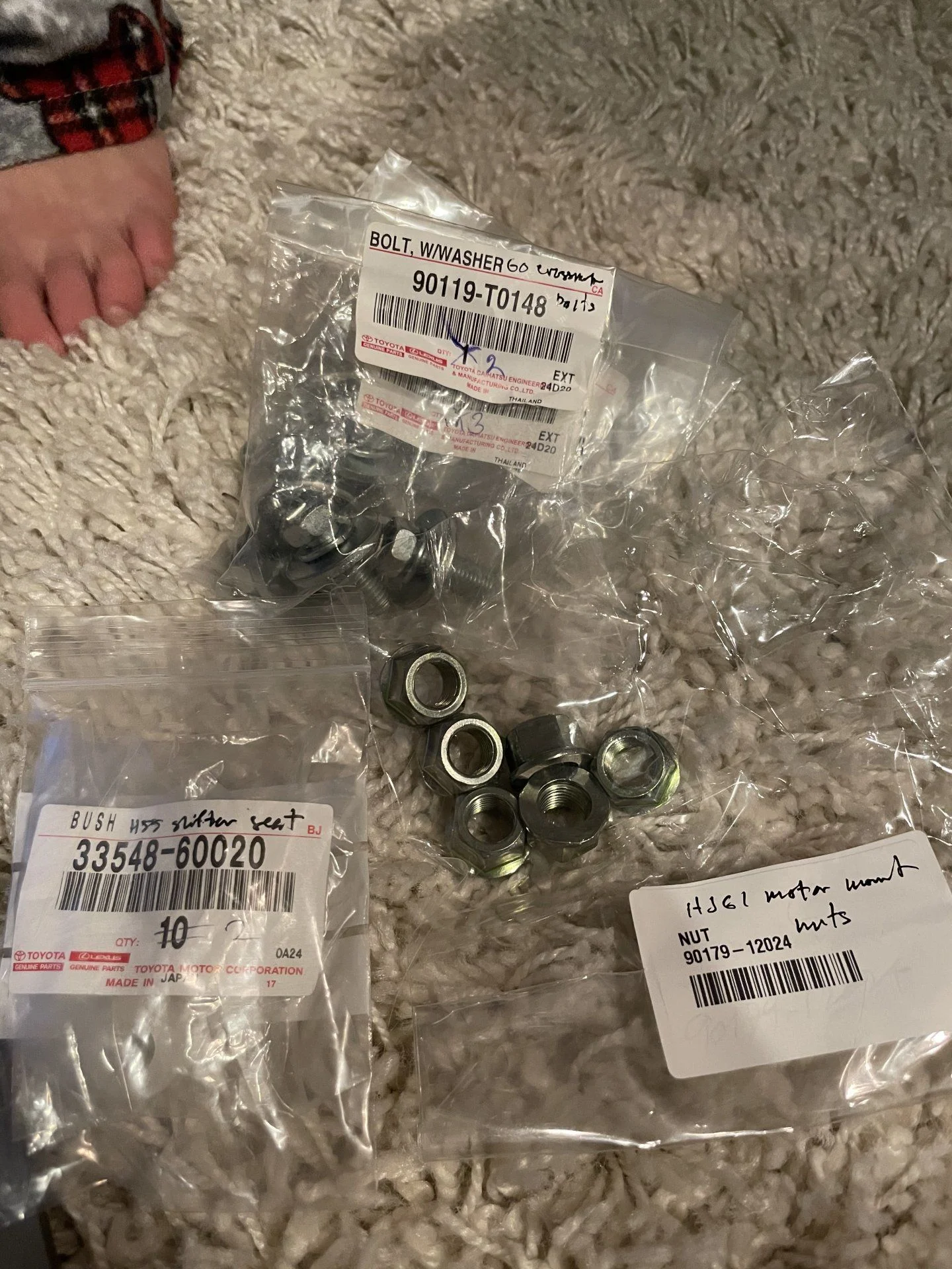

A handful of new shifter seats arrived. F$&&ers.

New inner shift boot and a new farking shifter seat.
New hood grommet.

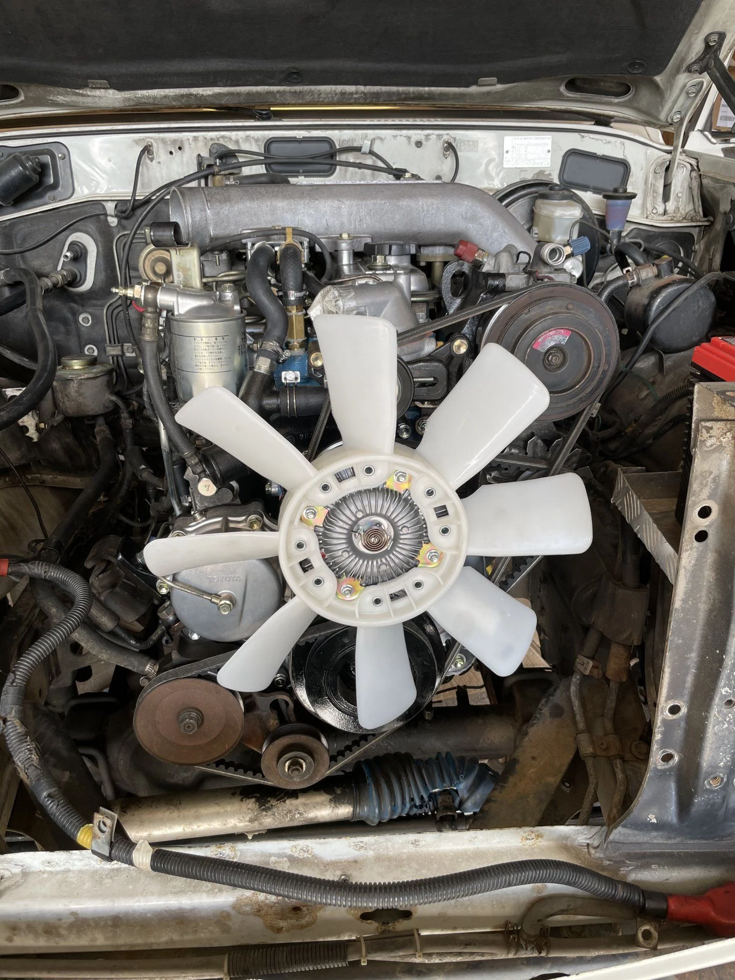

New fan clutch nuts. Aisin fan clutch and aftermarket fan.

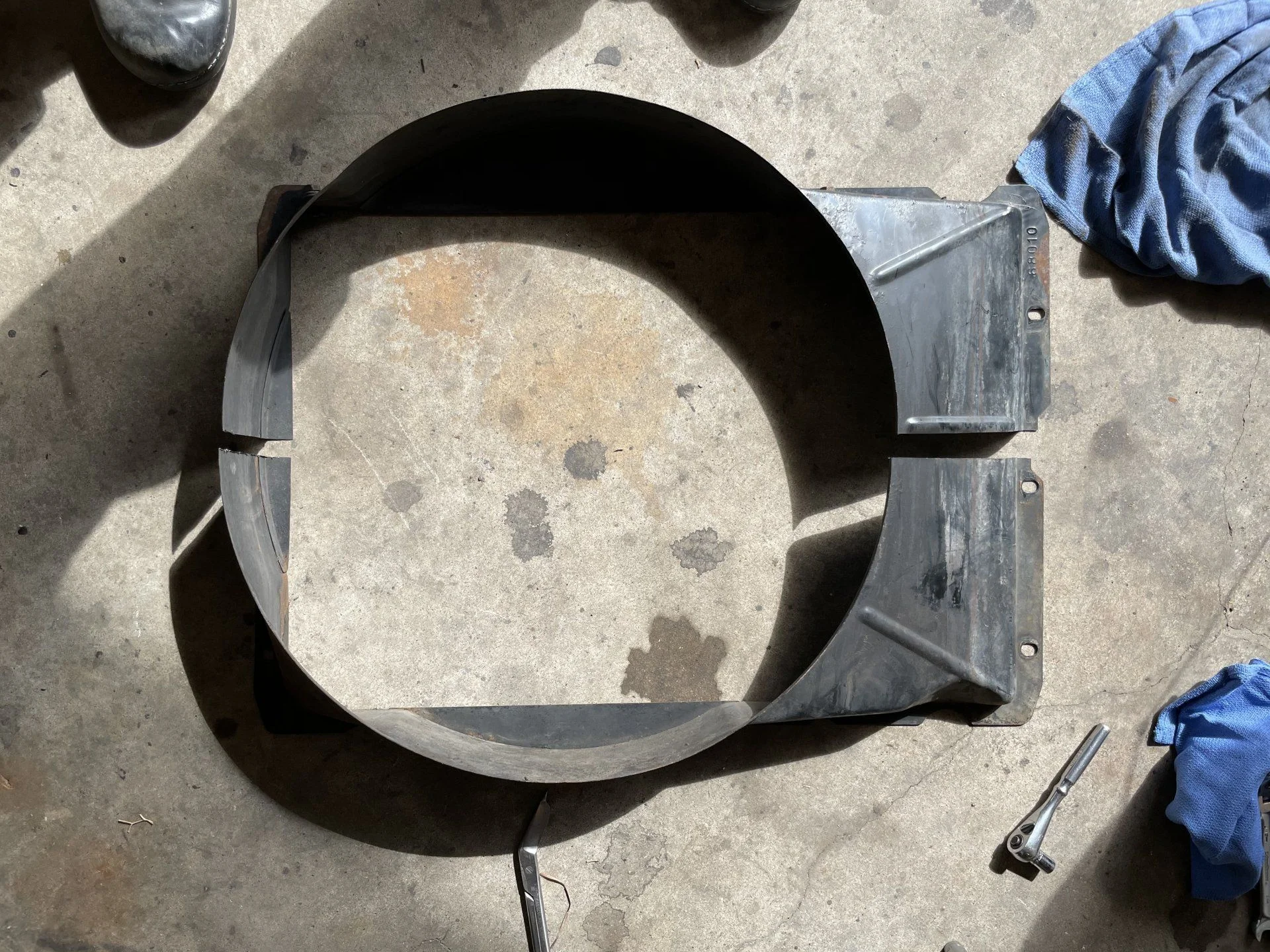

Fan shroud mod.
I took a deep breath, measured twice and cut once.

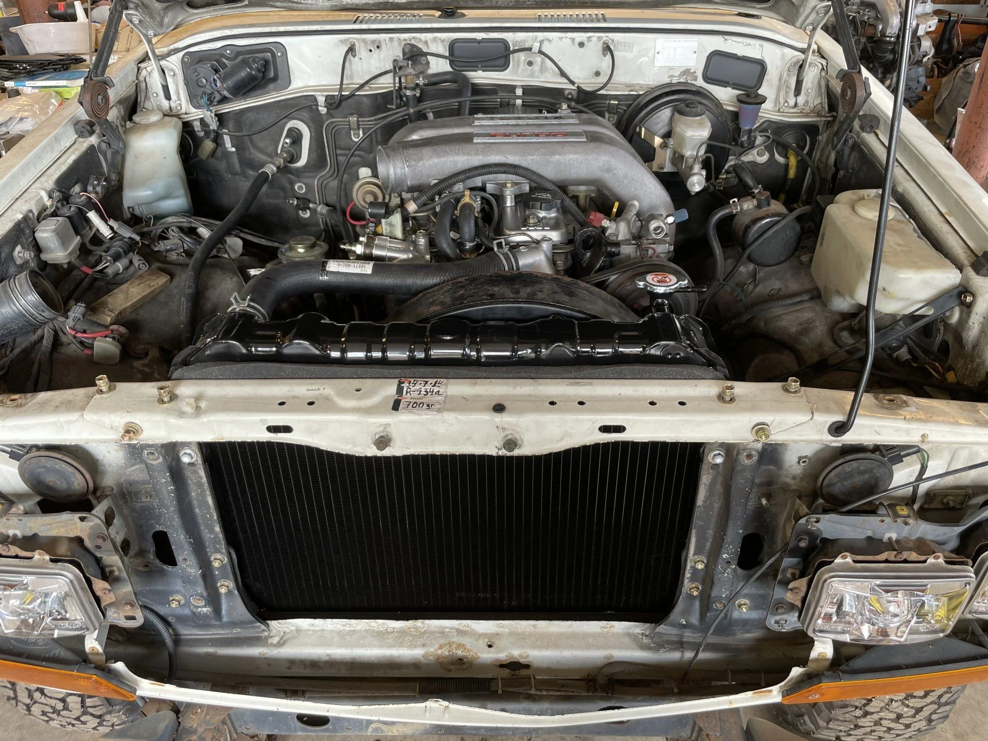

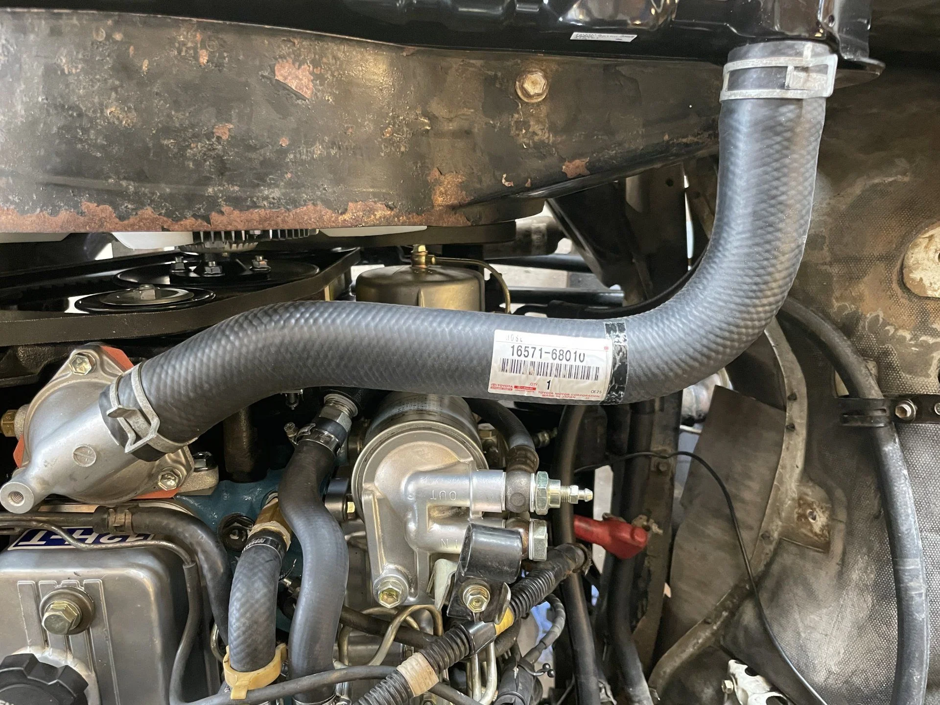

Factory radiator from
@Onur . I think this was the first part that I bought for this truck over two years ago. New radiator hoses and clamps. The 56 mm clamp goes on the water pump and the 51 mm clamp goes on the lower radiator.

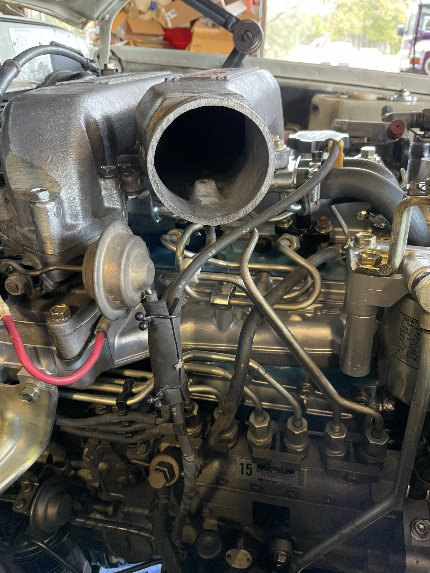

Oh baby, it runs!
Success.
She purrs like a kitten, and I even figured out my errors in the vacuum routing. Even the shut down works!

I got kind of excited when it actually turned off with the key.
