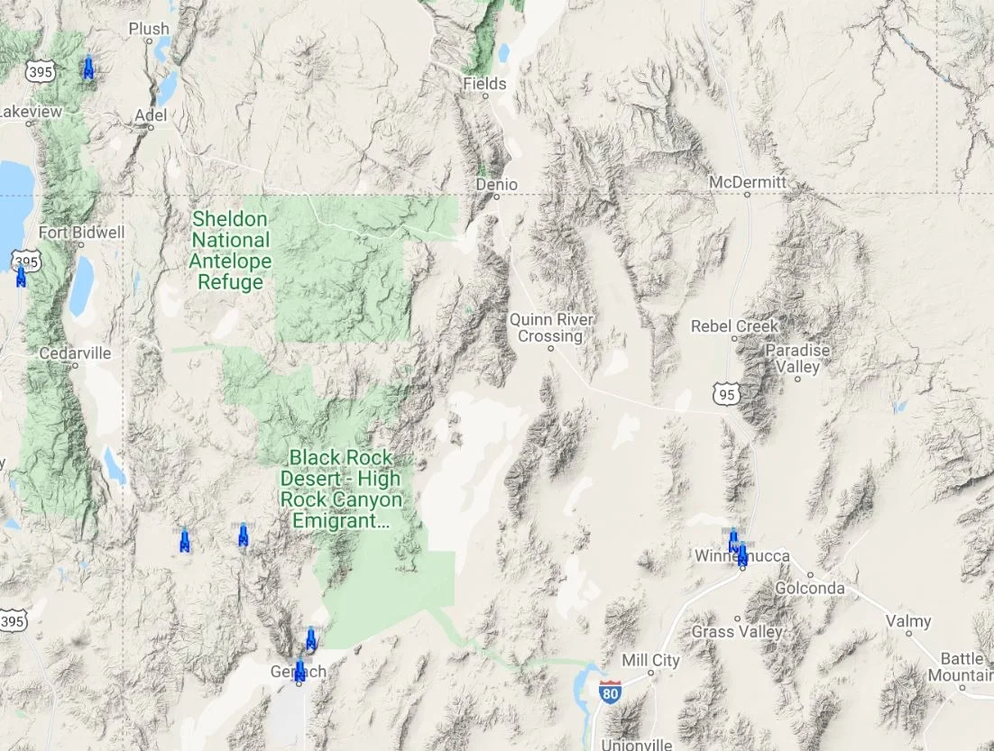

I keep trying to find a use for repeaters, but I just don't find myself in areas with repeater coverage and without cell coverage so I never use them enough to consider myself trained. This map shows the closest repeaters to the areas I'll be hunting this year, roughly between Denio and Quinn River Crossing. The nearest is about 80 miles.

Maybe we can talk about sponsoring a Repeater on the reservation one of these days. Would be nice to extend coverage to the NW region and perhaps link it with one of the other repeaters too. The one in Nixon (147.030) Links to the repeaters on Mt. Rose and Peavine.
The SNARS repeater network covers a lot of NW Nevada.
A repeater is a huge responsibility.
