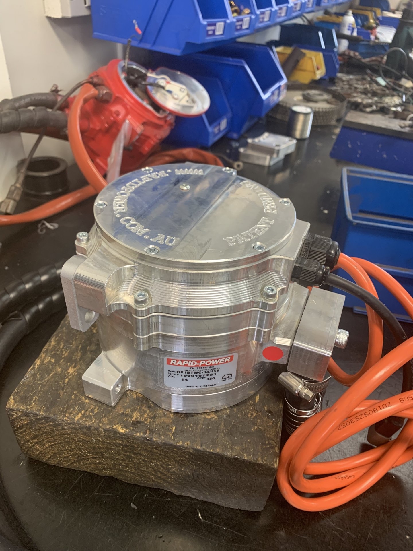

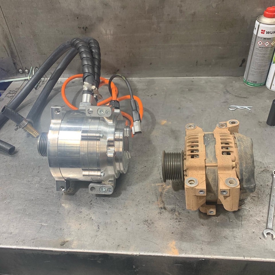

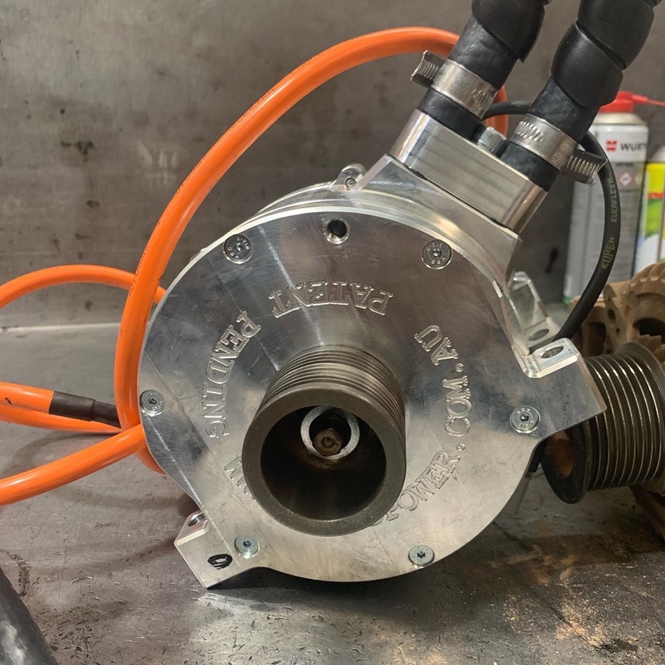

I charge Lithium batteries direct @ 200a. If you have lead acids its completely pointless as the batteries can only absorb 20-30a anyway.
These are sealed, Watercooled, Brushless and 200 amp outputs
Reviving an old thread but just curious if you meant that you're charging a LifePO4 starter battery directly from the alternator? If that's the case very curious how that's working out.
Working awesome. I supply lithiums for this application and have 1000's out there

Re: a 270A alternator. Why not go with the 390A (which is what I installed)? You'll need to do the same up-wiring with a 270A as a 390A if you actually intend to draw above what's OEM so there's no real saving with a 270A unit, IMHO.:cool:
To get real power at idle order the alternator with a smaller pully and put in a shorter serpentine. The serpentine has to be removed to install the alternator anyway, Again, no real saving in keeping the old serpentine. This combo has served me very very well. I can simultaneously run the LC, charge the Yeti at 400w and the Lithiums in the trailer at 600W. I haven't even come close to maxing out that alternator. Yet. ;)
