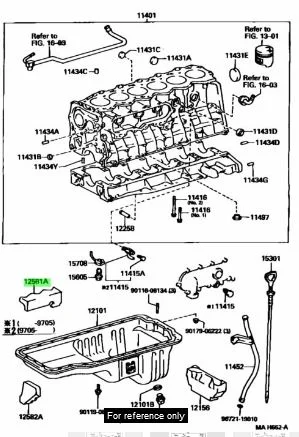

@96TrailSurfer Can you post up a photo of what you have?
The part marked in green appears to be the insulator:

It would be interesting if someone had an actual photo or three they could post up of this part.
I'm wondering if it can't be rebuilt/remanufactured ie: is it 100% foam rubber, rubber and steel core, or ??
