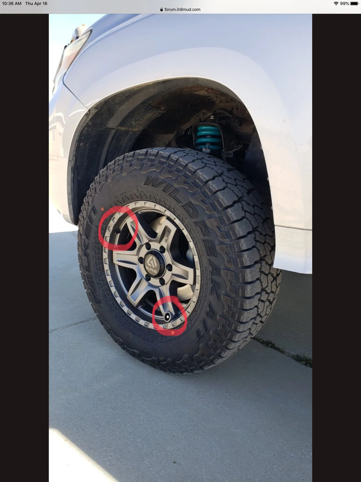

Those look great! Curious, why two valve stems?
@Carnevino I'm told it's so you can read tire pressure while airing up/down the tire. The installer mounted the TPMS sensors in the protected stem locations on my setup.
Since you have two valve stems, you can also add an inner tube bead locking system: Inner Air Lock Internal Beadlocks - Starting at $129.95 ea.
This allows for very low air pressure and prevent pinching the sidewalls. I've though about doing this, but right now can't afford any further expenses until this whole COVID-19 is done. Maybe next year.
In California anyways, true "beadlocks" are illegal. They are also a pain since you have to constantly check and torque all those lock ring bolts to make sure they aren't loose. This is a great option for the more hard core off roaders who air down below 15 psi and rock crawl.
