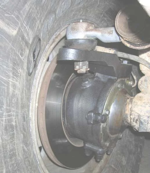

ben, i used GM 1-tons on mine and they worked good, had a local guy in the springs thread the DOM and Ream out the holes!
the only issue you have, is that the holes are too close together to put 2 1 tons on the passenger side arm, you can see in the photo that the drag link connects into the tie rod via a reamed out hole in the passenger side TRE
Did your Previous owner upgrade to the mini truck knuckles?
