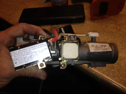

If you're interested, there's a solenoid on top of the ignition shaft that controls this. Easily to disconnect if you want. Only downside is you risk walking away from your truck not in park.
I may have to look into that! I've already had a valet trash an ignition key trying to get it out of the ignition without it completely being in Park. Luckily, it was only the $5.00 key housing, so it was an easy fix. But I still have to remember to tell every valet to be sure it's all the way in Park before removing the key.
It's the white square in the center.
Been there done this. Disabled mine and one day forgot to put it in park...truck ended up in intersection. Yah. Don't do that.
Ha! Yes, it's there for a reason. I'm pretty anal about my shutdown sequence: shift to N, parking on, foot off, weight transfer to drums, shift to P. This puts zero load on the pawl. And if it ever 'pops' when I get back in I know that I have a parking break problem (which never happens). It is a PITA to adjust the parking break with wheel spacers.
As a side note, I was on the trail a couple of years ago and got out to take a picture of my truck with Mt. Adams in the background. I couldn't figure out why the mountain was moving across my frame... got out with the truck still in D and parking break on. Not my brightest trail moment.
