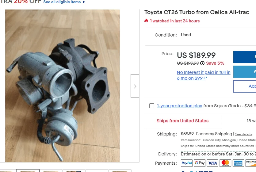

I planning to turbo my 1HZ at some point, starting to collect some smaller parts and plan the rest of it. My thought is to buy as used CT26 to rebuild, but it looks like factory 1HDT CT26's are hard to come by. Would there be anything wrong with buying a CT26 from a late 80's Celica or supra? I found this on eBay from an 89 or so Celica All-Trac, housings look oriented the same direction as a factory 1HDT and Wikipedia says these cars were 8-9psi factory... i think this PN is 17201-74010?
Anyway, are CT26's all the same basically?

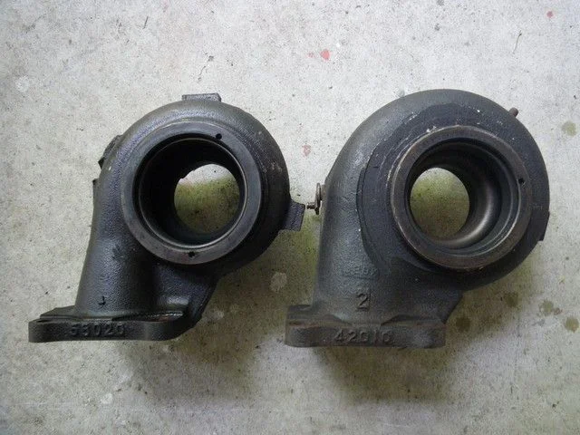

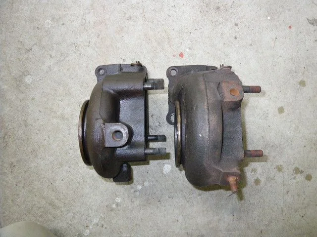

All CT26 share the exact same 68/52mm turbine wheel with 10mm bearing shaft and 6.5mm compressor wheel bore. The FTE ct20b which most people really dislike due to the huge EMP it runs and weaker shaft/ bearings is only 60/48mm with 8.5mm bearings and 5.7mm compressor nose. Compressor wheels are all very similar in design and 65mm exducer size but the inducer size is the main thing that varies. The exhaust housings vary from the 6cm twin scroll to the 8/9/10cm single scroll depending on vehicle, you can mix and match them all depending on your taste. I know quite a few people running the largest 10cm exhaust housings and all of them can still get 20psi at 2000rpm.
@SKULLYOTA Did you end up buying that celica turbo? I guess the best and only way to know exactly how it'll go on your set-up is to try it. It's a relatively simple process to changing the exhaust housing to a smaller version of you find you don't like the performance of the 42010 housing.
