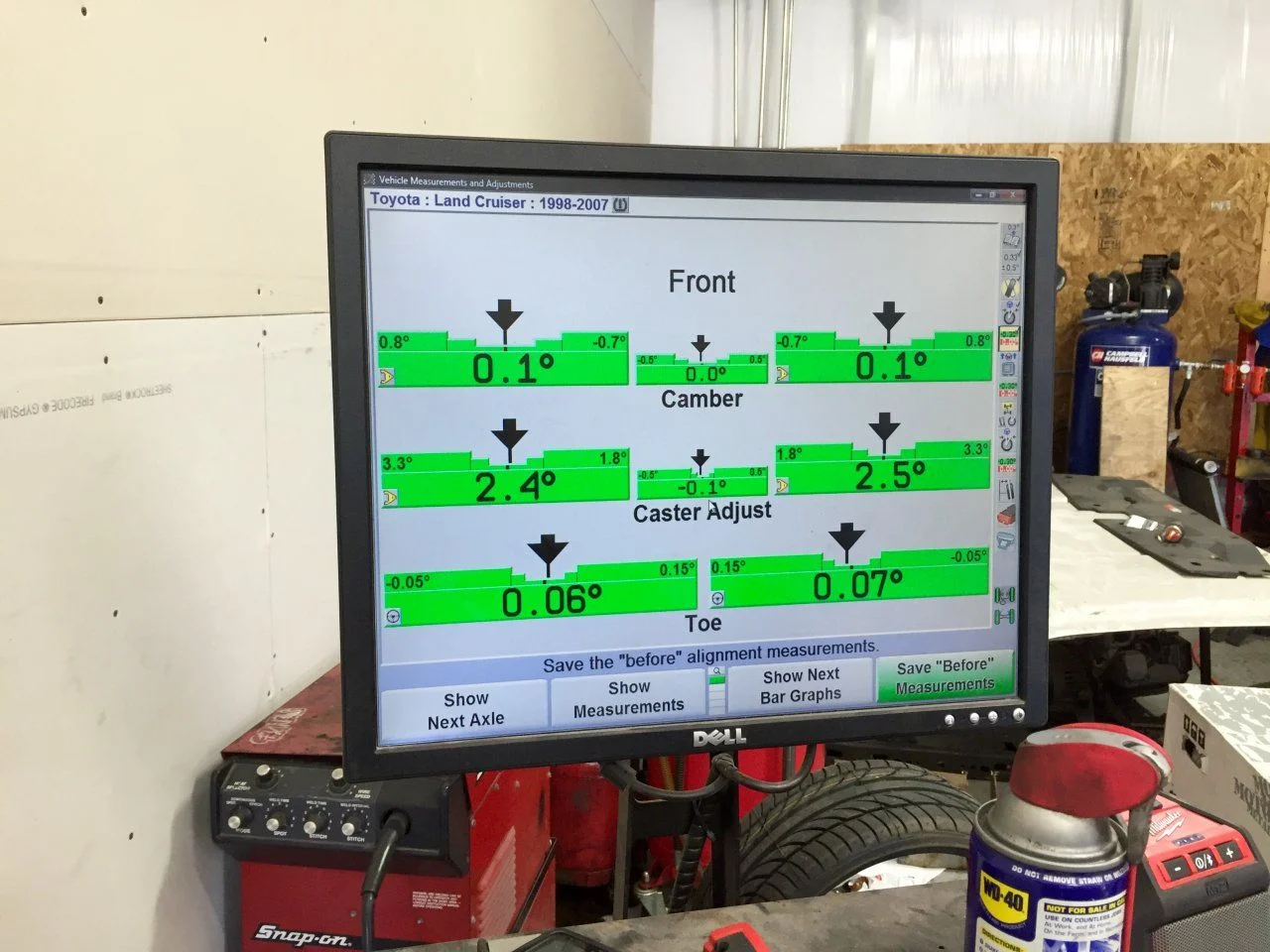

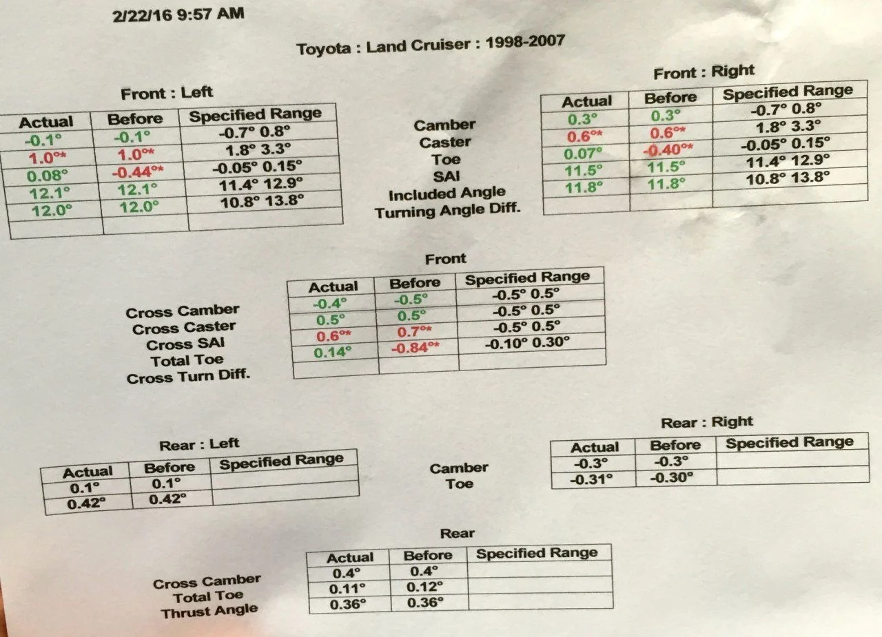

So I had the truck aligned this morning at a local shop (just picked the closest one to me). After it was done, the steering feels (very slightly) harder to turn than it was prior to the lift (same tires). And there is some wandering on the road. Very minor, but still noticeable. Different to how the truck behaved with the stock suspension and different from what I know from my former solid axle trucks.
I asked for the alignment numbers and some values are off spec. The tech said he cannot correct the values any more as they are already maxed out...

I was under the impression the UCAs would give the option to actually attain ideal caster and camber values... Maybe the tech does not know how to set these UCAs ?
Here's a copy of the values.

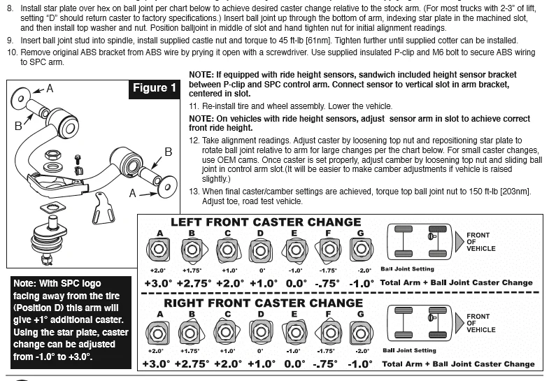

Look at the "D" on the UCA. Which setting are they in? Do you have 2* of adjustment left?

Honestly if I had to guess, you prob had an inexperienced alignment tech that did not know/care to adjust the upper control arms. He probably looked at all the factory adjustment locations and only used those because thats all he's ever done.
In looking back over your before & after readings, it's kinda interesting that caster appears to be out of spec but unchanged on either side.

@wolffo Yes, digital alignment system.

For reference, caster is corrected by turning a plate that is sandwiched between the bronze thicker plate and the UPC body under the ball joint... The ball joint nut must be loosened almost all the way, use a pry bar to lift the UPC body, turn the plate as needed to get the necessary degrees as per the instructions and then tighten everything back up... This was the step the other alignment shop skipped.
