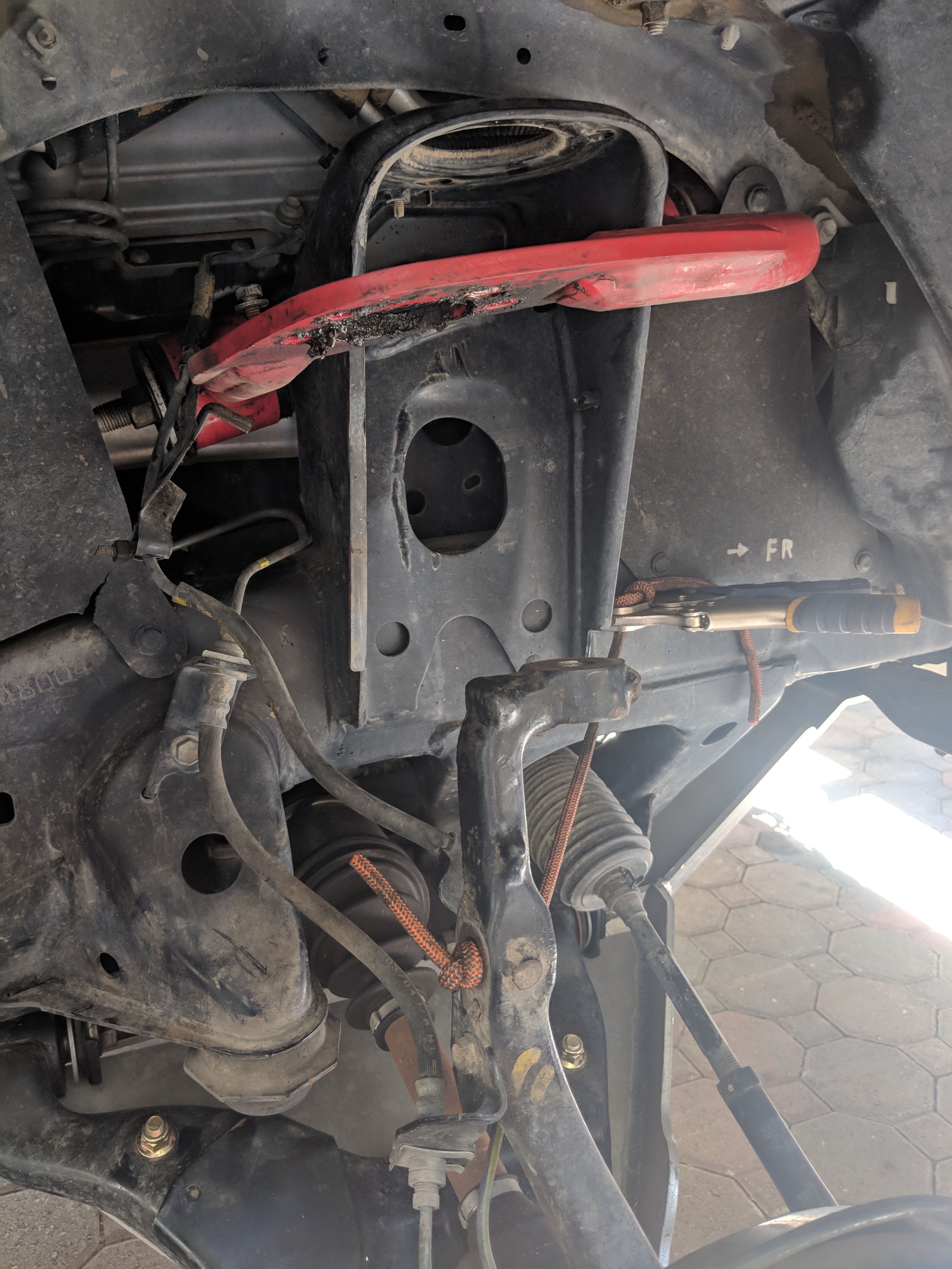

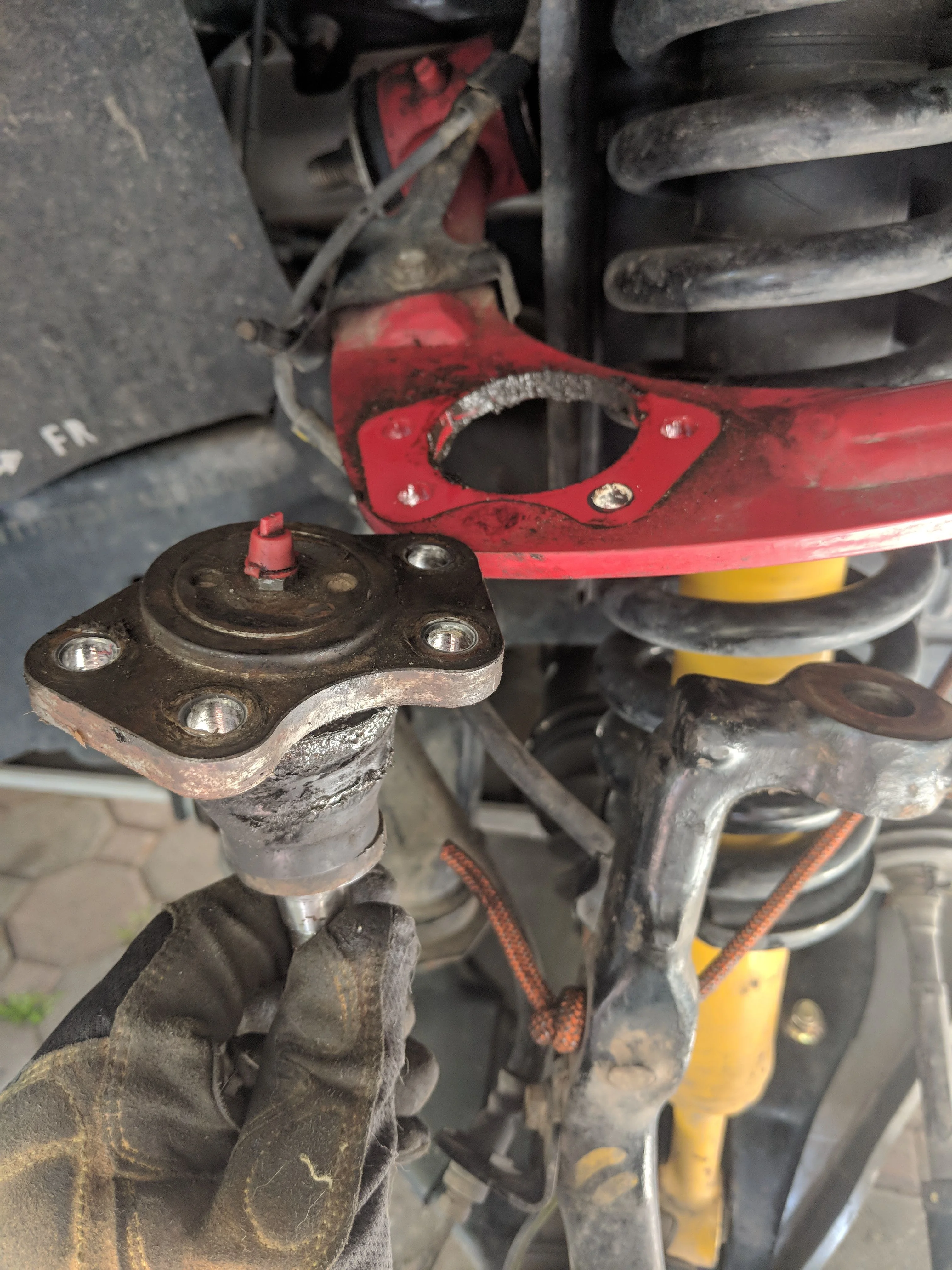

I also decided to replace my JBA ball joints while I was in there, which were rusty as I bought them before they upgraded their coating process. The new ones were provided under warranty (+1 to JBA), and we'll see how well they hold up.

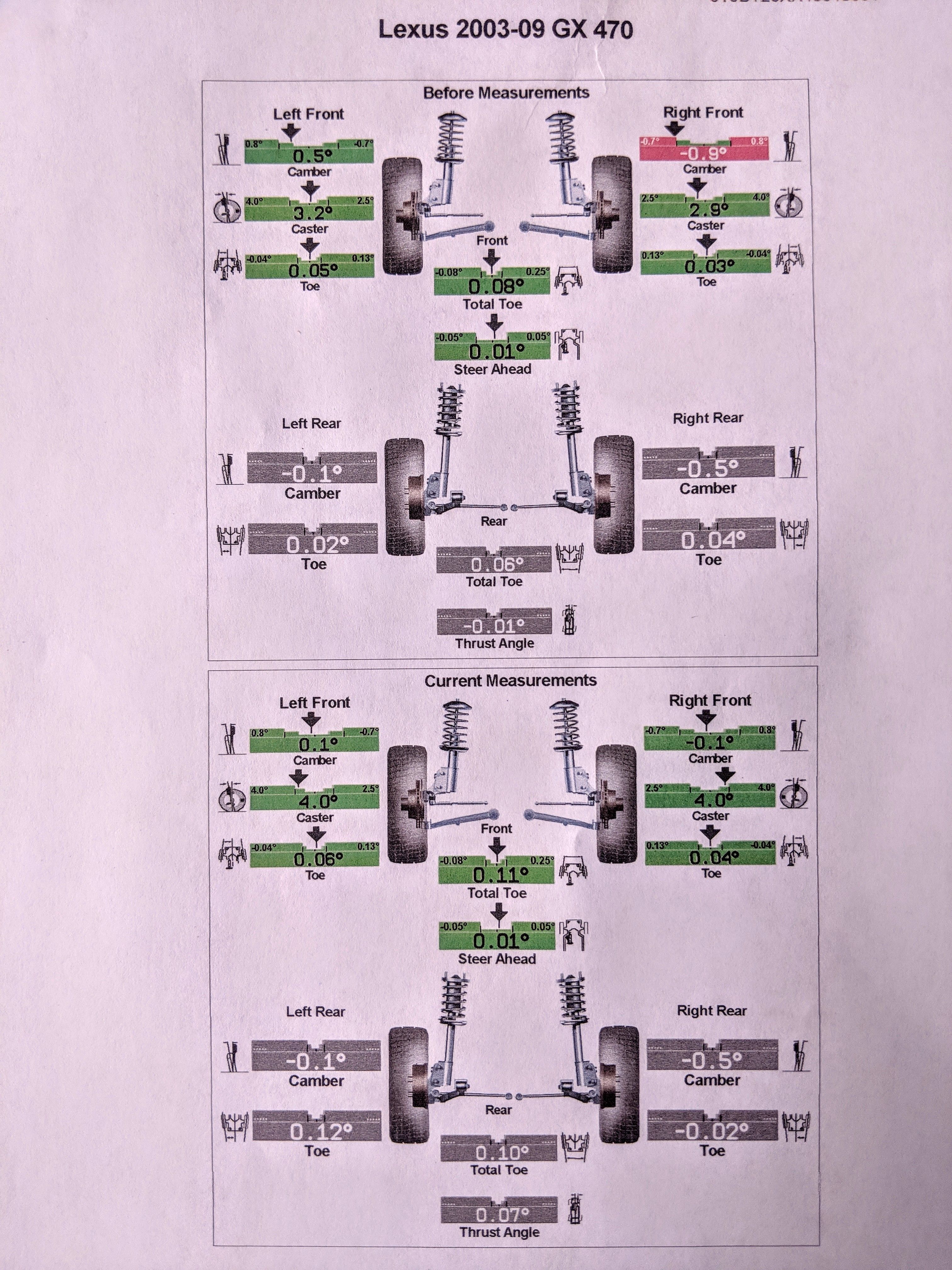

After mucking with my suspension I took it in for an alignment, and asked the tech to put me at 4* caster on both sides (no road crown adjustment). He nailed the specs, which might have been because I stood out there and watched :p
I wanted to try 4* to see how it drove, in an attempt to move the tires a little farther forward in preparation for 34s or maybe even 35s. I'll have to report back after a few weeks of driving, but the ride home was fine and the heavier springs were barely noticeable.

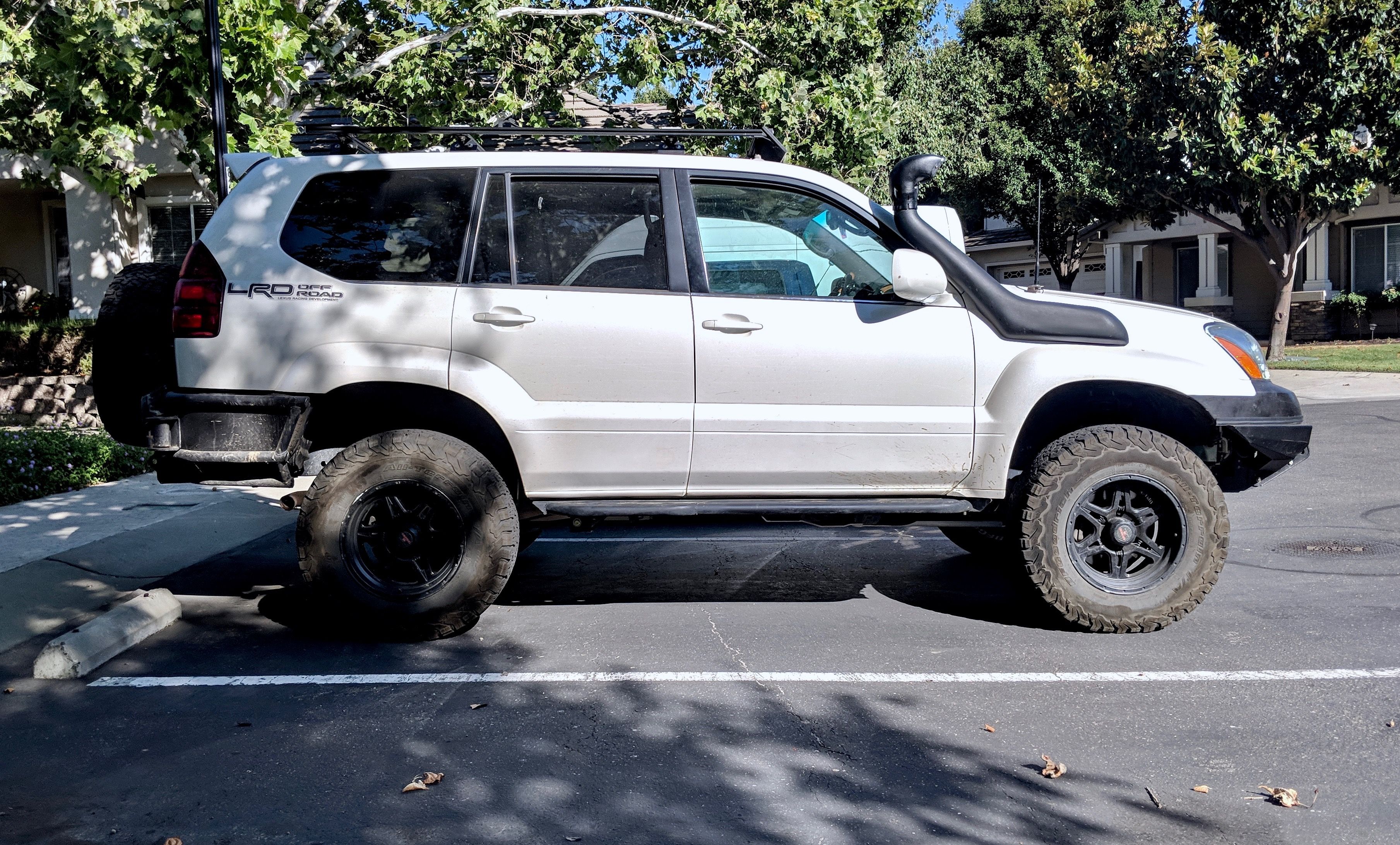

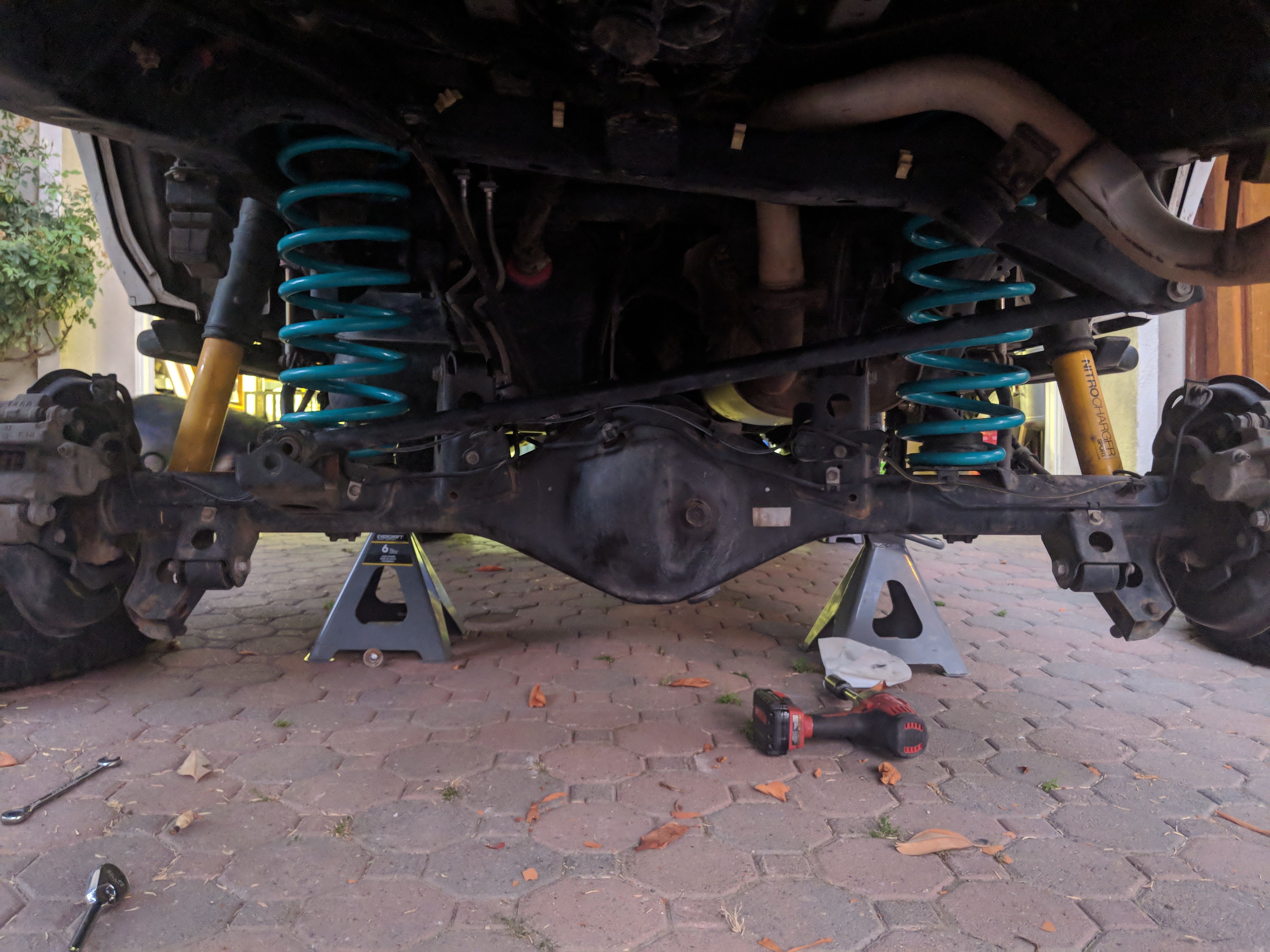

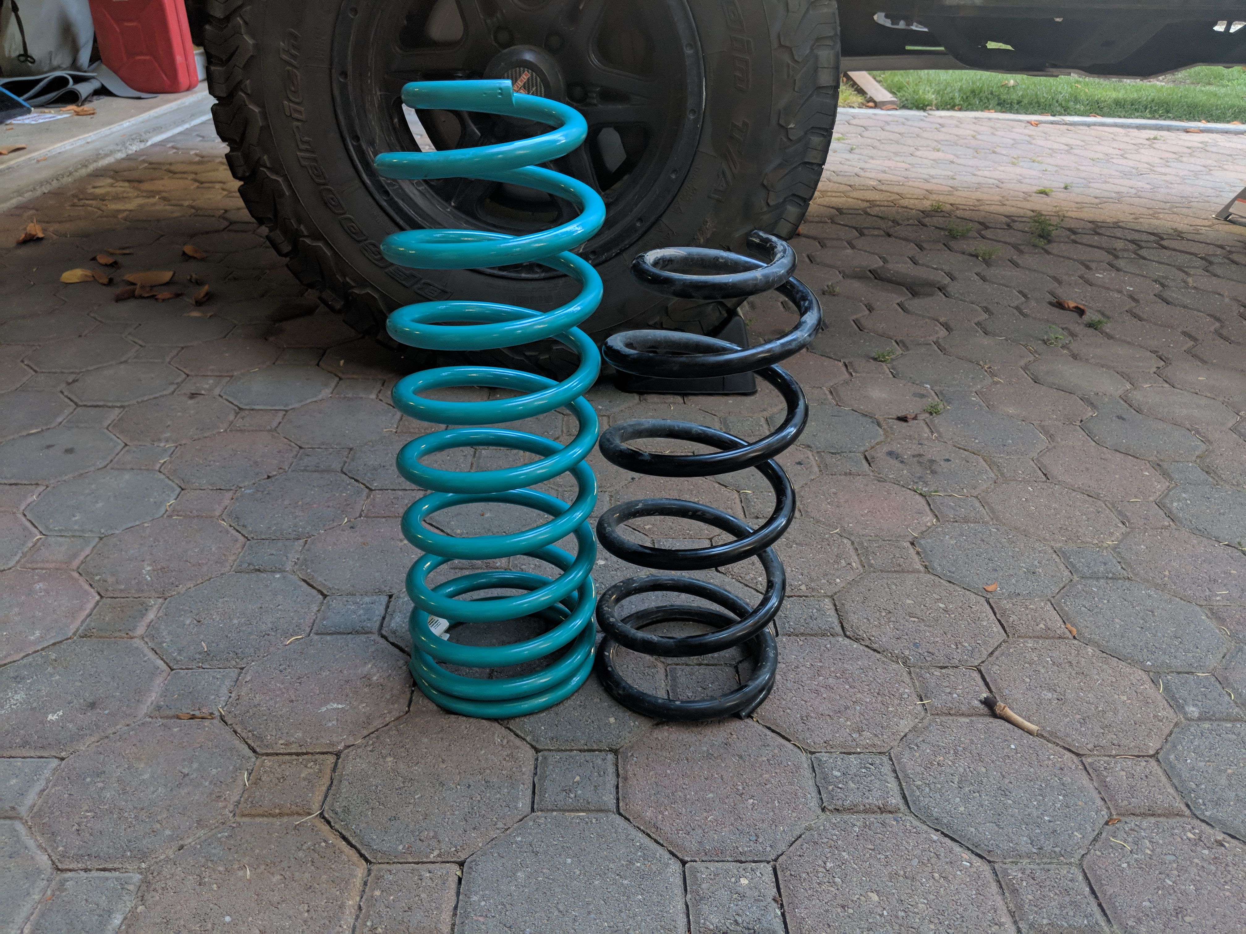

Slowly working towards long travel rear. First step was springs, as I had a bit of a brorunner squat after changing to heavier springs up front. I went with Dobinson's C59-701V Super HD Progressive Rate springs (600lb+, 3" lift).
Also removed the old AHC hardware while I was in there
The springs got me exactly where I wanted to be (thanks for the advice @Kyle Fogle ). 24" hub to fender rear and 23.25" in front.
Next step is new lower links and new shocks. Still having a hard time deciding on shocks, but currently leaning towards Icon VS 2.0 for the revalveability.

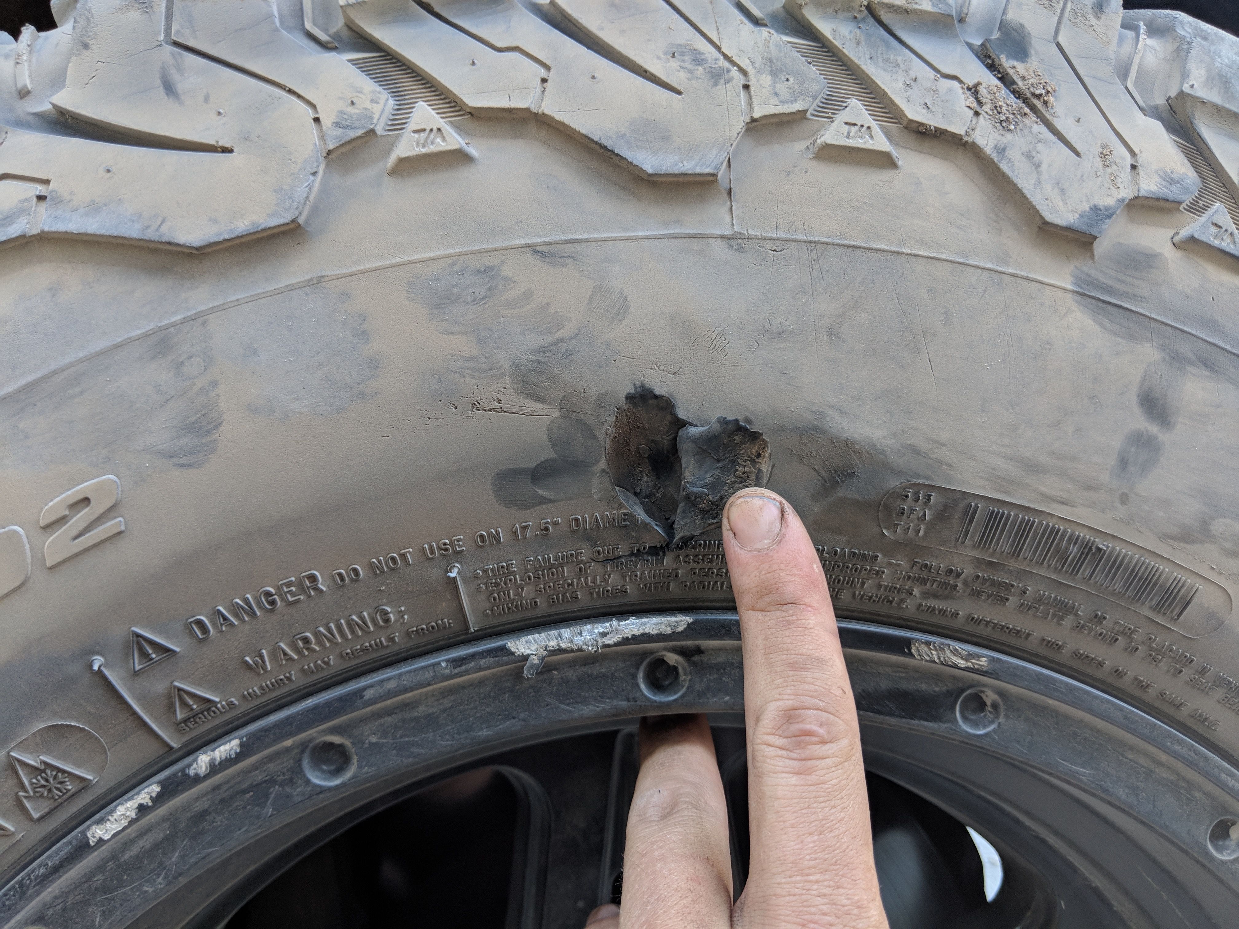

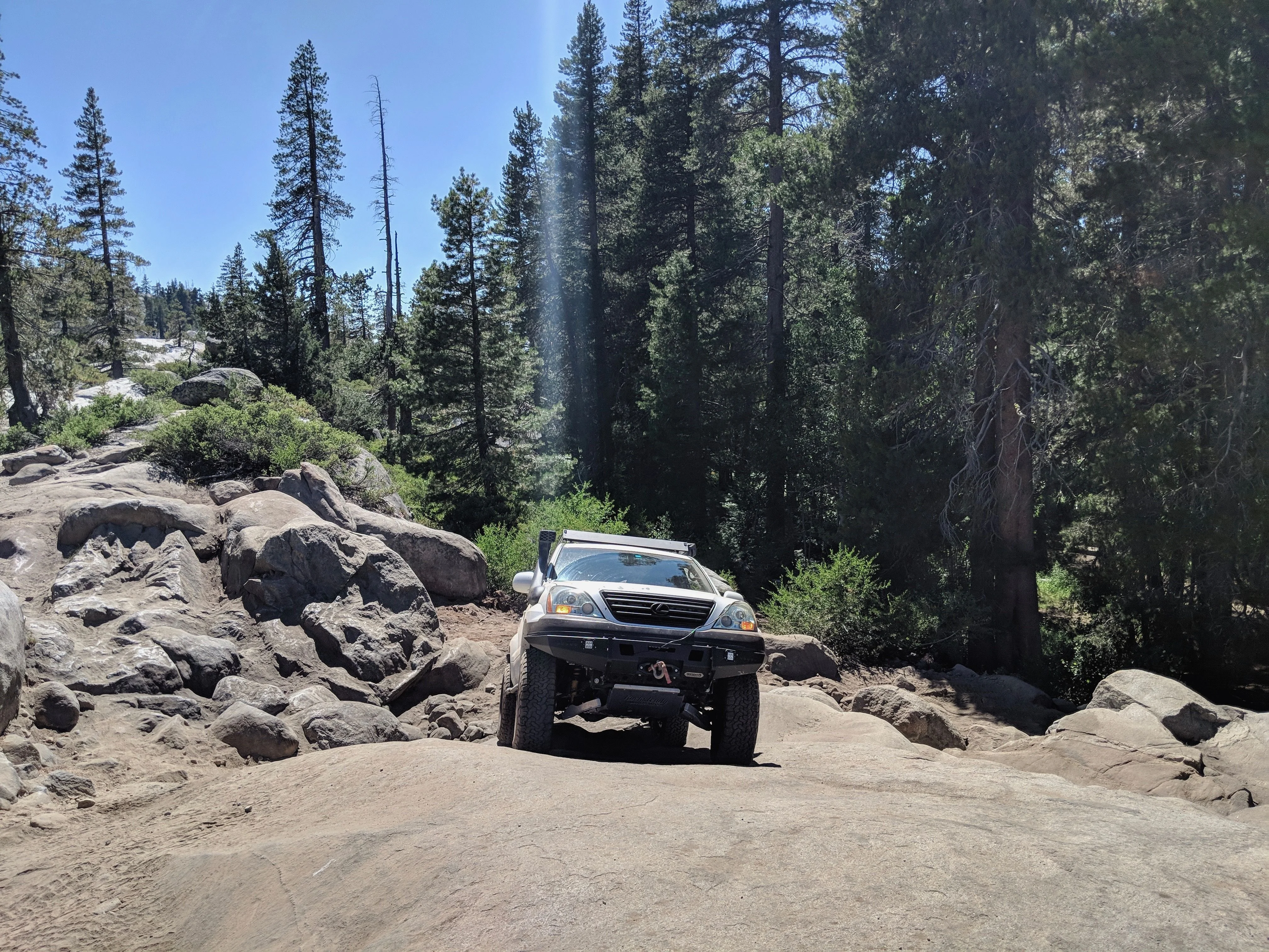

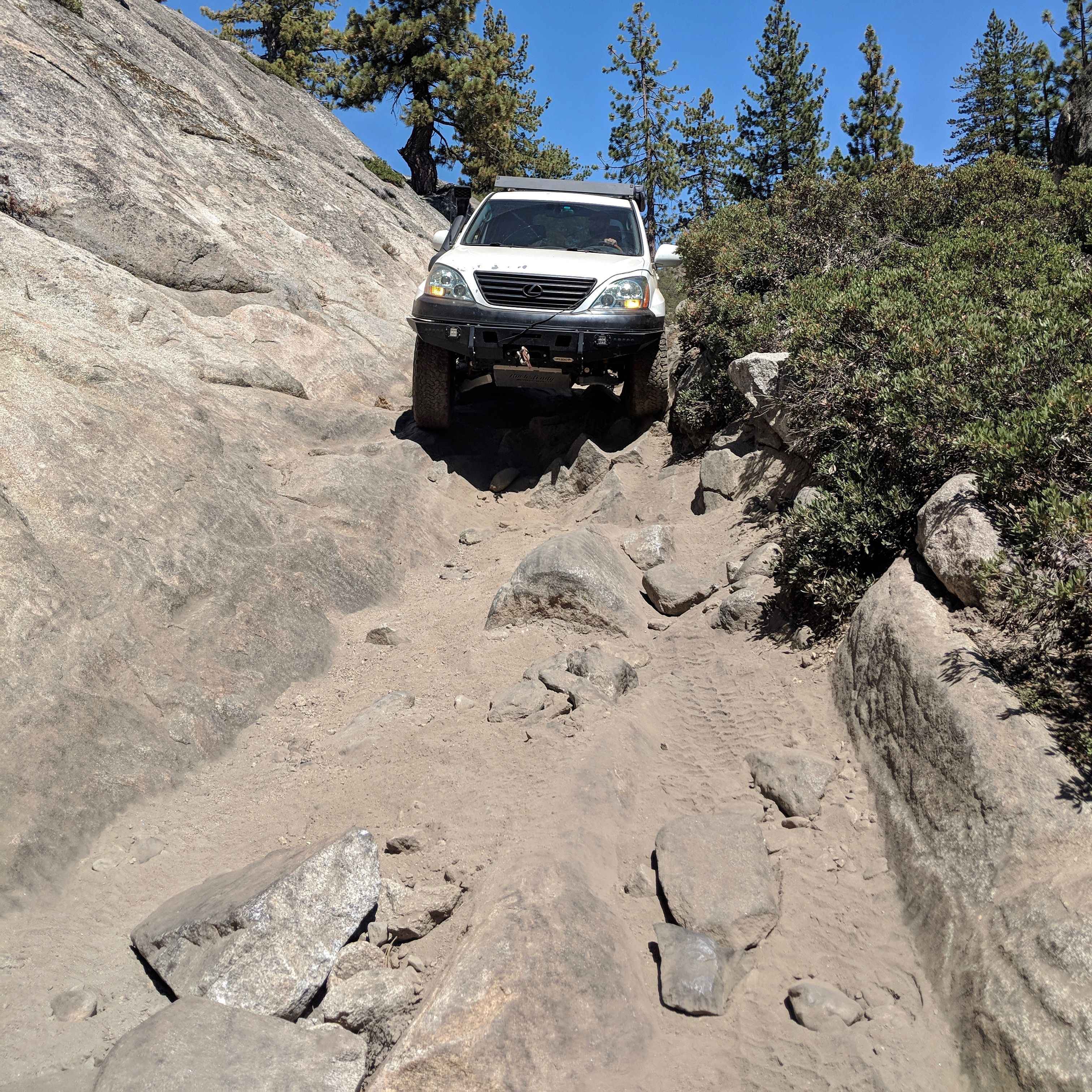

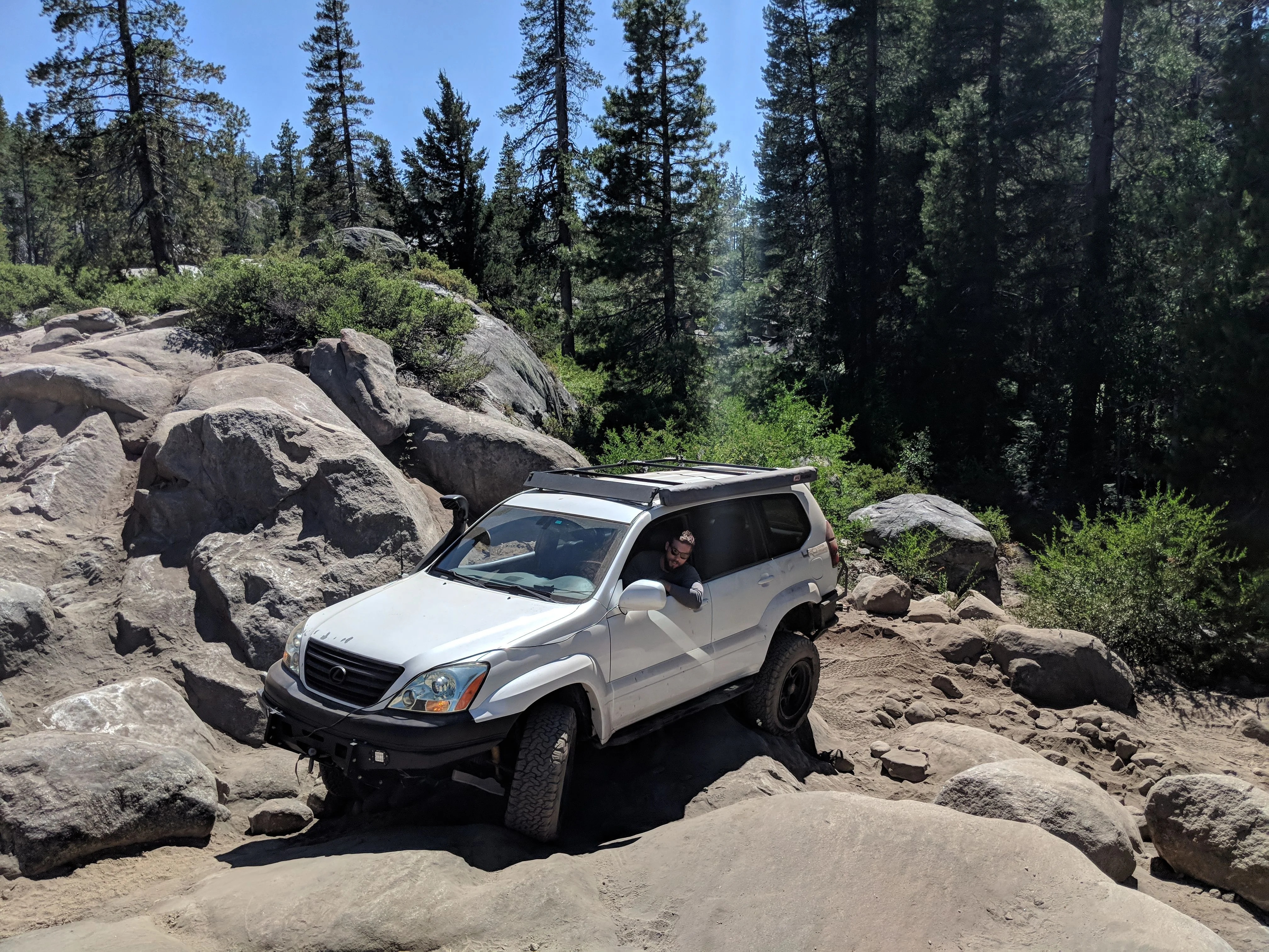

Spent the weekend in Arnold and ran Sourgrass and Slick Rock. I would say the new part of Slick Rock that goes around the private property is the hardest. My wife and I needed a bit of practice on our spotter-driver communication and I ended up high-centered a few times as a result. Nothing the winch wouldn't fix!

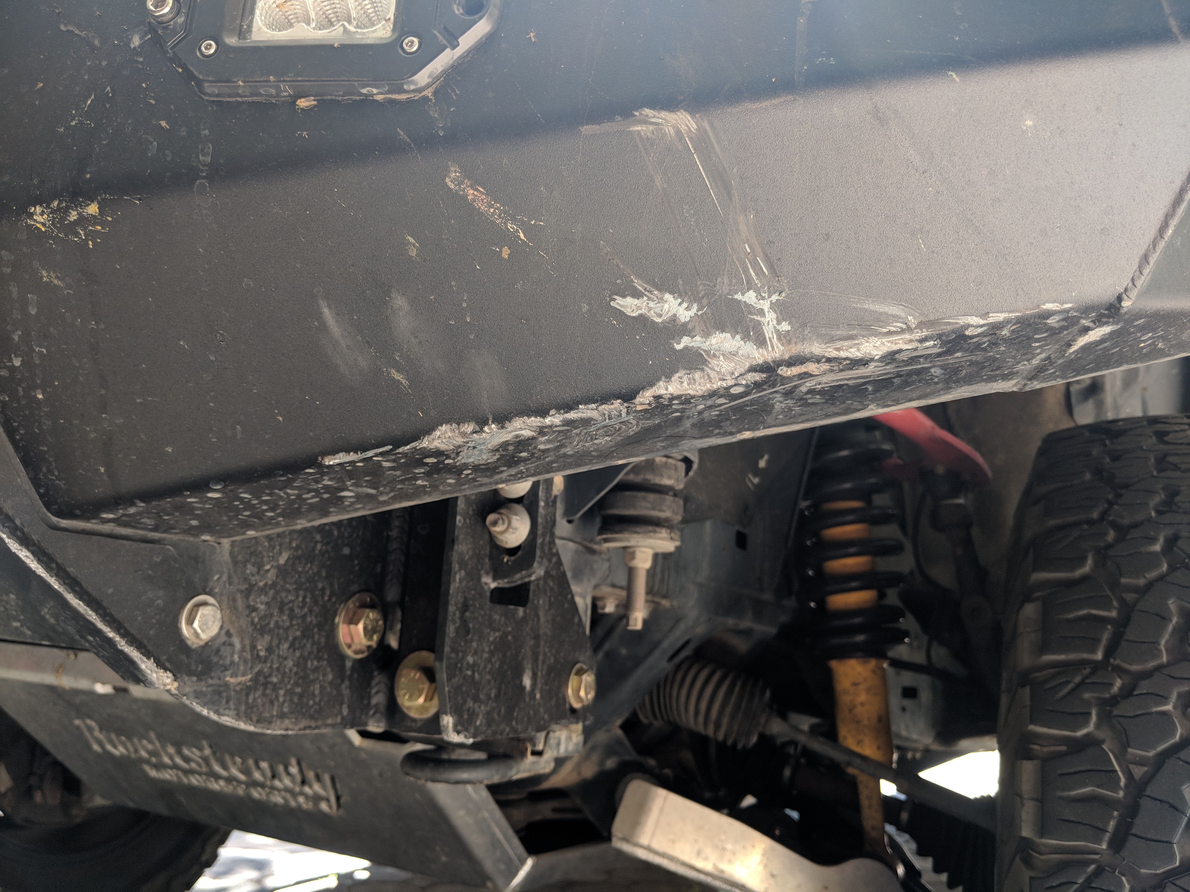

All that getting stuck and dragging over things definitely put our armor to the test. I love the Dissent bumper but it doesn't have the greatest approach angle, and got hung up a few times:

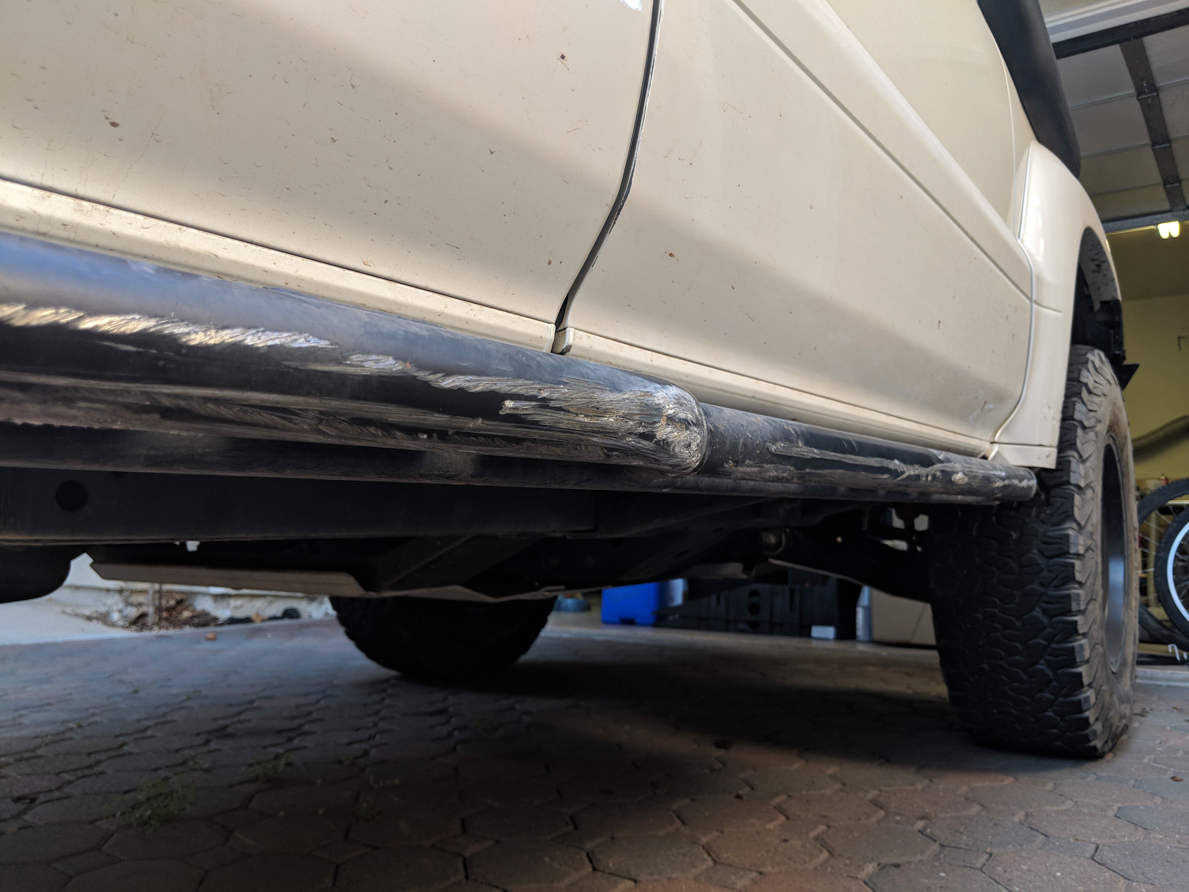

The OPOR sliders did fine and got plenty of attention:

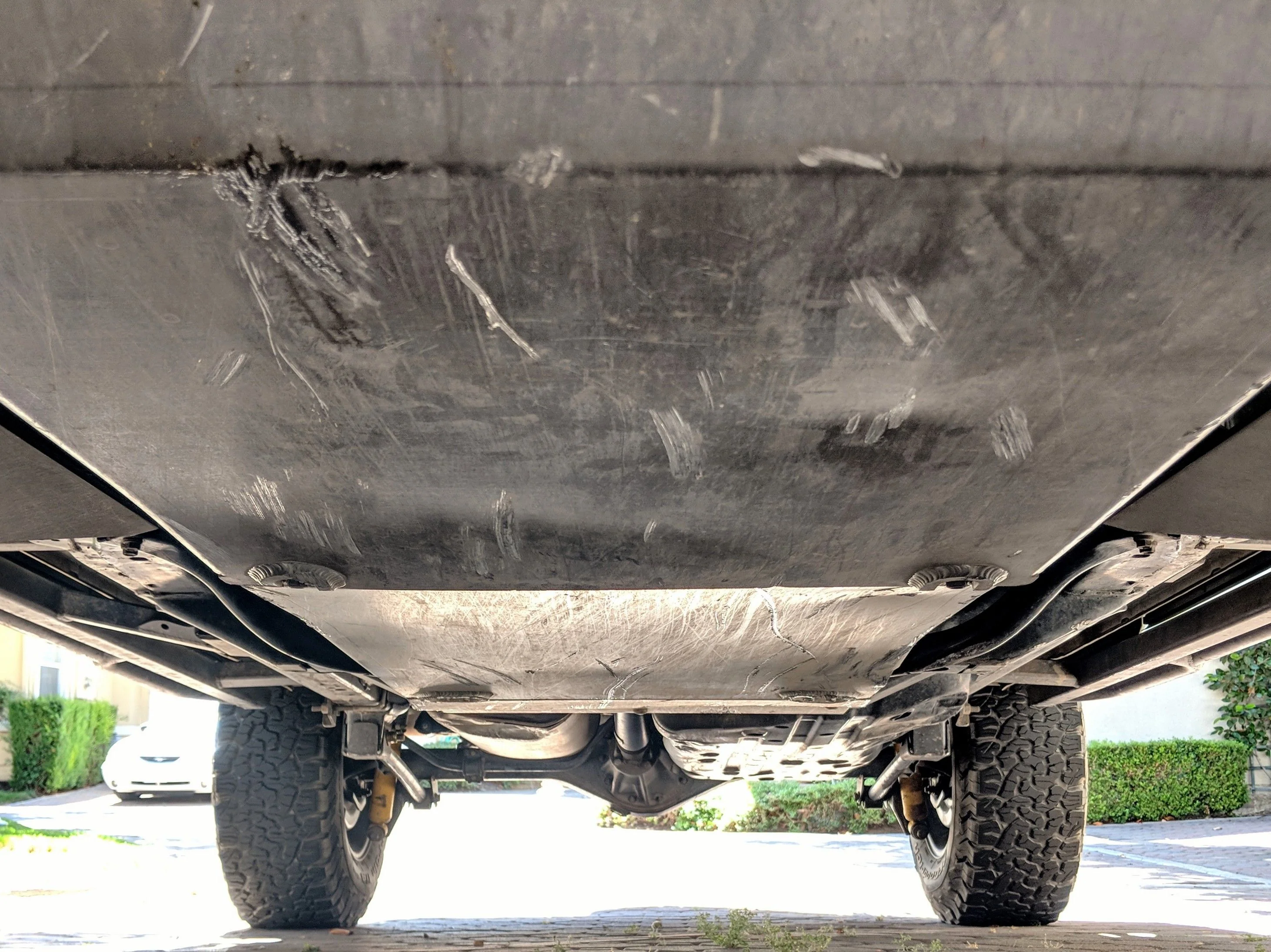

One of my biggest gripes with the GX is the low belly, and my stock fuel tank skid and muffler paid the price:
Also put the Rocksteady skid plates to work, and considering they're aluminum they took it like a champ (albeit a bit bent):

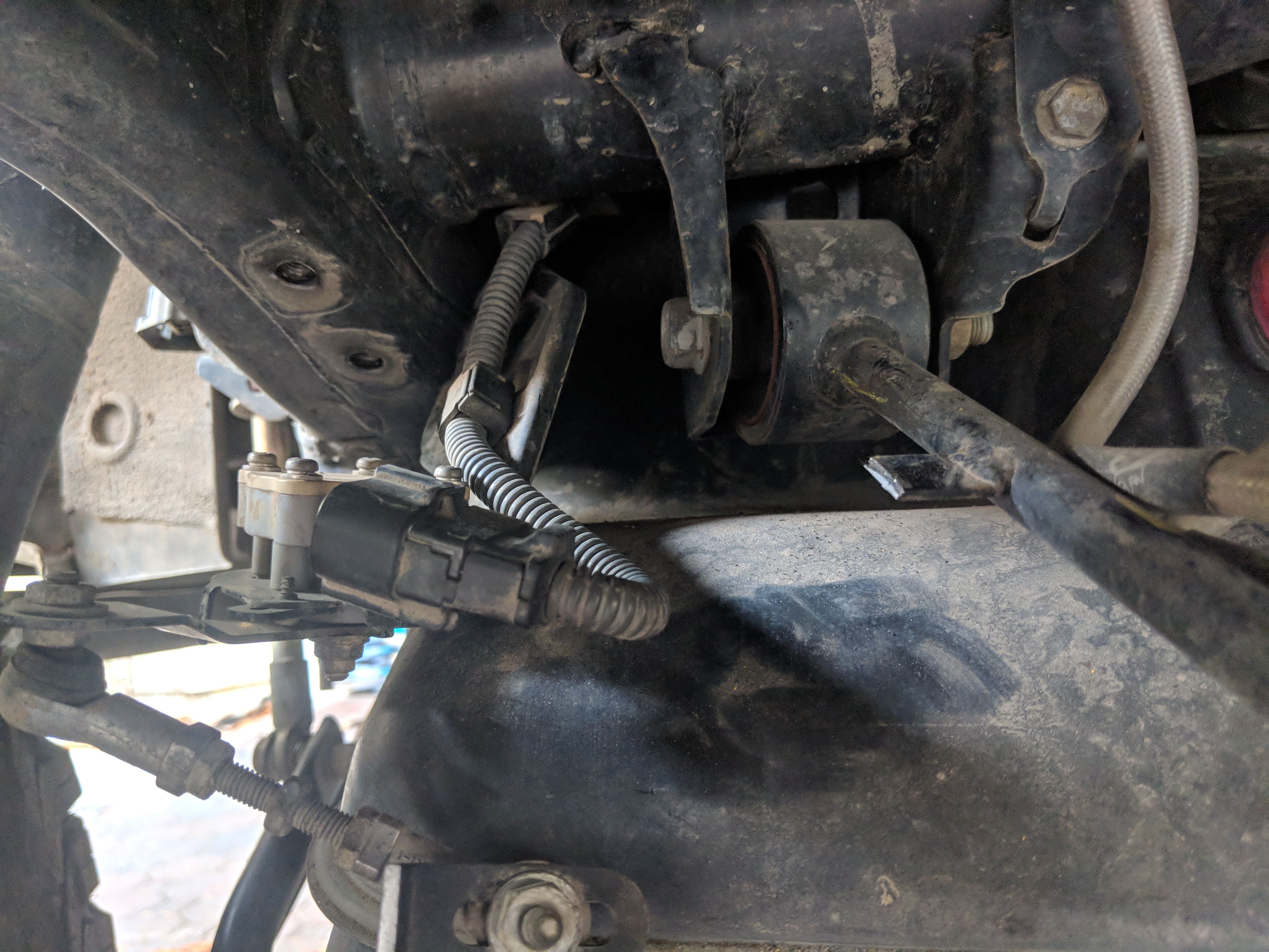

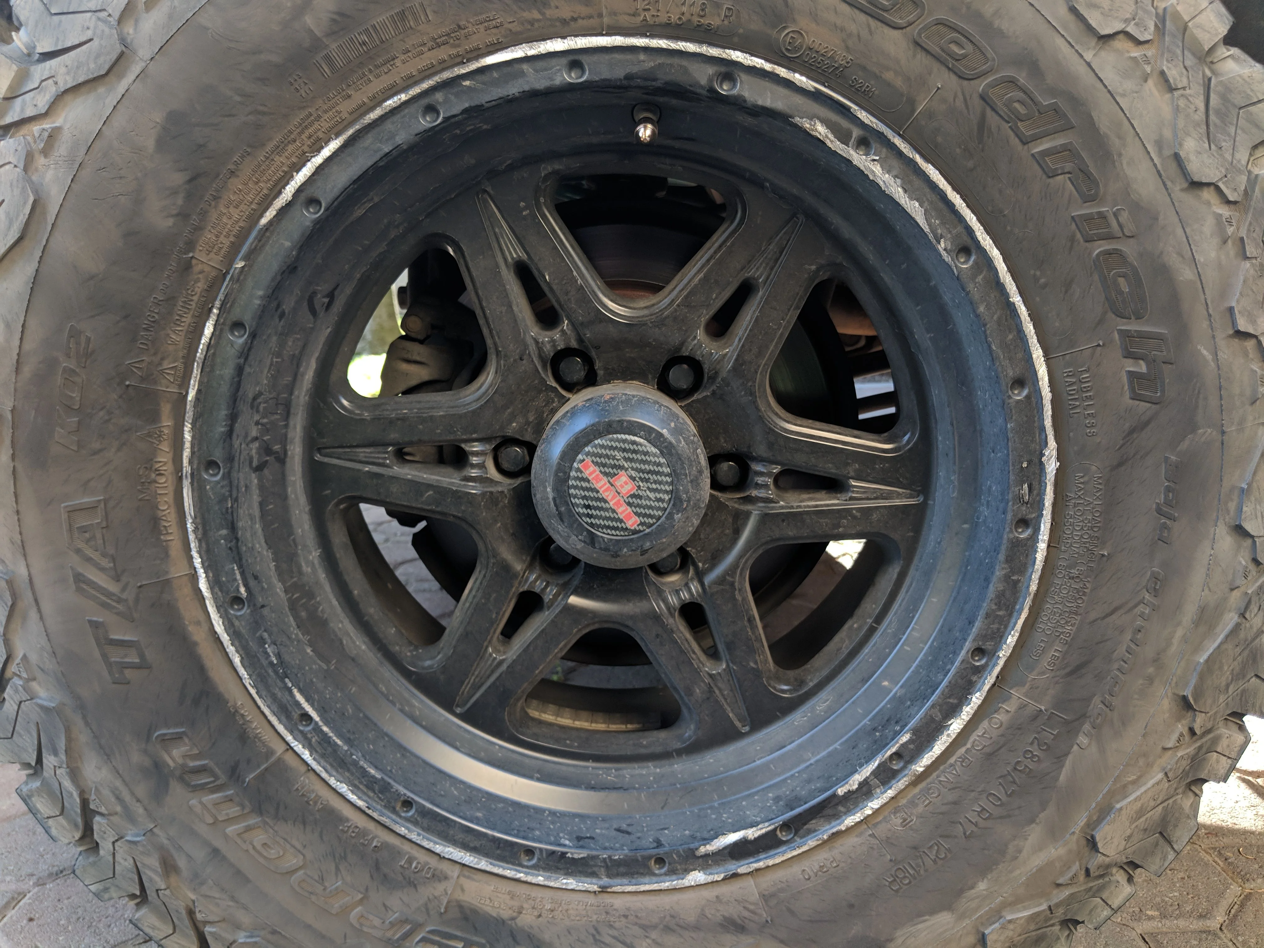

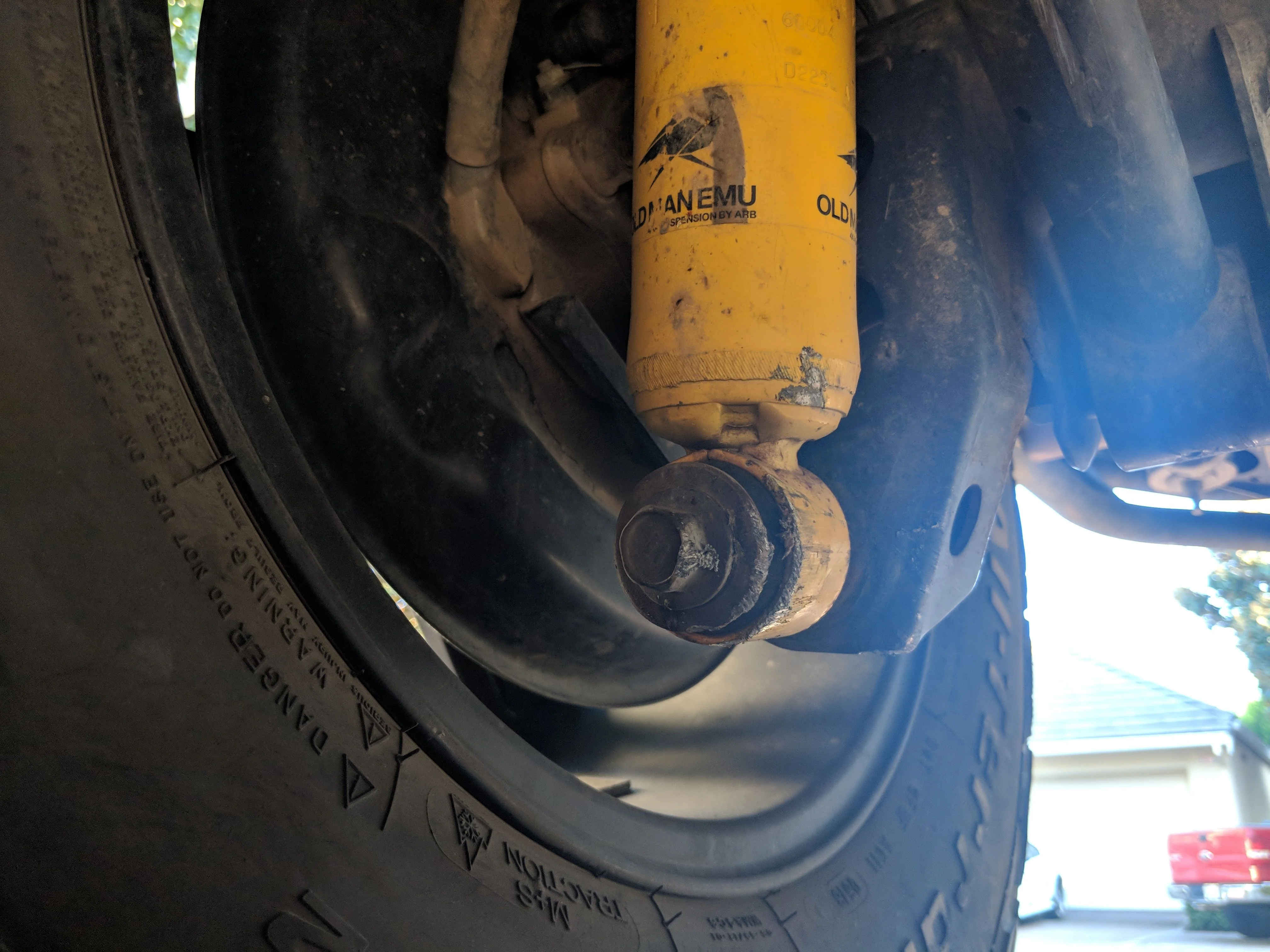

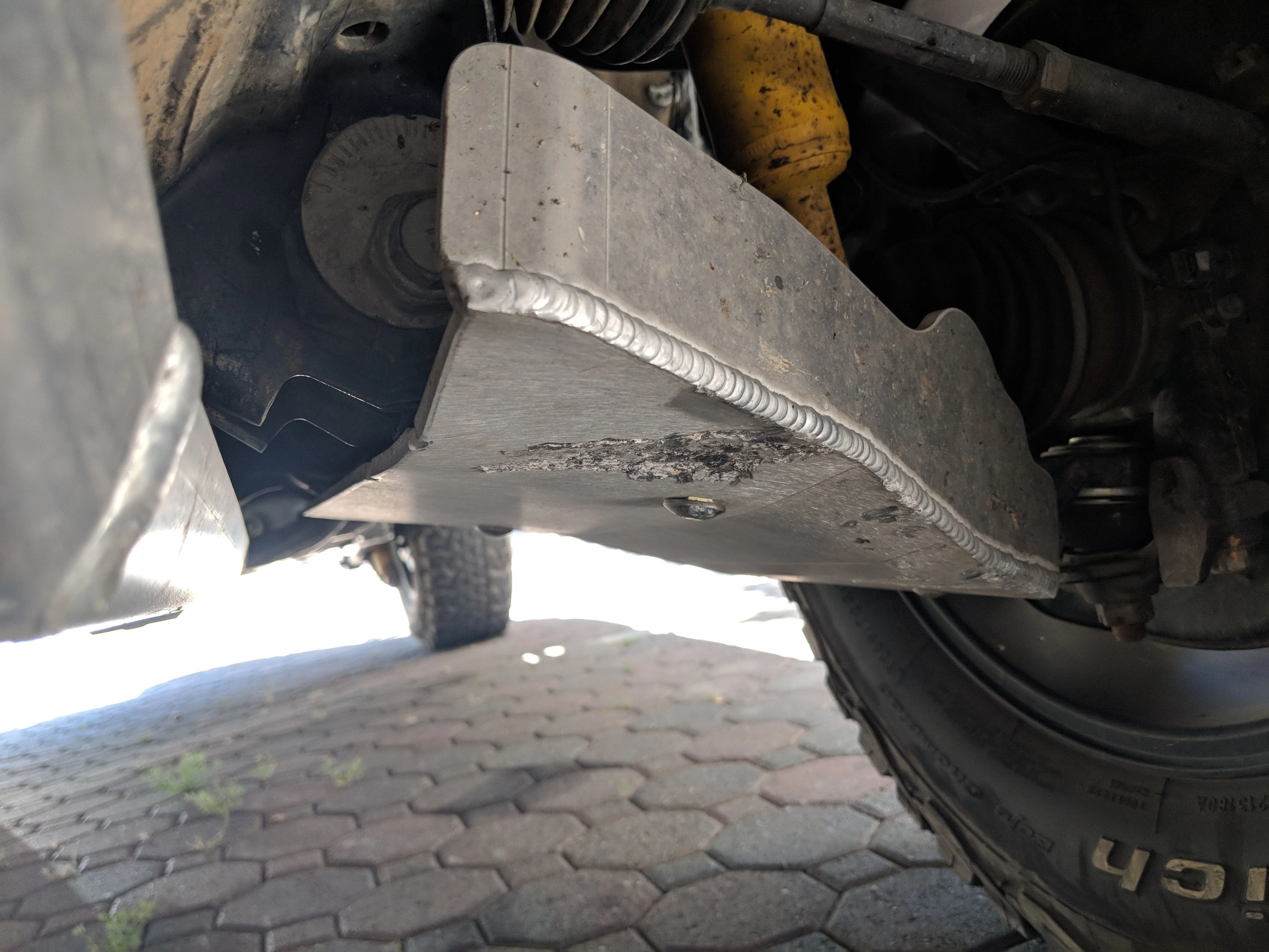

Also bent one of my rear lower arms a bit, roughed up the lower shock mounts and scratched all our wheels pretty good:
I already have new lower links on order, and I'll be making some adjustable upper ones to match. I also think I'm going to weld some support brackets for the skid plates.
The real solution is bigger tires and better driving :p :steer:
