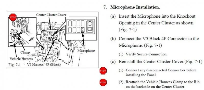

The install instructions say, "Automatic Transmission and Off-road Package" conflict on 2013 models. There are many connectors that could cause an issue, but the first thing I thought of was the knockout in the center console where the Glass Breakage Sensor goes. Is there already a switch in that spot?
Alarm
No. There is no switch at that knockout location. Can you post a link to those instructions? I found a link to some older instructions (circa 2008). Nothing that referenced 2013.
