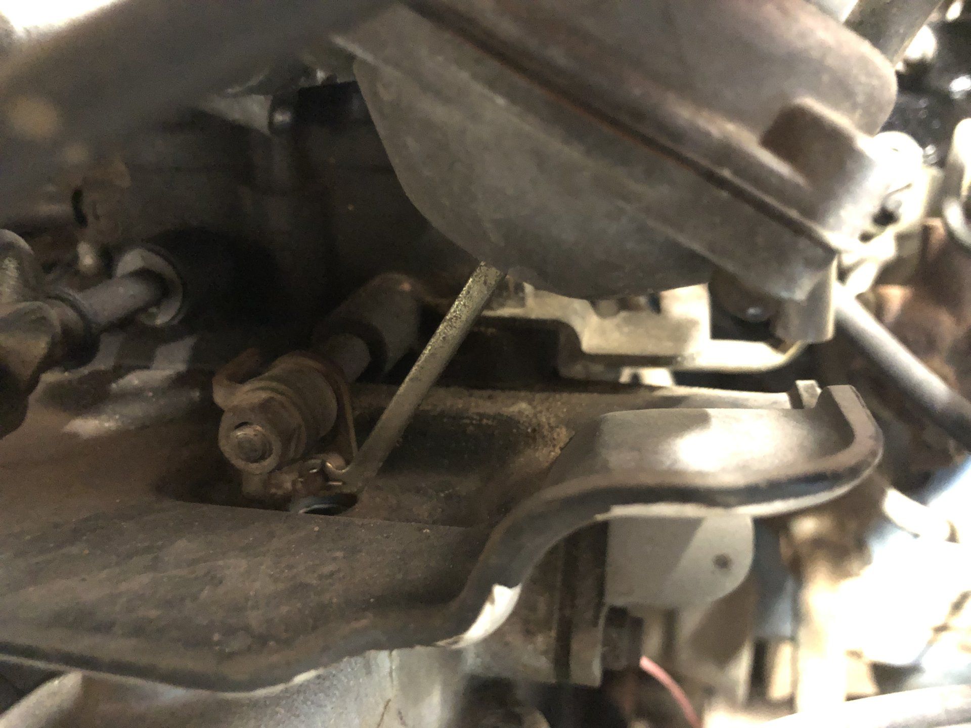

im thinking that my issue is that my secondary on the carb isnt opening up, i tried the paper clip test and its been on there for a week with no movement
with the carb installed i can turn the throttle and then move the secondary and i am pretty sure i can see the butterfly move
could it be as simple as bending the lip that mechanically opens the secondary so that it opens more for vacuum to occur

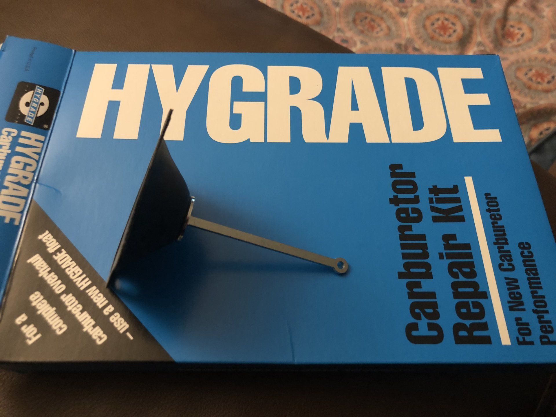

If your engine is pulling 20” and failing the paper clip test, replace the secondary diaphragm and go from there. Should be able to swap it while the carb is still bolted down. Can’t remember if Toyota still has the secondary available. I know the diaphragm that comes in the Hygrade 791B kit needs to be bent to fit. I’ve done it once and that rig is running well AFAIK.
Diaphragm arm on my carb, not OEM part but was correct. Can’t remember the brand on that one. Just know it was an orange box.

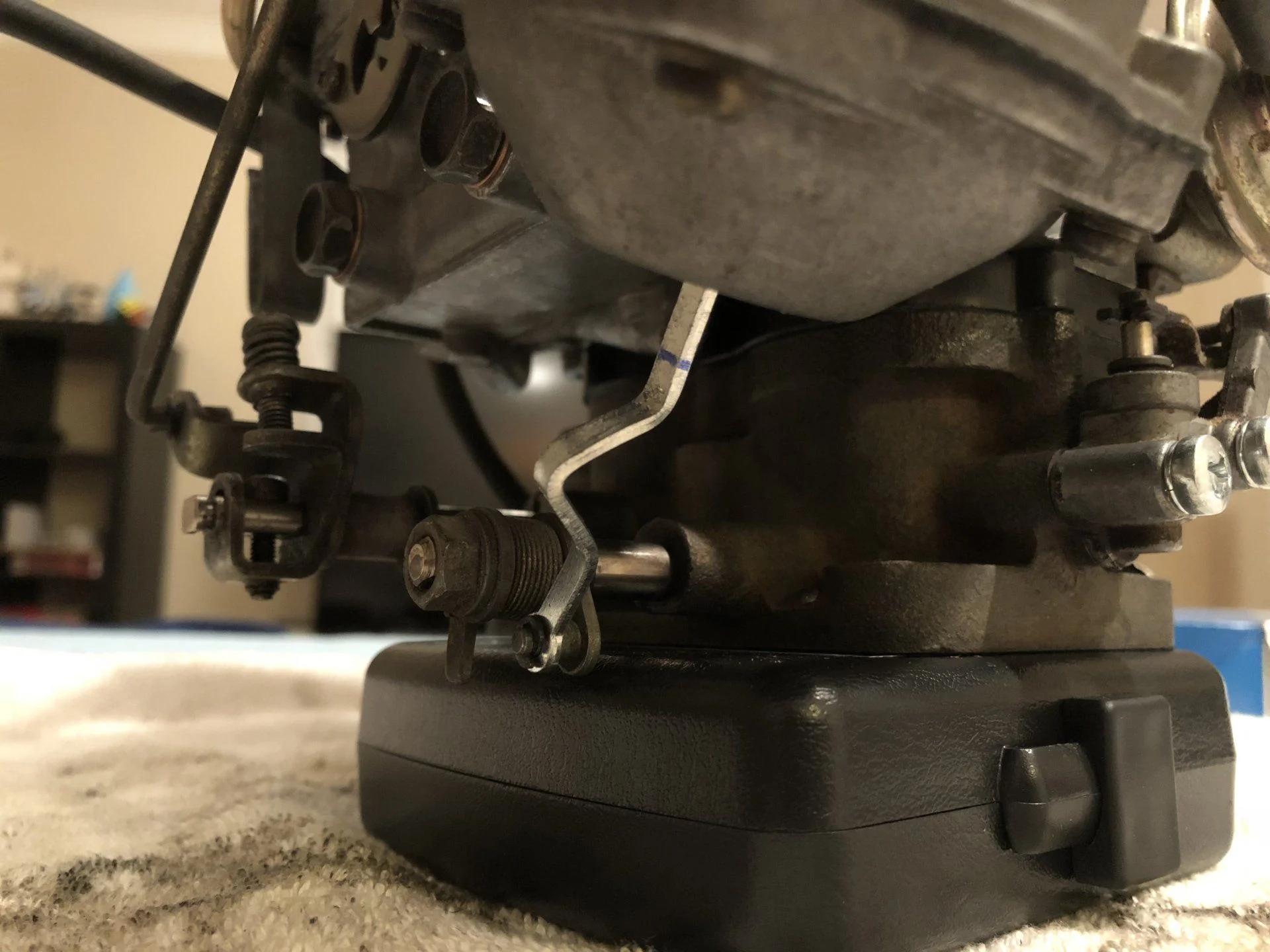

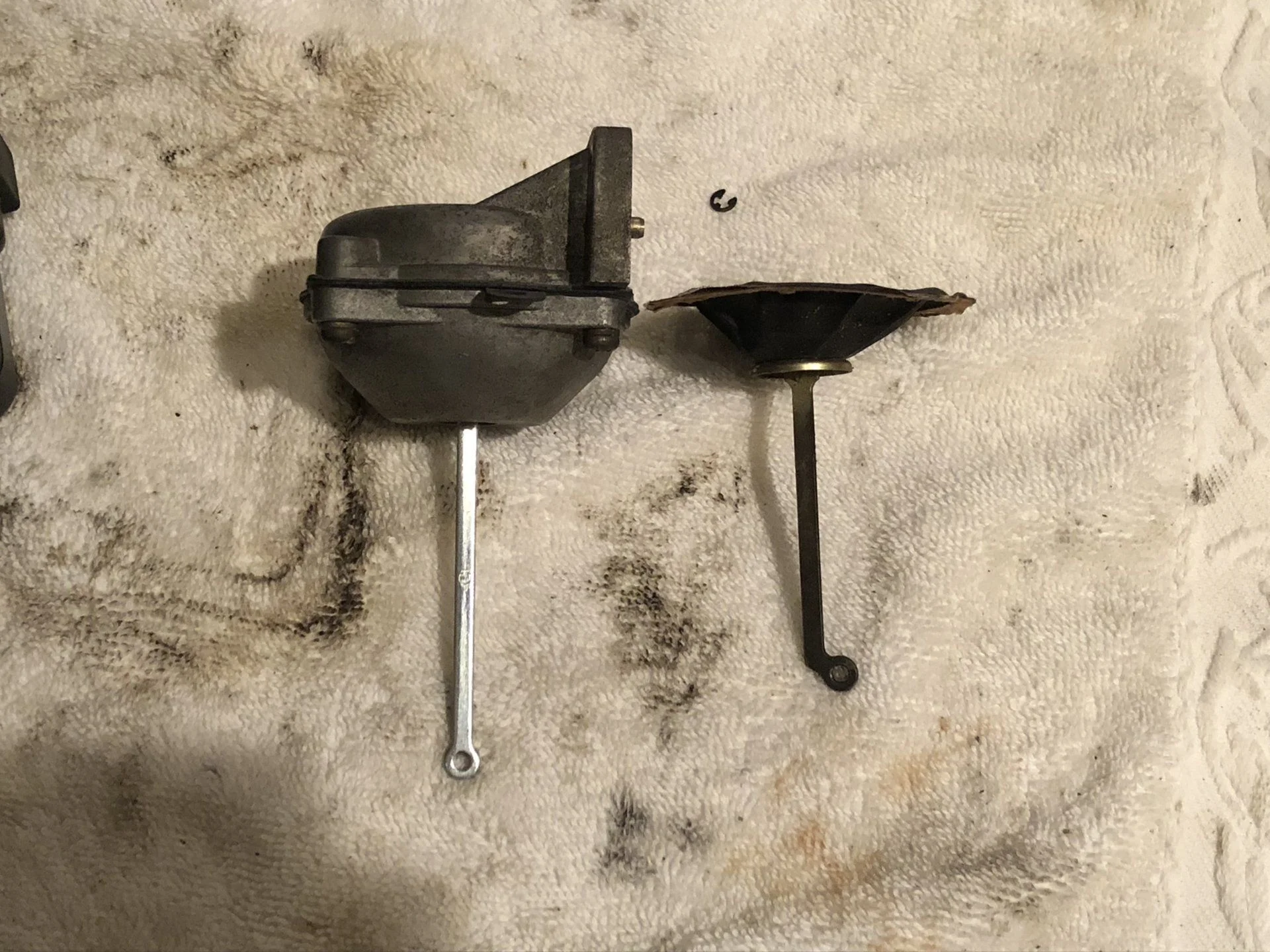

Found some better pics to show what I’m talking about.
Hygrade in the diaphragm body with stock next to it
Installed
See the blue sharpie mark on the new arm? Marked that to make sure to do the bend low enough on the arm to not interfere with the body.
HTH
