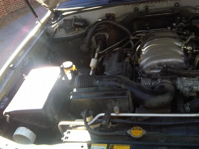

in your post #5 can you post me a pic of that where that component lives in the engine bay?

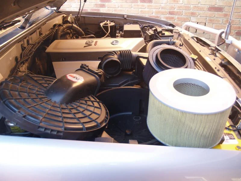

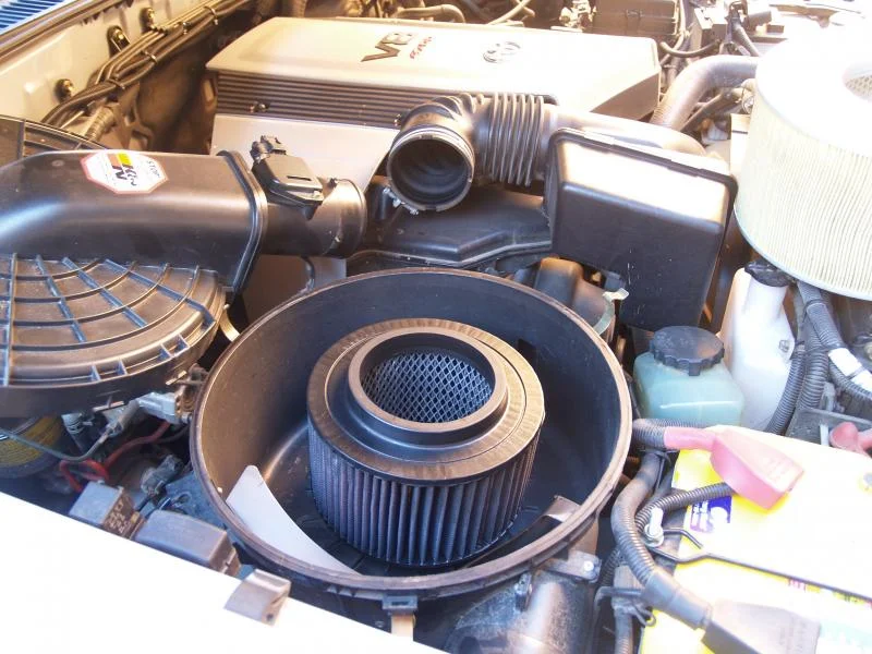

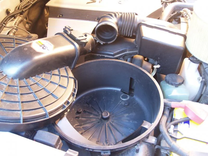

ok.

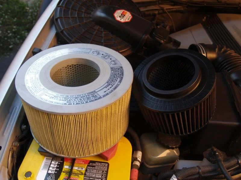

here's a few , but with the plastic engine cover still on.

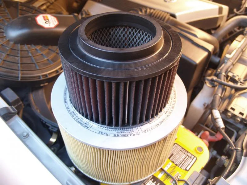

There was a post on here about the MAF sensor being compromised courtesy of the K&N....well i checked post air box and it's clean. Nothing. But now summer is here, i''ve put back in the factory Toyota air filter.
You can see how much bigger the Toyota cleaner is v K&N.
Pics are pretty much self-explanatory.
Comment if you want more info.

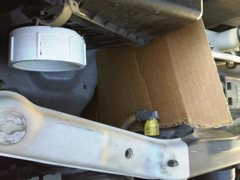

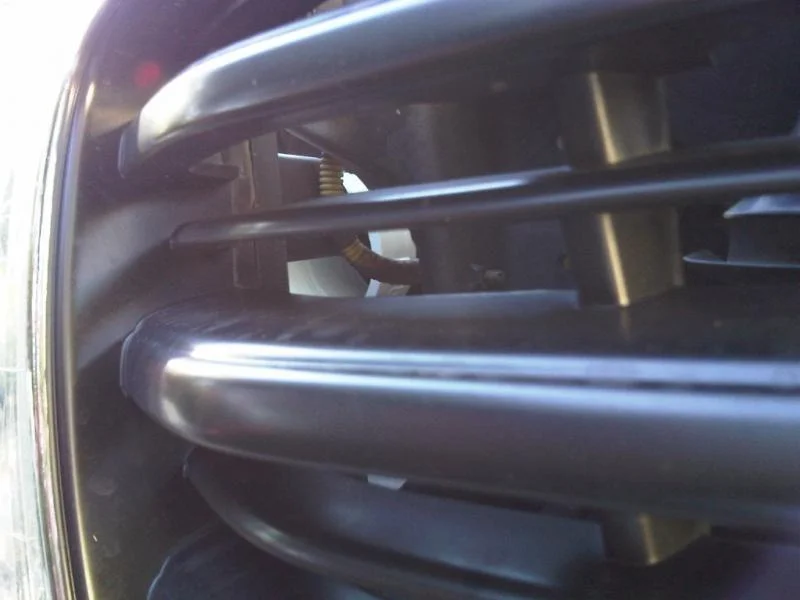

I've checked out the airbox mod i mentioned above...it is definately a bottleneck for me.
Finally i have a project i can actually do.

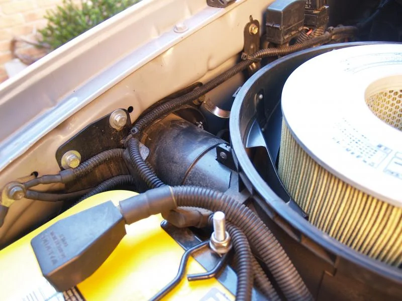

pics follow
peter
and just a close up of where it joins the inner guard
and i DO have the restriction as per that 4wdaction thread link i post up earlier.
so the guys at the Horse Power Factory where i got my cruiser dynoed at 84.3kW and said it was the snorkel.......they were on the ball.

IIRC the biggest reason people don't like the K&N FIPK kit is due to the fact that the oil fouls the MAF sensor, right? Just go buy an AEM dry-flow filter of the same size and switch it for the oiled one, and sell the K&N filter to recoup some of the cost. Shouldn't be too hard to find an identical AEM replacement since they are owned by K&N now.
Just a thought.
yep thats what i've been told by an earlier post maybe on this thread or another...the MAF sensor issue that is.
To be honest, K&N V Factory....i thought i noticed a difference, but after experimenting....i think it's a "mind thing"....but hey i dunno...i've checked post air filter/cleaner using both...and theres no difference. The K&N is dirtier to handle and that's it....but....i'm back with OEM for the summer, as it, too, is cleanable.
