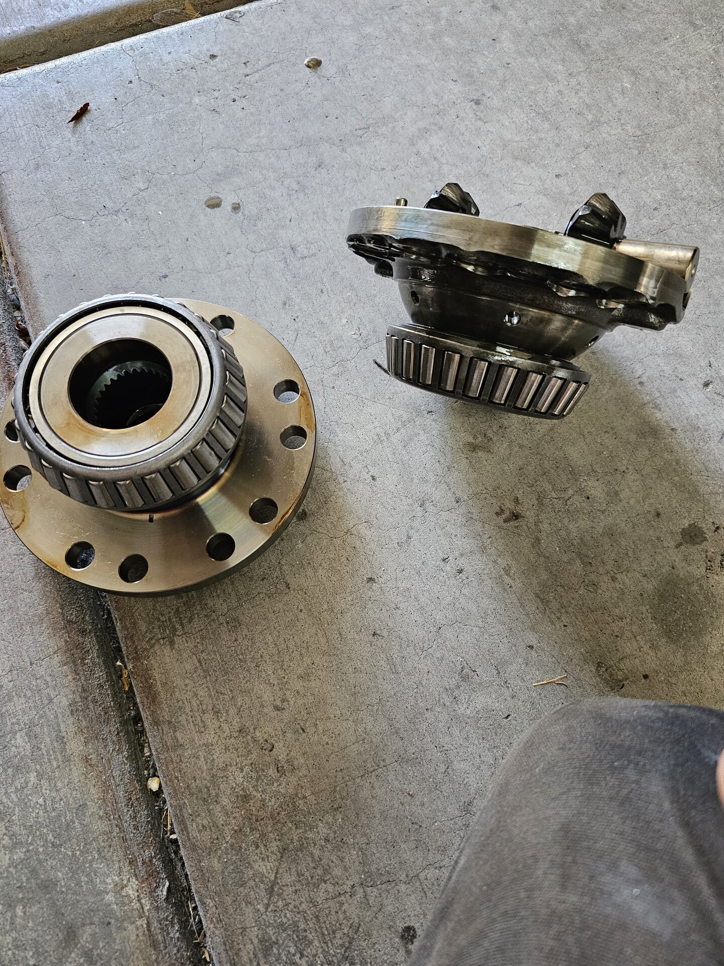

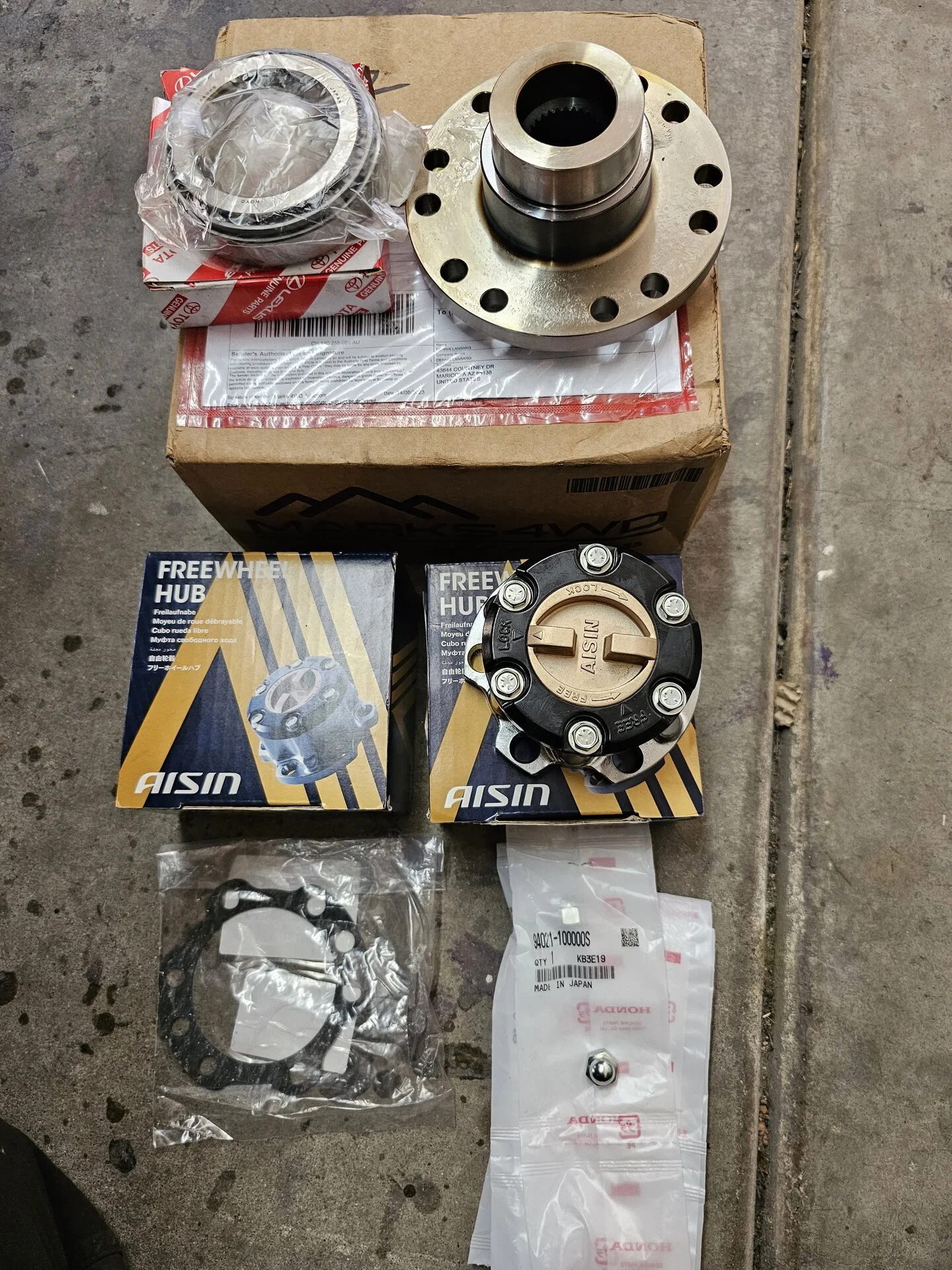

Hey guys I am very noob about how these things work , so I have a 2007 LX470 and I have ARB air lockers installed on front and rear and this rig is still under construction, I also purchased a part time 4WD kit that consists of Aisin hubs and Mark's 4WD part time spool.
I am trying to figure out how part time 4WD works when it comes to the transfer case, If I installed this part time kit, would this interfere or defeats the purpose with the front air locker that I just installed?
Again , as I disclaimed above , I do not know how these work and it is a dumb question. Basically what I wanted to know if I installed this 4WD part time kit with my front air lockers do I have the best of both worlds?
some pictures for viewing pleasure:

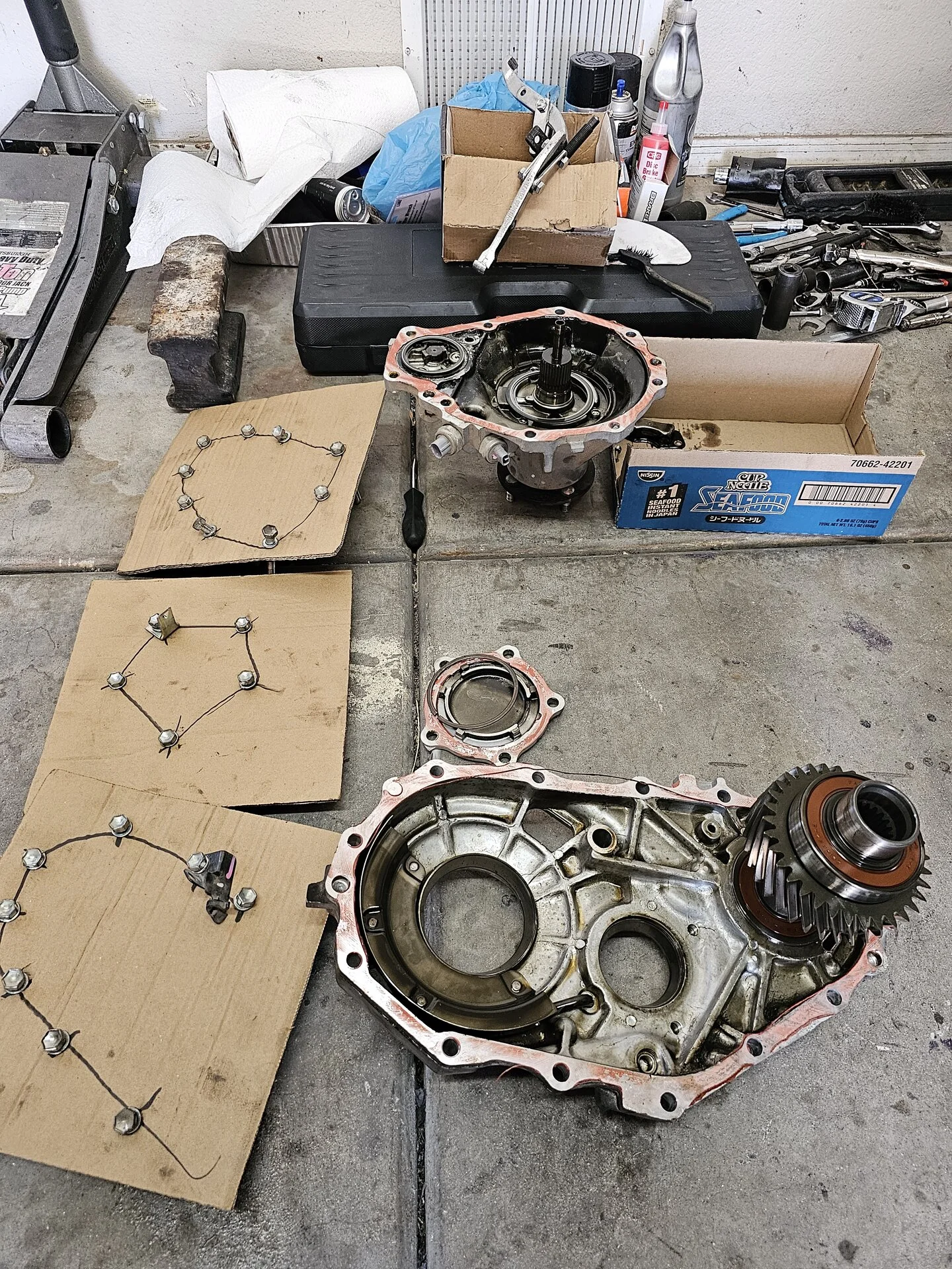

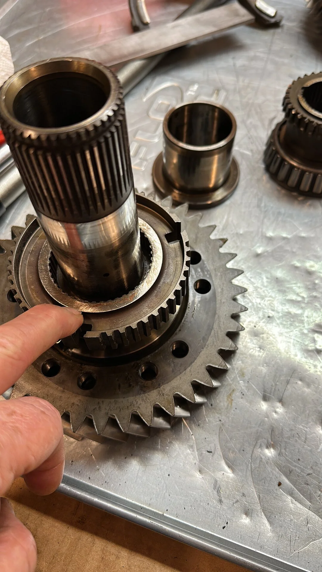

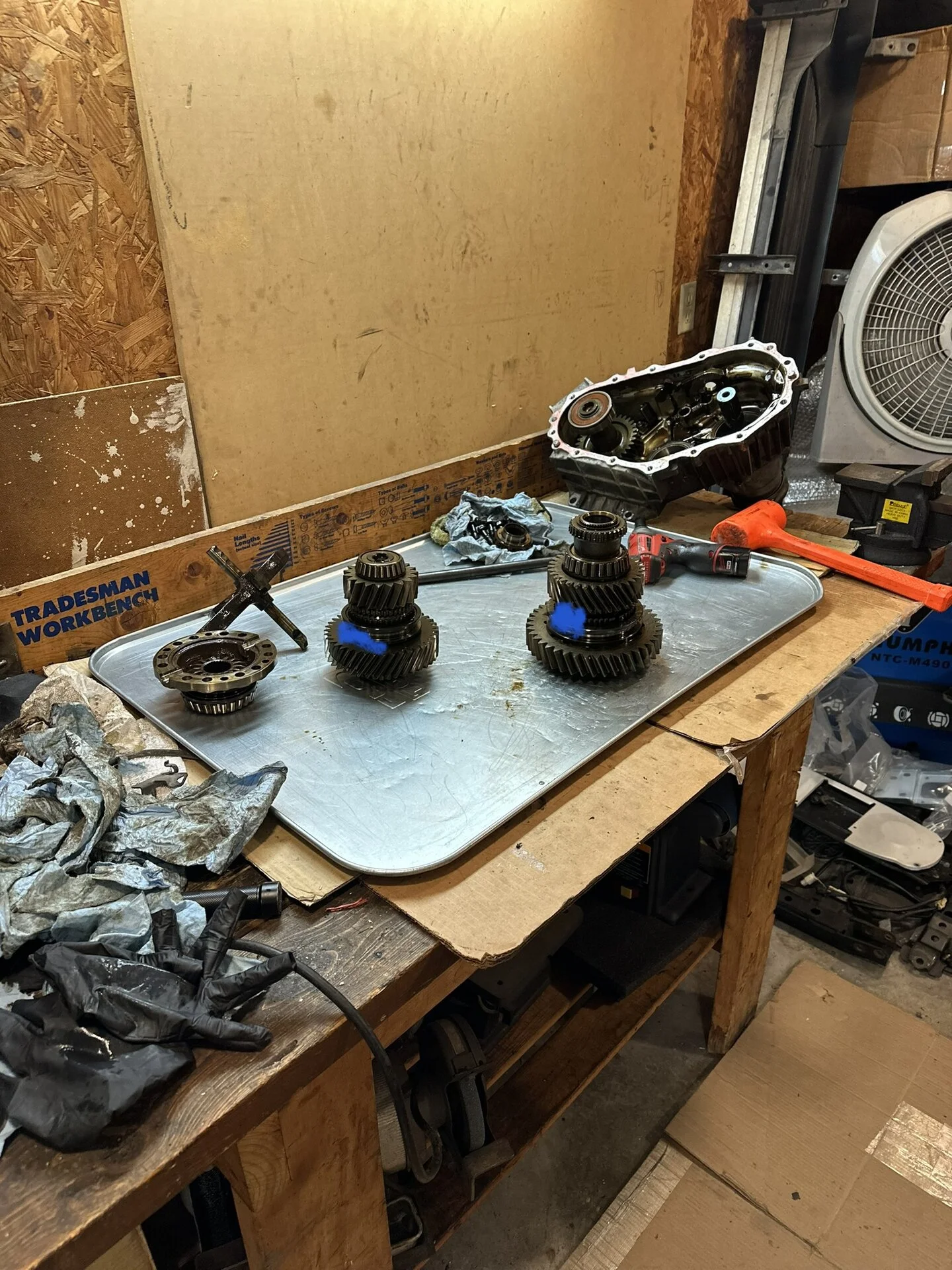

Yes I am in the middle of that project too. You will need a press … And helps to have certain bearing removal tools.

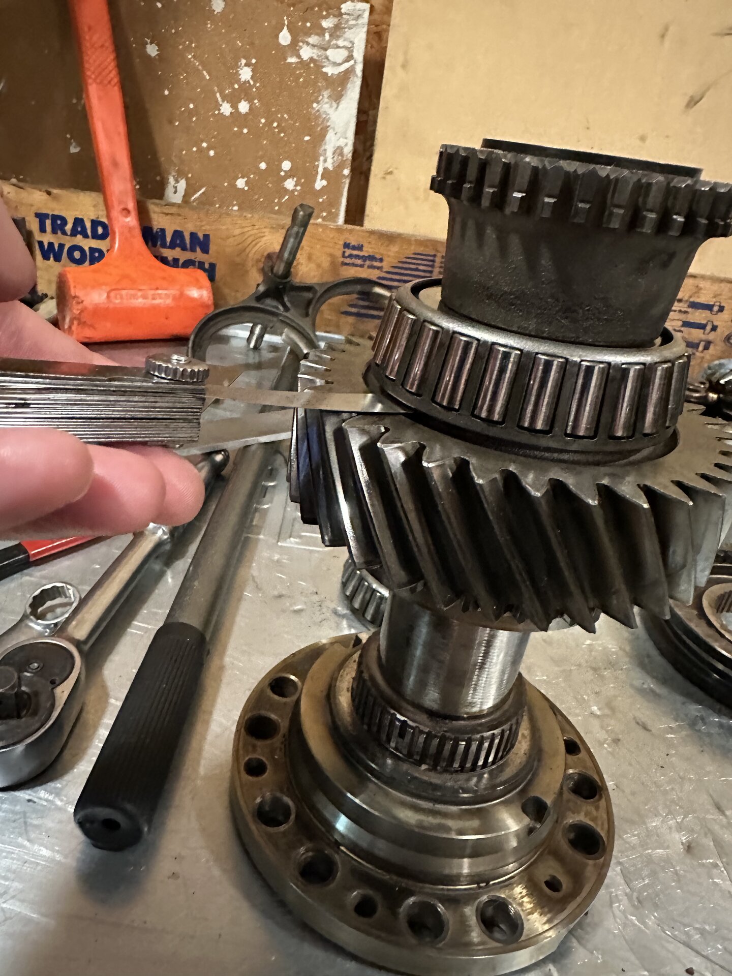

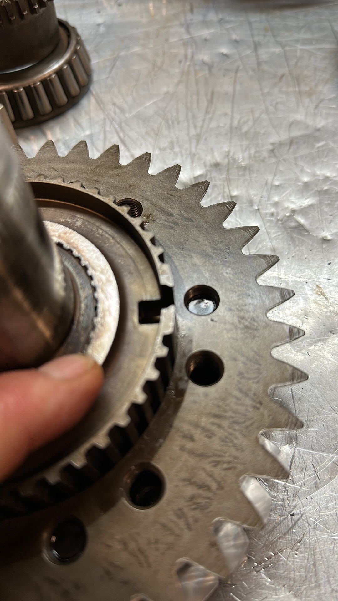

Now , before disassemble the main output shaft down load and refer to measure the hi speed gear clearance before pressing it apart.

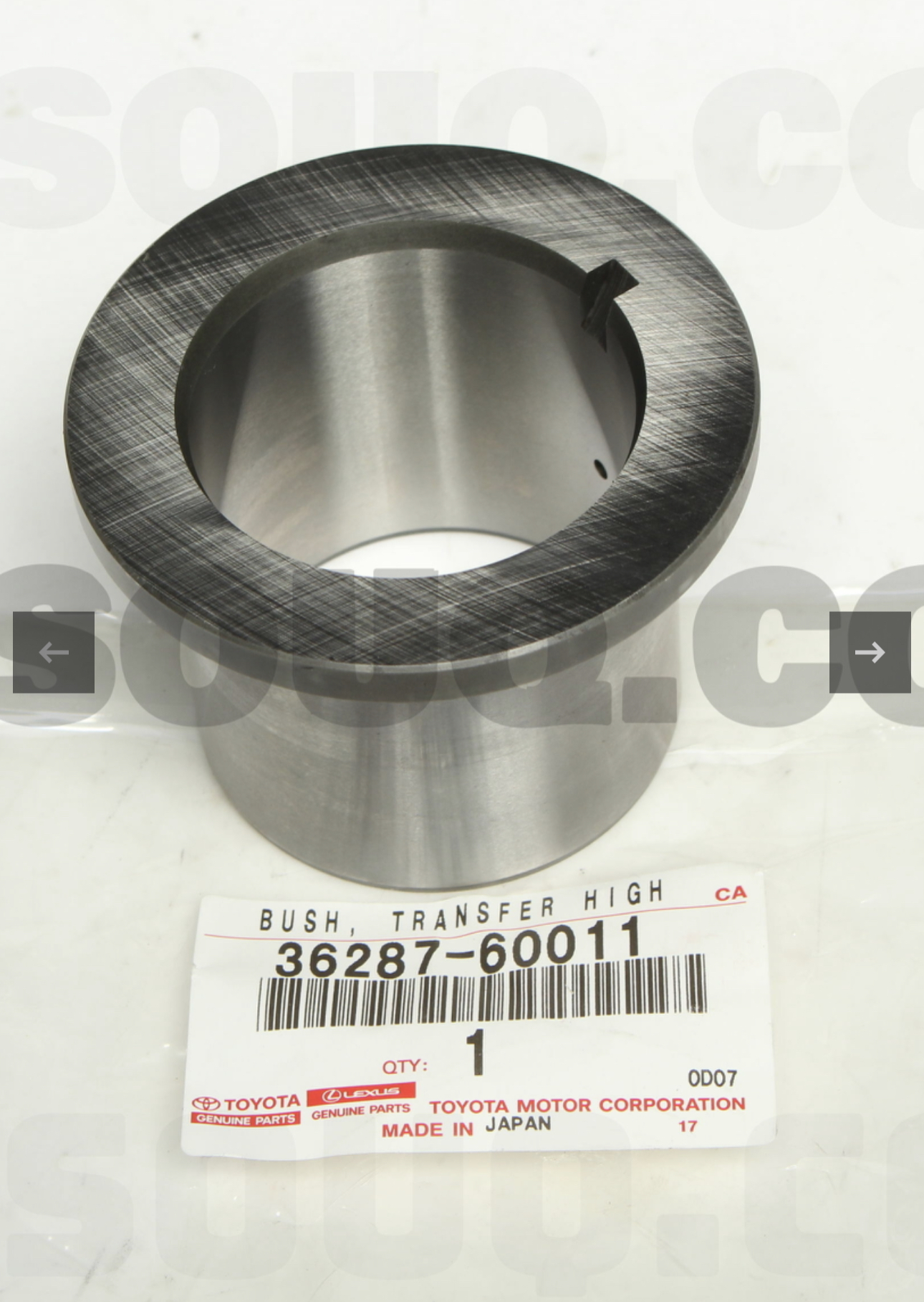

The clearance was too much on mine and had to Oder parts. My parts from Japan have not showed up yet. Dealer said this one part wasn’t available in the US. But I order two one thought USA dealer network and 3 parts total from Japan. The USA supplied one showed up, I have an extra one now afraid if would back order from Japan. Or Vice versa
Now a consideration do the underdrive 10% while you are there. Cruisers… in Utah sell the kits, take two part numbers to make it work. Another guy claims better performance and fuel mileage doing part time and underdrive together.
I also did the low range Marks gear change too.
Good luck!

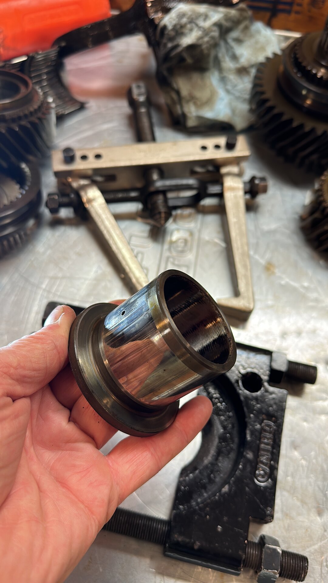

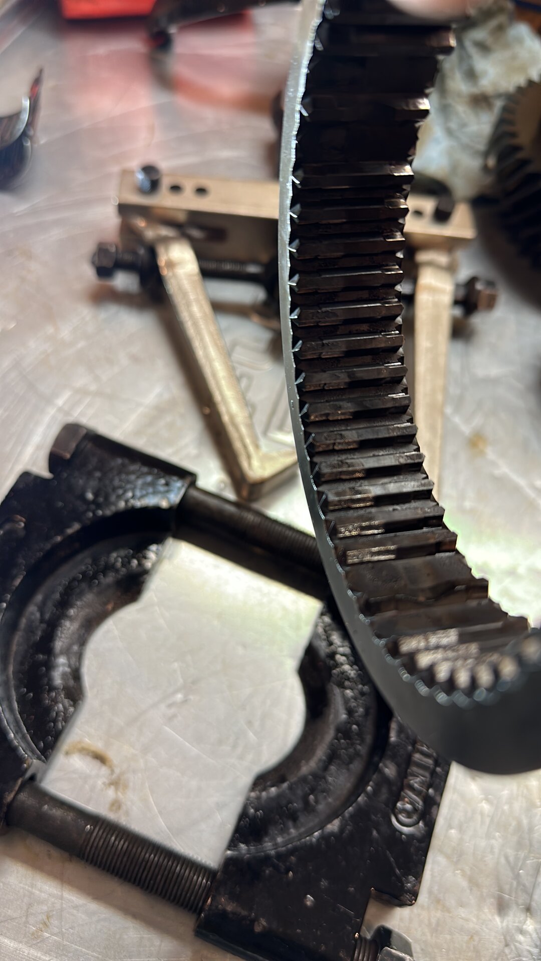

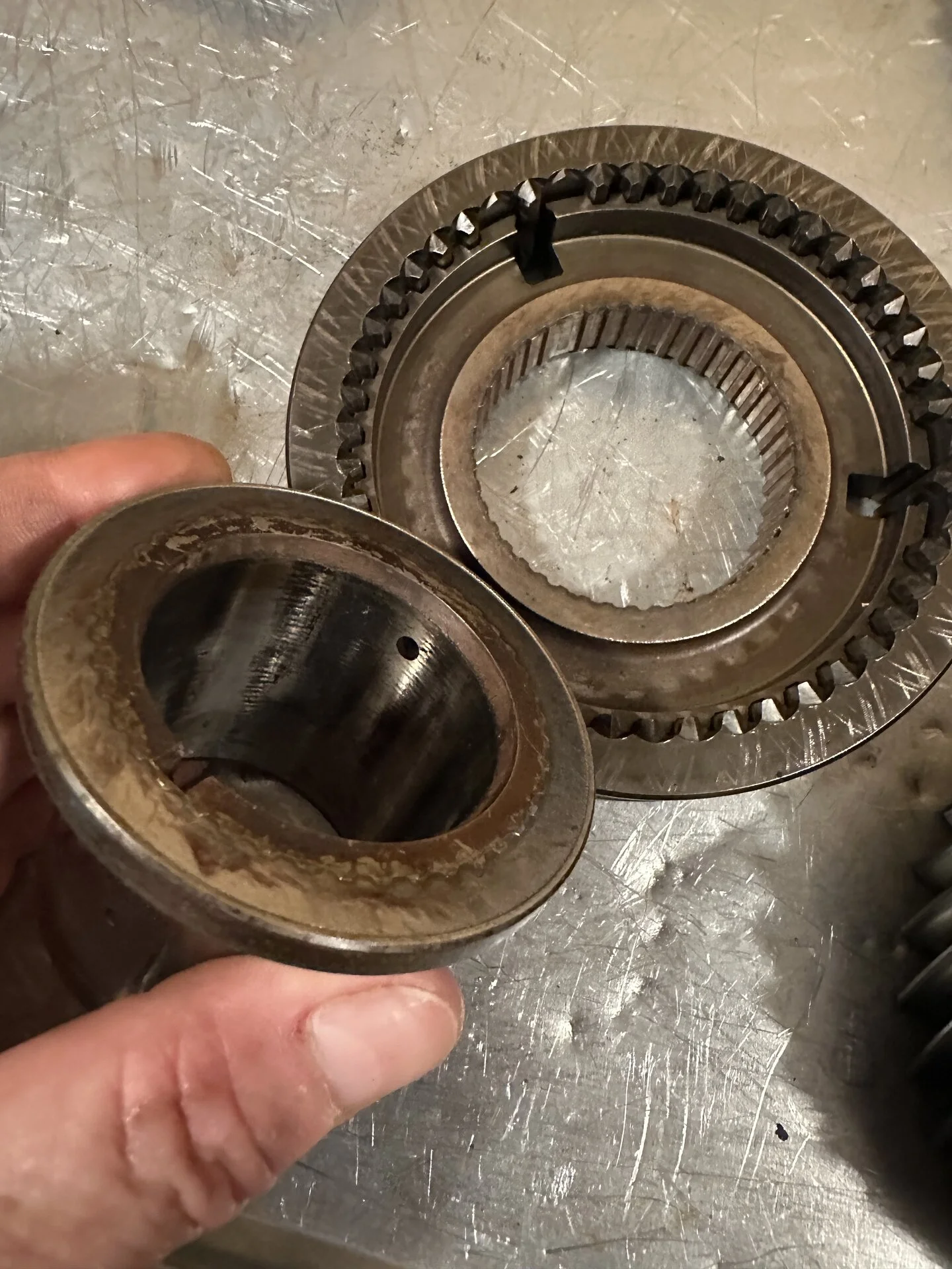

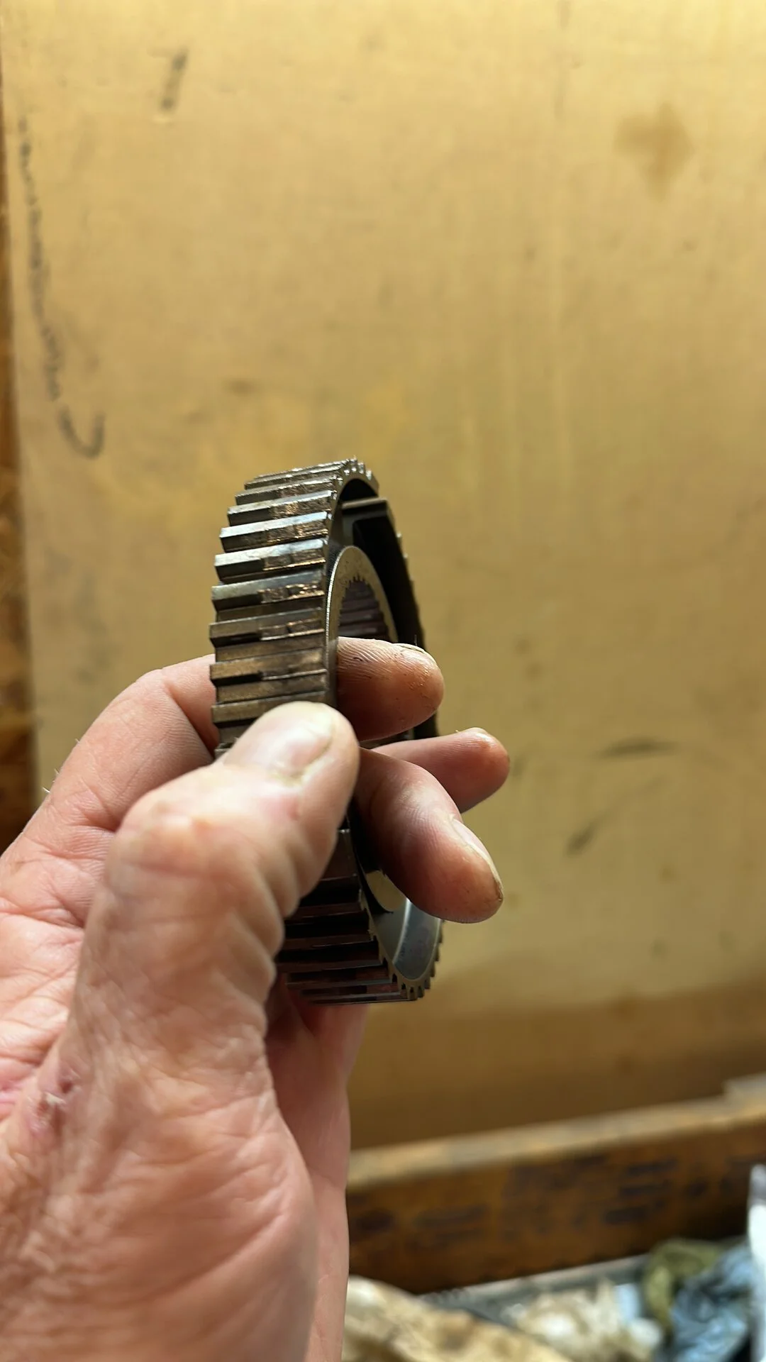

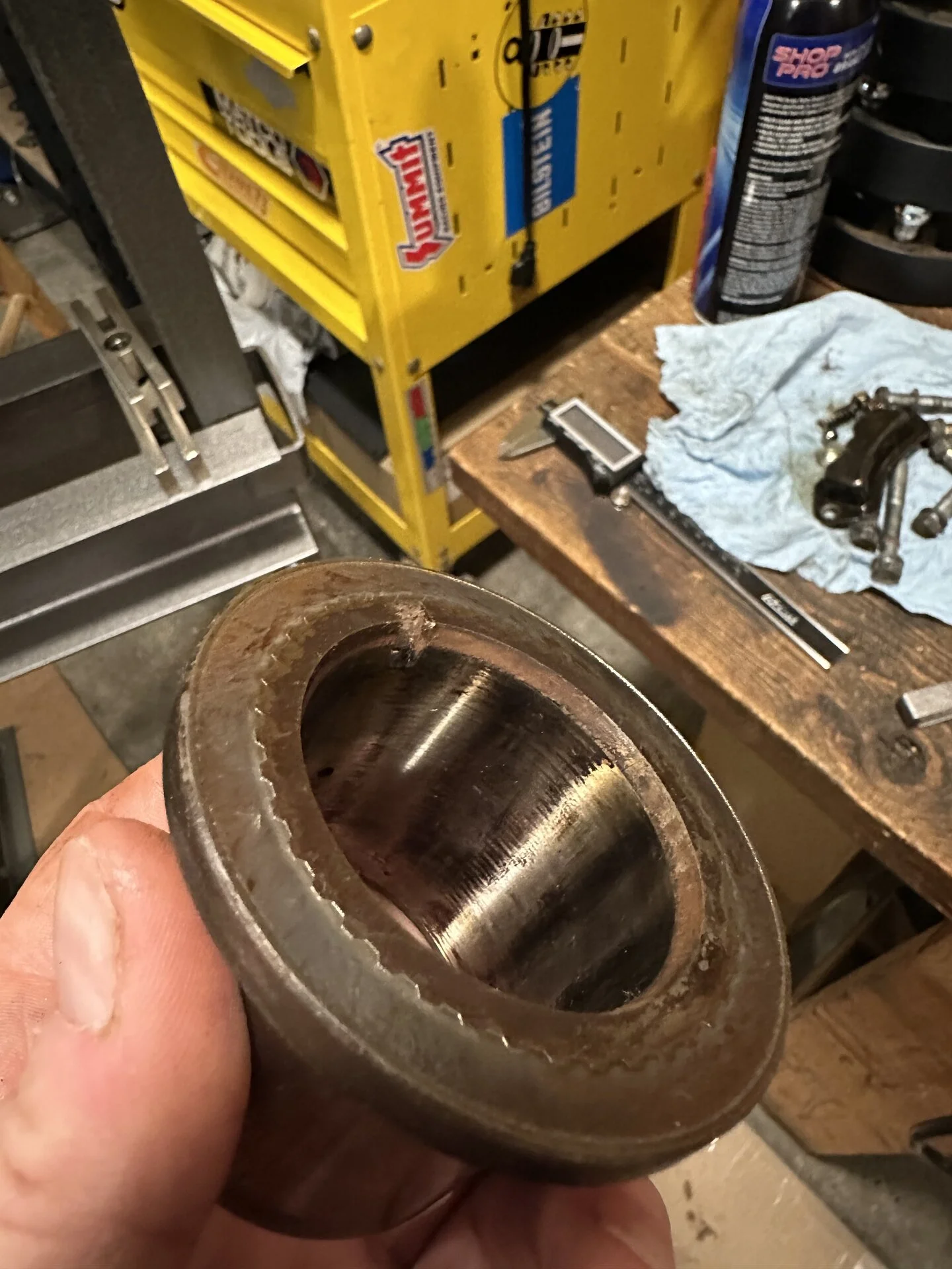

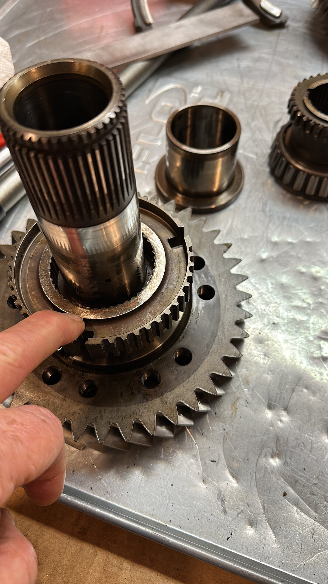

Here next set of pictures wear on hi speed sleeve to hi speed hub
Opened clearance to .022 inch instead of max .0098 call it .010 inches max

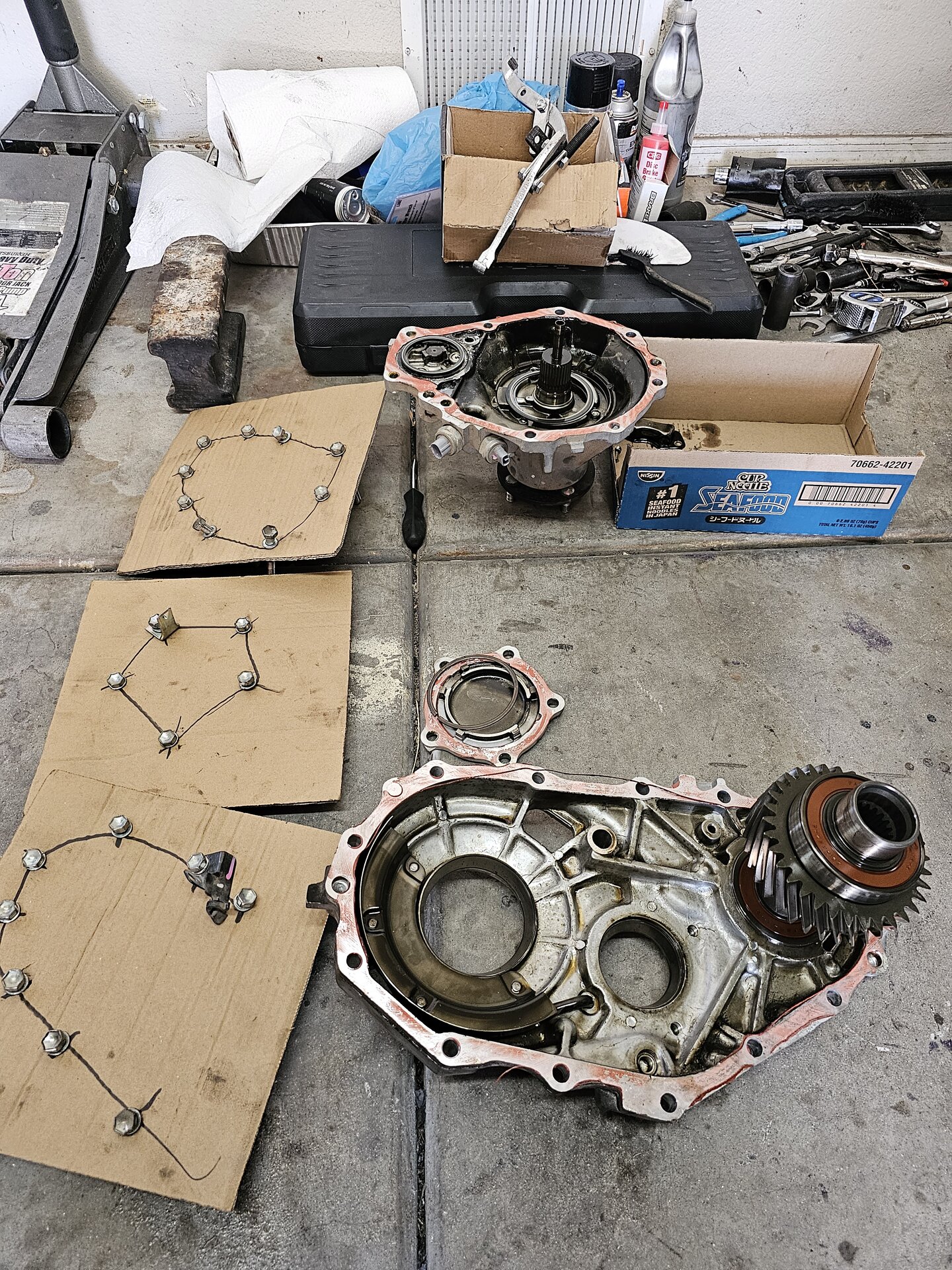

Why do you have to take everything apart? I just have to change my spool like everyone else.
Changing the low speed you have to press apart the output shaft to change the large gear… And idler shaft bearing to change the smaller gear.
Right… then you don’t have to go deeper … I did and found some abnormal wear … stand corrected no press or puller needed if you replace the bearing with a new one.
Have you got your back
Together and driving yet?
