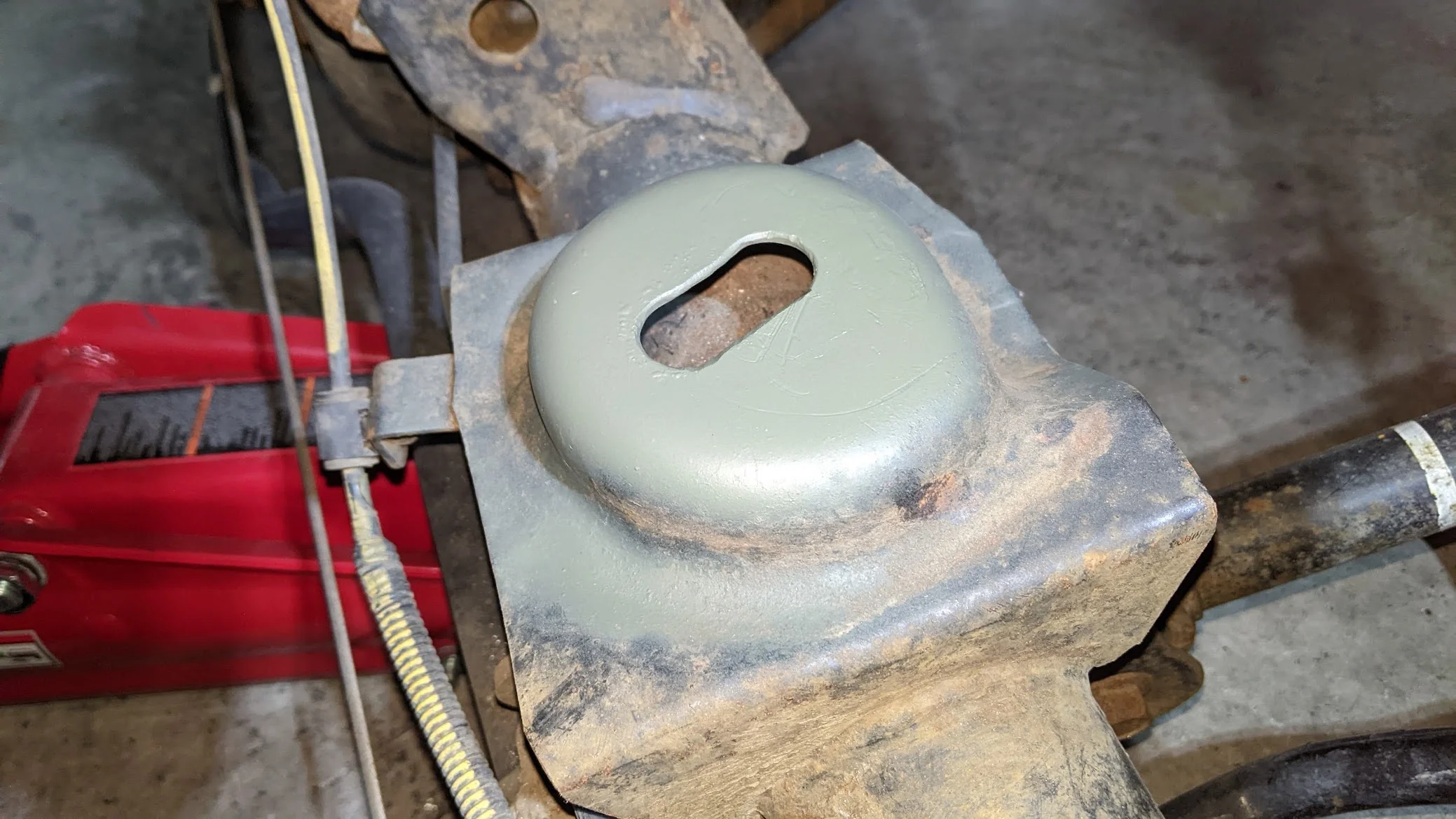

What I did was drill a second hole of I want to say 3/4" or 1" almost directly aft and just a smidge outboard on each side (the line didn't sit dead center for me). I located the new hole so that the outer edge of the hole just barely overlapped the existing one, then I used a dremel cutter to open it up to an oval, and finished off for good measure beveling the edge with a hand file (probably doesn't matter but what the hey).
Here are a couple pictures of what it looked like after I opened up the hole, and what it looks like with the spring installed.

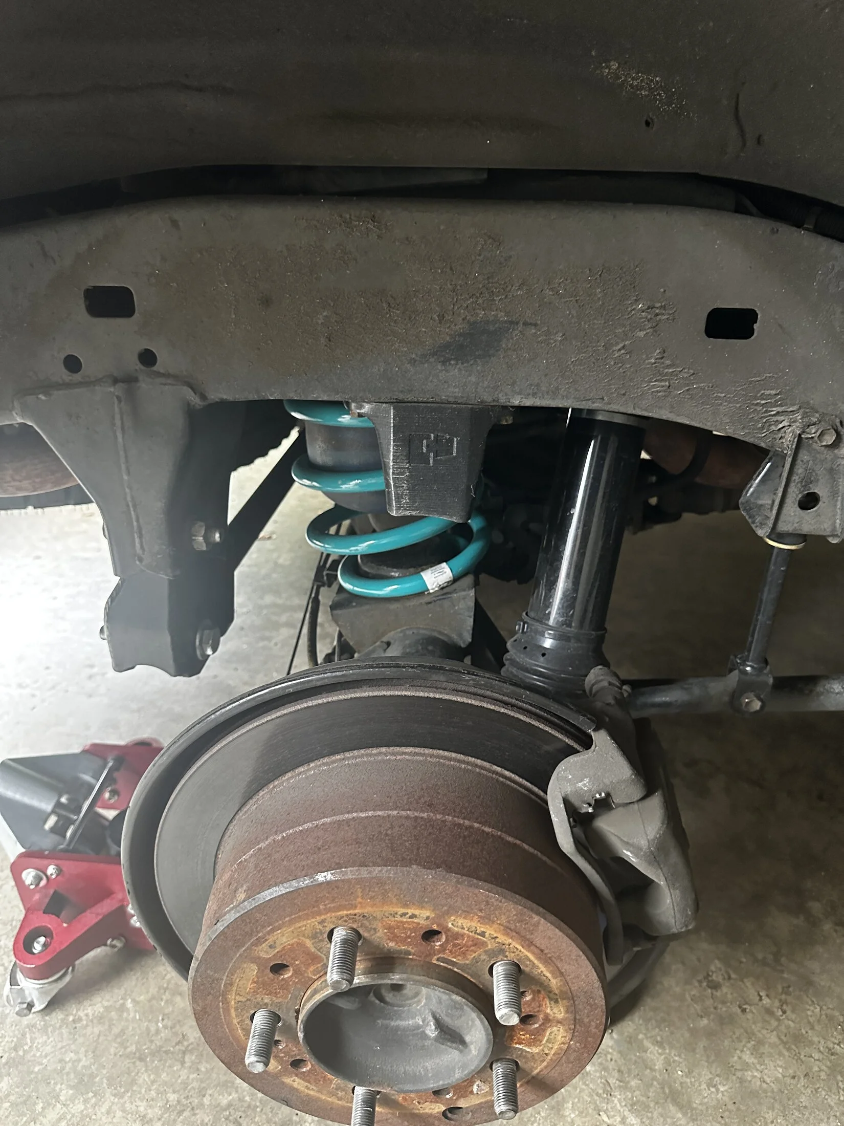

PS I have to run pretty close to the 30 psi limit with all my junk loaded, but I'm probably pushing things right up to the limit on tongue weight. For reference, I have medium Ironman springs plus I think 20mm spring spacers in the back as well. I added a picture of what it looks like, it's actually not quite level but pretty close, and it doesn't bottom out anymore!

I may be thinking about this wrong, but I think the spacer will add height in addition to the air lift. It is true that the air bag does the majority of the work by keeping the spring from compressing as much, basically increasing the spring rate. But the spacer sits on top of said stiffer spring so it's still going to add a tiny boost overall. With hindsight I wish I had done taller spacers. But they are definitely not going to solve the problem you have without stiffer springs or the air bags. I was sagging waaaay down with the setup in the picture above before the air bags, and routinely was having the tires hit the body (too much offset on those wheels). 30mm of spacer is not going to solve that problem!
