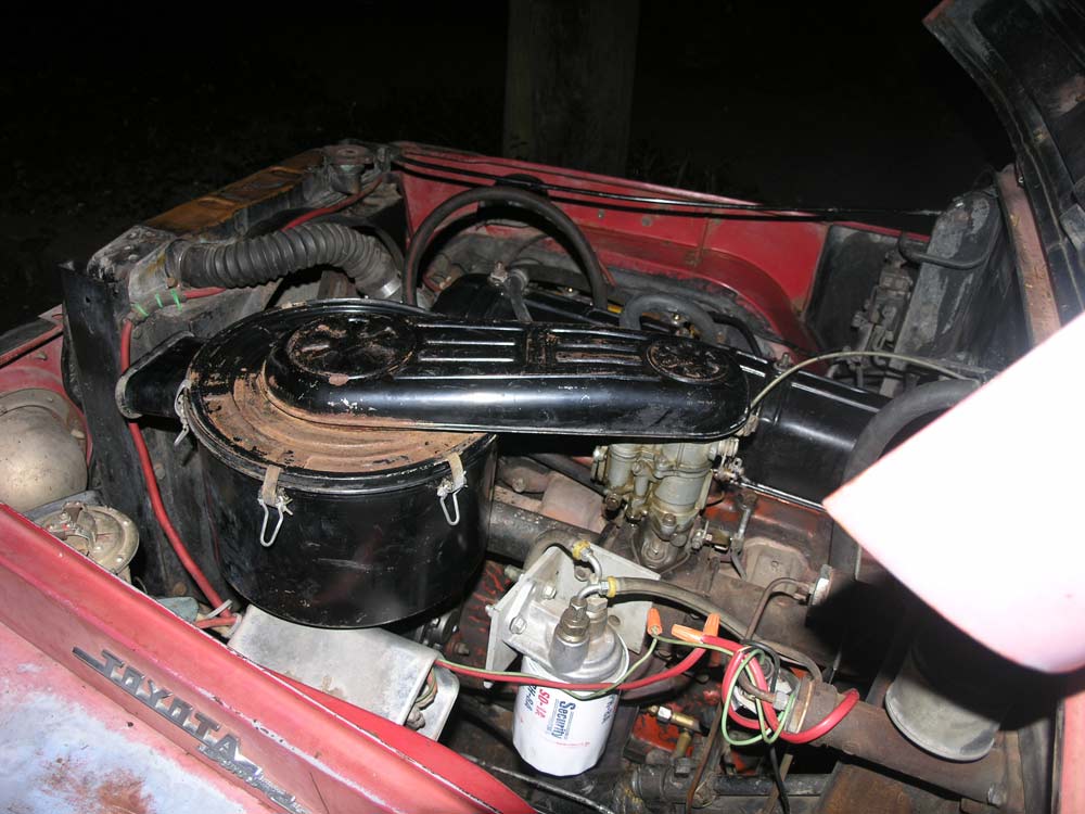

Heya all
What are you guys using in the way of air filters for your older fj?
Mine has old metal meshing rolled conically for the filter.
I imagine i can just clean this and re-roll it.
What do you guys use in the way of replacement filters?
Would a newer insert filter make a huge difference in the way it runs over the tight mesh metal filter?
Cheers!
Destin
ah weird
There is no oil in it now...
( the PO updated the oil filter to a newer type.. )
So the air filter container is supposed to contain oil?
I am not doubting you it just sounds weird :)
pretty straight up.....older vehicles had oil bath filters before paper filters became the norm....
They're more efficient at removing particles of all sizes as paper elements remove particles down to a certain size....
Clean the wire mesh in kerosene, fill the oil bath to the level indicator and roll on......just don't roll over and spill the oil.....

So how much oil would i put in there?
Would actually _having_ oil in their help it run better?
hehe
:D
I don't know if it'll run better but it'll filter the air like its supposed to....
My opinion is that the oil bath is far better than paper....It does need oil in it though....
The dirt inside the air filter cant follow the flow of air and falls trapped in the oil.....
Labyrinth principle at work....
