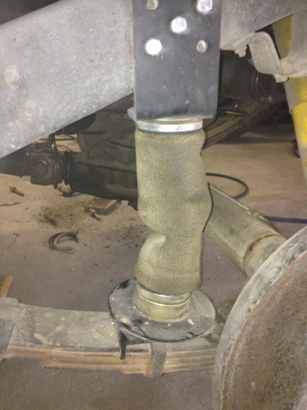

Installed these Firestone air springs. Say goodbye to Cronic tail sag and hello to adjustability and improved ride.
:cheers:

Initial impressions are that my truck now rides significantly smoother with enough pressure in the bags to lift the back 0.75" or so. Given that it weighs 2600lbs in the rear, the stock 60 pack in the rear tended to sag.
