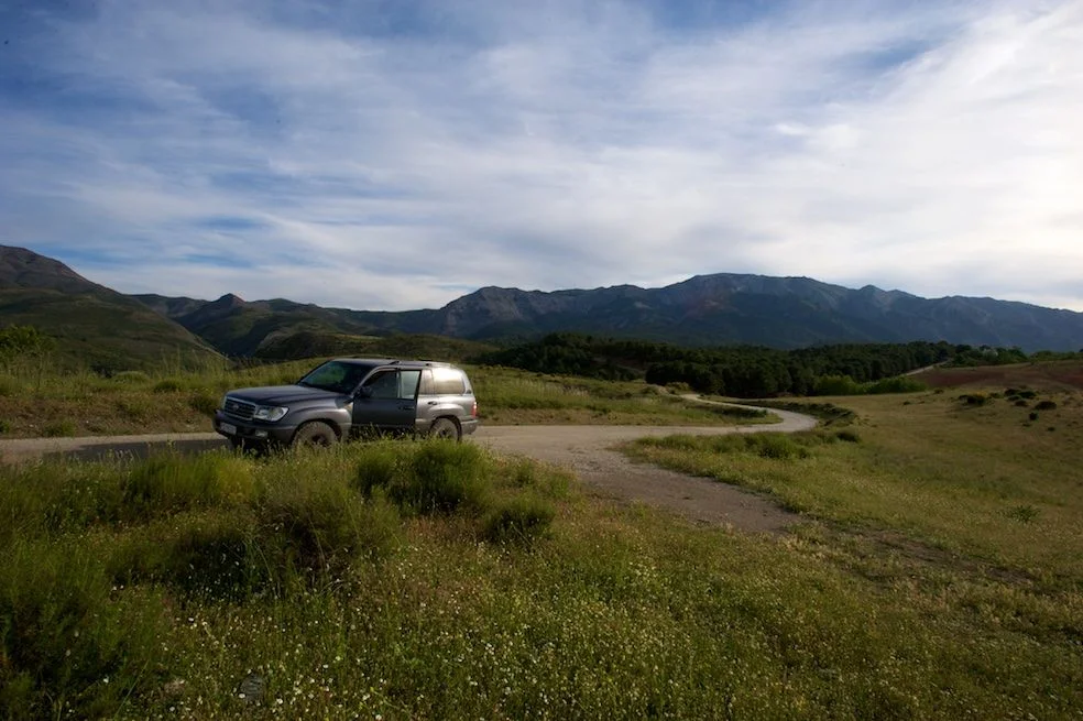

And this is my car ... :)

On a side note, where in Spain are you located? From the picture I'd guess northern Spain? Galicia, Pais Basco, Asturias perhaps?

hello nnnnnate, photo was taken in Spain, but in the south in the Sierra Nevada, during my holiday time. Thank you for the advice and informations.
